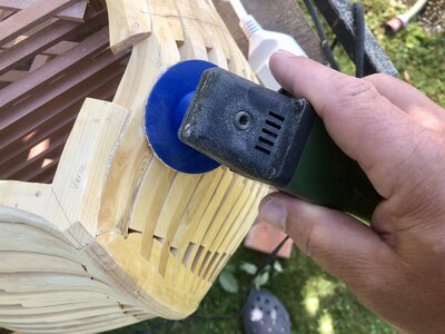

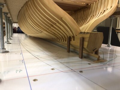

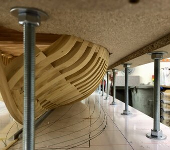

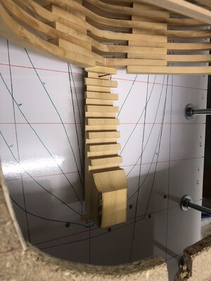

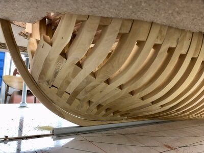

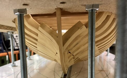

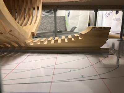

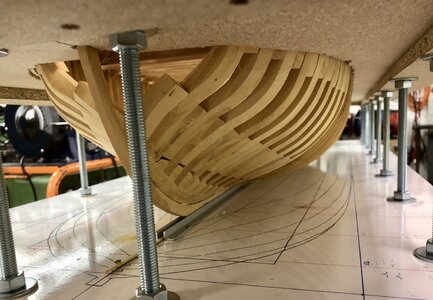

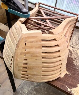

I want to give you an update on my construction progress.
The big sanding and snagging has started here are some pictures of the bow with the dead wood.
Georg, also from me, all the best for your belated birthday.
Wonderful work especially with the boxwood it looks even more impressive.

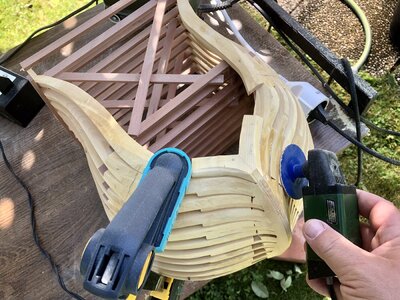

Thank you very much, now the outside is sanded.
First I sleep with 80 grit sandpaper, then various fine grit sizes up to 320. I'm still at 80 to remove the rough edges and bumps. With everything done, the inside of the fuselage comes off. After that I sleep with missing the I'm end faces of the timbers for a nice gradient. Until then, however, there will still be a lot of water flowing along the Danube
oh mistake, right now
First I sand with 80 grit sandpaper, then various fine grit sizes up to 320. I'm still at 80 to remove the rough edges and bumps. When that's all done, it's time for the inside of the hull. Then I use a file to sand the front sides of the wood for a nice finish. Until then, however, there will still be a lot of water flowing along the Danube
