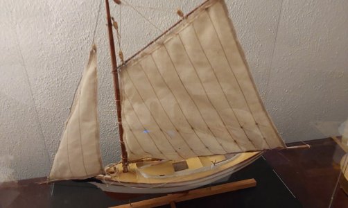

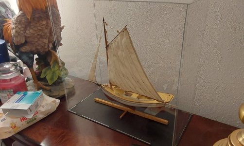

I am rebuilding a Swift pilot schooner, decided to add sails as part of the rebuild. I purchased a product recommended by a guy on utube I think it's called stiffey, he described it as basically watered down white glue it worked well on my lobster smack. I will try to post some photos as soon as I have them mounted. They need sewed onto the booms which tends to take me a while.

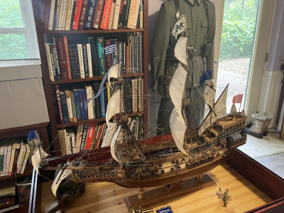

I can help with that since I make 17th century models and the sails of that period were more billowed than the flatter, 19th century sails. You start by selecting the right material. Most fabrics that are weaves have little to no stretchability. Knits have lots of flexibility, mostly in one axis, but are fuzzy and as such don't look much like sail material. T-shirts are made from fine knit material, for example.
You need a weave that has an elastic material built into it, a good example of which is stretch cotton sateen fabric. I bought some white fabric, the last two yards they had at JoAnn's Fabric store, but decided it was too bright and may not take a stain evenly, leaving bright areas, so I kept hunting for the right material. Sails are NOT white. I found the same sateen fabric on Etsy.com, but in ivory color. Perfect! It has the right amount of tan color to start with. The fabric has the same properties that Olha Batchvarov uses in her sail making techniques video. It has no stretch in one direction, but has a little stretch in the perpendicular direction. The fabric is 97% cotton and 3% spandex, and has a fairly tight weave. With the stretchy direction laid in the horizontal direction, you make your sails. After making the sails on the sewing machine, stitch on the bolt rope and form cringles, the sails need to be stretched on a stretching jig while wet with starch, and allowed to dry in the billowed shape that you want. The feel like stiff parchment and hold their shape. Here are detailed instructions on how I made custom sails: Link
Here is the final result.
