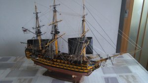

hello friends, I'll bring you my "Nuestra Señora de la Santisima Trinidad" also known as the Escorial de los mares, slightly modified from the building plans, this is my second model shipbuilding (the first was the HMS Victory) I hope you like my St enough to stand here among all those other.the first photo is one of my finished HMS Victory (january 2018) my ST I started on 15 February 2018

Hallo and a warm welcome here on board,
If a modeler starts with ship building with the Victory, and finalized it in the quality like you did, the building log of the Santisima Trinidad will be definitely a very interesting one.
Especially when we see already the starting photos which are showing the work of an experienced ship builder. You learned a lot on the Victory. I will follow your log with big interest.

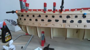

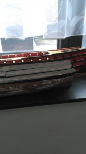

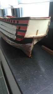

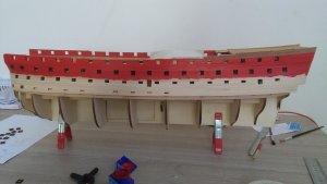

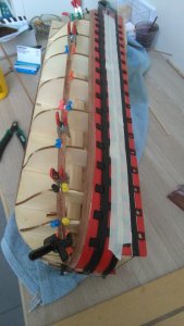

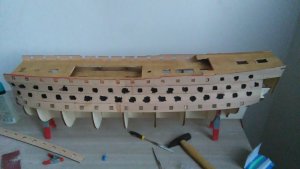

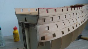

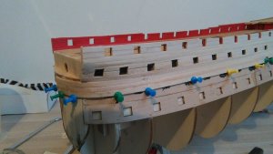

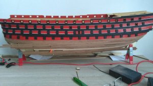

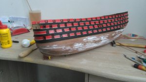

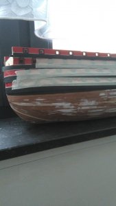

good morning Uwek, as she is on the last picture is how the progress is on the backboard side of the ship, on the starboard side I'm working on the planking and cutting of the gun holes but unfortunately had to stop me, because I've run into a problem with my right elbow (went to the hairdresser on Monday and this is not the best friend of hers and she wanted to run away, but the little creature has so much power and che twisted my elbow) so the only thing I can do now is work to finish the main deck.
to your other questions
the santisima has a single planking
I will place the cannons at a later stage because I still have too much to put the ship on its side for the planking.
ps. Uwek if you or someone else has a constructive critic during the building of the ST please let me know, because according to me this is the only way to become a good model builders I think
kind regards from Ostend
DJ

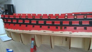

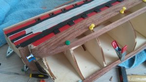

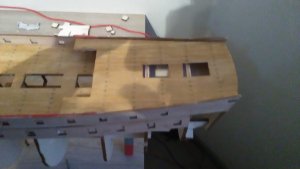

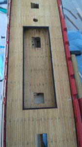

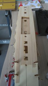

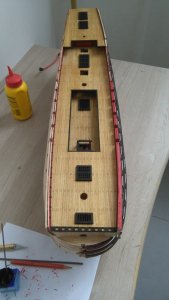

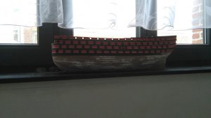

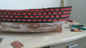

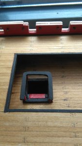

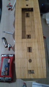

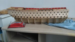

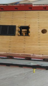

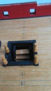

Good evening all here a small update of my ST, I'm almost done with one side of the hull, now a little bit finished with sandpaper and he's ready to paint.
Have also been a little busy at the upper deck with some things to finish, hopefully it is a bit to your liking and so as always leave your critics and coments behind, I will receive them with great appreciation.
greetings from Ostend
DJ
IMG_20180327_160404.jpgIMG_20180327_160433.jpgIMG_20180327_183343 (1).jpgIMG_20180324_122609.jpgIMG_20180327_181009.jpgIMG_20180327_181059.jpg

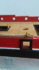

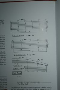

So I hope your elbow is better, and your dog accepted the first shock with the new haircut.
Very good progress you are showing us. The deck planking looks realy good, also with the treenails you made. The pattern of nails would be a little bit different, but it is not easy to show this in this scale of your Model. There would be not only at the ending of each plank nails but also in the middle. I have to check my books showing a correct pattern. Maybe for the next model.
And if it is allowed to say.....I would be careful with the use of the red paint, if you want to make it historical correct. But maybe the Spanish did this on the ST. The inside of the bulkheads / railing were red painted, yes, especially not to see the blood during action. But I do not know if they f.e. painted the gratings and ladders red, due to the fact, that paint was expensive.
It is looking good, no question. But maybe it was like this.....some historic knowledge about the Spanish Armada here in the forum? I would be happy to learn something about this.....

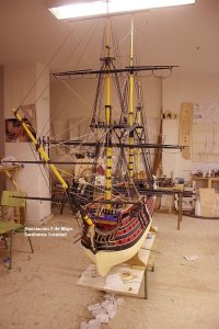

» Imágenes del navío Santísima Trinidad.
1
3
4
5
6
7
8
9
10
11
12
De arriba a abajo:
1.- Navío "Santísima Trinidad " de 140 cañones. Dibujo de Berenguer.
3.- El "Santísima Trinidad" navegando con una escuadra española. Pintura de Carlos Parrilla.
4.- El "descanso del coloso", El Trinidad anclado plácidamente. Pintura de Carlos Parrilla.
5.- El "Santísima Trinidad" pintado por el británico Geoff Hunt. De la web Art Contact.
6.- El "Santísima Trinidad" en un grabado de Berlinguero. Foto Museo Naval de Madrid.
7-8.- Las dos siguientes imágenes corresponden a una composición realizada por Luis M. Martínez. La primera con los colores atribuídos desde que se le corrió la cuarta batería y cuya única referencia es un comentario de un tripulante inglés durante la batalla de Trafalgar. La segunda imágen es la misma, pero con los colores teóricamente reglamentarios, con las franjas de las baterías en amarillo.
9.- Dibujo del Trinidad, de elaboración propia, con los colores reglamentarios con los que asistió a la batalla de San Vicente.
10.- Dibujo del Trinidad, de elaboración propia, con los colores que se supone llevaba en la batalla de Trafalgar.
11.- Dibujo del Santísima Trinidad en su fase de proyecto, de Berenguer. Este dibujo es igual que el modelo del Museo Naval de Madrid (MNM n.° 546) y que era el modelo presentado antes de iniciar su construcción.
12.- Plano del Santísima Trinidad en la época de Trafalgar. Realizado por Carlos Parrilla con motivo de un estudio sobre este navío.

hello Uwek, regarding too much red I think you're right, I have a bit of looking around on the internet and found it at "Todo a Babor" photo 7 and 8 show the ST with the gratings in black (although it is not is completely clear), I will wait a bit and ask around Spanish colegas, and if I do not find anything clearer, I will do the gratings in black.

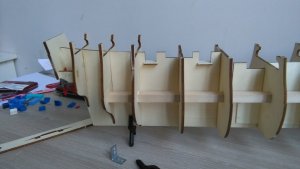

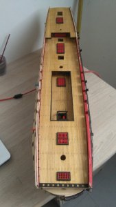

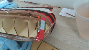

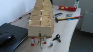

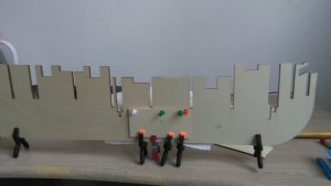

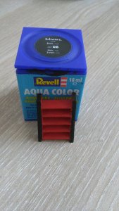

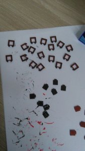

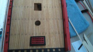

hello everyone, today I have been able to work on the ST, during the week I am busy decorating the new apartment, as you can see in the photos I started with the planking of the starboard side of the ship, and I also worked a bit on the deck, the last photos are from the waterline that I have aligned on the port side
the last picture is of the device that I use to bend the shelves (purchased from Lidl for 8 € and must say it does its job well)
greetings from OoIMG_20180414_114233.jpgIMG_20180414_155027.jpgIMG_20180414_155047.jpgIMG_20180414_173040.jpgIMG_20180414_172405.jpgIMG_20180414_172640.jpgIMG_20180414_175651.jpgIMG_20180414_184357.jpgIMG_20180414_184411.jpgIMG_20180414_184441.jpgIMG_20180414_214625.jpgstende

Very good progress you made in the meantime, especially during this time of moving.....
The black gratings arevlooking much better I have to say. I think it was a good decision to change the colour.
