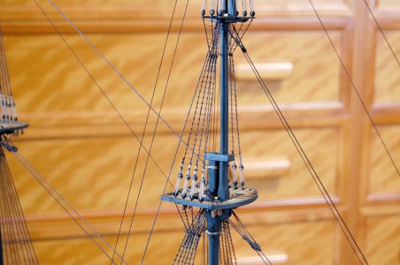

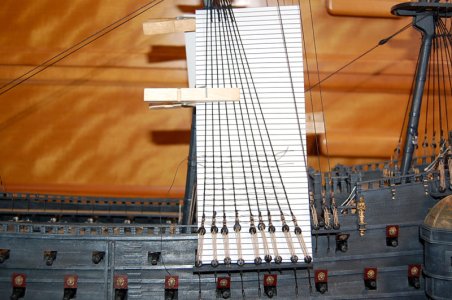

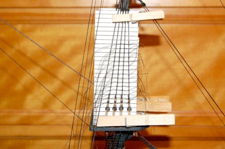

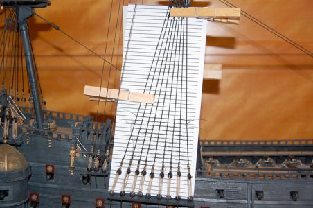

I started stretching the ratlines on the main lower mast shrouds. This is the port side and the starboard side at the same time.
This is the starboard side.
I've stretched up to 13 steps, but my eyes are getting tired.Redface
This is the port side. This one is also strung up to 13 steps.
When will this ratline be finished?
I don't feel like I've made any progress even though I've finished one step.
I'll be stretching the ratline in July.
I hope the ratline will be finished in July. ......:rolleyes:

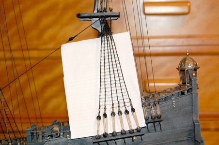

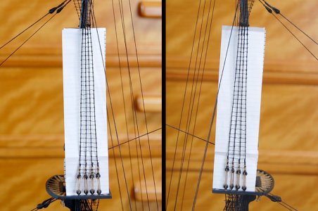

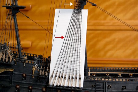

The starboard side ratline (red arrow) has been completed.
The ratlines have also been completed on the footock shroud (white arrow).Speechless

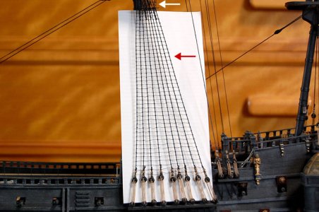

This is the port side ratline (red arrow).
It's hard to see, but the white arrow indicates that the footock shrouds are also finished.
The next step is the ratlines on the fore-row mast shrouds.:oops:

A ratline rope is a rope that only needs to support one person.
The thickness of the ratline on the Victory in the UK is about 12.1mm....so 1/98th that's about 0.12mm....I'm not sure if that's a good thing or not, but it's a good thing.:oops:
The model of the Silent Mary uses a thin sewing thread of about 0.1 mm.
If the ratline is too thick, it will look too toy-like, so I use the thinnest thread possible.;)

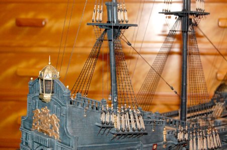

We managed to finish the ratline tensioning on the starboard side of the foreroar mast.
The footock shroud area is also finished with ratlines.
This is the port side ratline tensioning of the foredeck mast, which we managed to finish.
And the footock shroud section is also finished with ratlines.

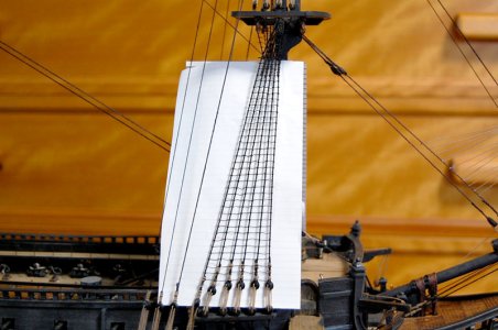

This is an image from diagonally forward to starboard, with the white paper removed.
Ratlines, thin and hard to see, but that's about it.
The ratline only needs to support one person, so a thin thread is sufficient.
If the ratline is too thick, it will not look good, so we use the thinnest possible thread, about 0.1 mm in diameter, for the sewing thread.

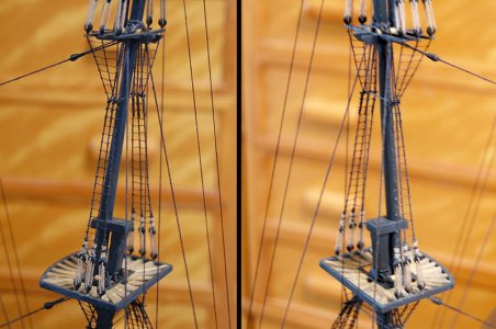

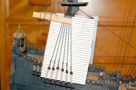

I managed to get the ratline tensioning done on the starboard side of the mizzen lower mast.
There were days when I was too tired from work to do it, though. I guess you can do it if you keep at it.

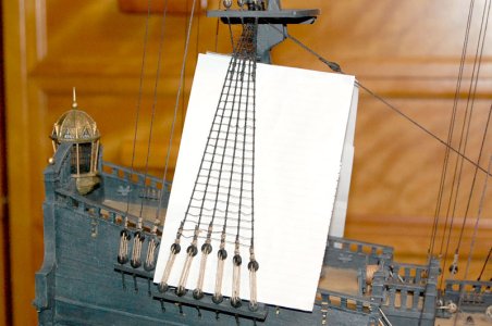

This is the ratline tensioning on the port side of the mizzen lower mast.
We managed to do this one as well.
This is what it looks like when the white paper is removed and photographed.

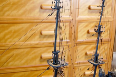

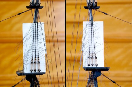

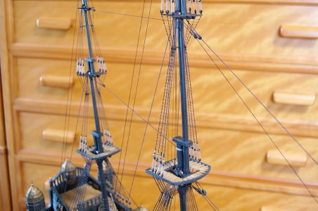

The rat lines on both sides of the main topmast have been completed.
This is an image taken from the upper right side after removing the blank paper.
This is an image taken from the upper left side.

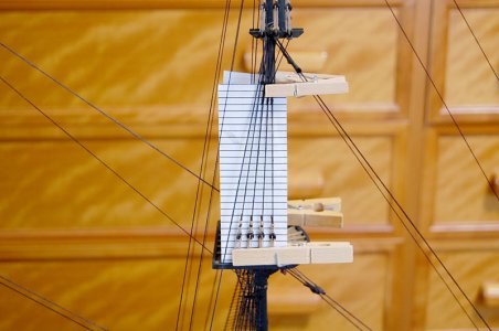

Preparing to rig the ratlines on the foremast.
This is a picture of me working hard to set up the rat line.
This image shows the rat lines on the foremast after they have been stretched and the preparation paper removed.

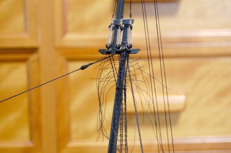

This image shows the rat lines on the left and right sides of the Mizunto topmast being stretched.
After this, the excess thread was cut off.
I cut off the excess thread from the ratline stretched across the Mizunto topmast shroud.
I stretched the ratline across the futok shroud.
I cut the excess thread from the ratlines stretched across the port and starboard frotch shrouds, and finished stretching the ratlines on each topmast.
