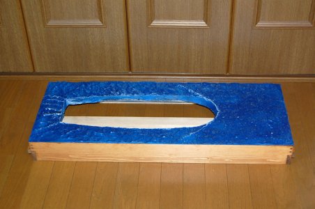

The weather was good, so the light clay hardened nicely.
Then I applied gesso and spray-painted it a sea-like color.
I immediately floated the Silent Mary on the sea.
Well, that's about it.
The sea is pretty poorly made.
The main focus is on the Silent Mary, so the sea is just adequate.

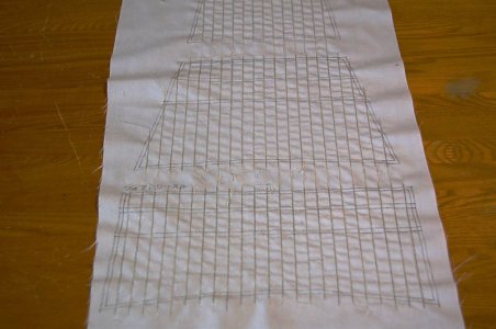

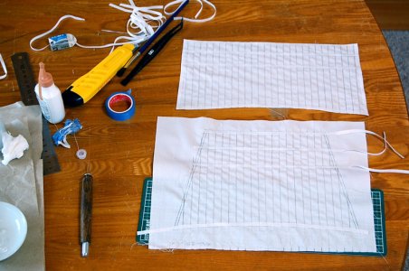

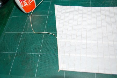

The vertical lines of the sail have been sewn together, so we can start making the sail.
We are attaching the lining (reinforcing fabric) with craft glue.
We are also attaching the band line cross (reinforcing fabric).

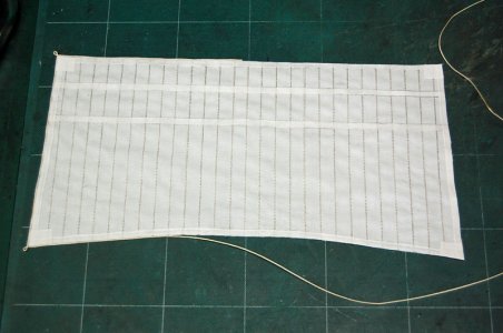

This image shows the lining (reinforcing fabric), banding line cross (reinforcing fabric), and reinforcing fabric at the four corners being attached, and the bolt rope being glued with craft glue.
This image also shows the bolt rope being bonded.

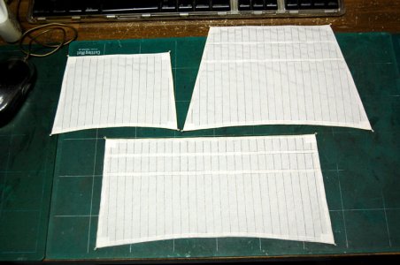

For now, I have made the main lower sail, main top sail, and main top gallant sail.
I will experiment with hardening them with clear lacquer spray.:)

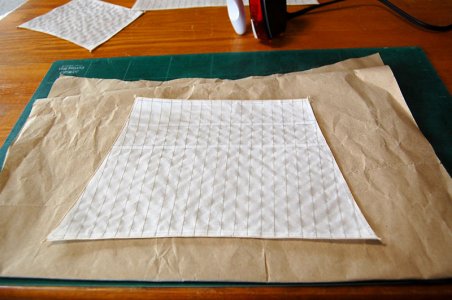

When I sew vertical lines with a sewing machine, it creates fine wrinkles.
I want to fix this somehow.
I'll try using clear lacquer spray.
I'm shooting with a strobe, so the wrinkles and bumps are flying off white.

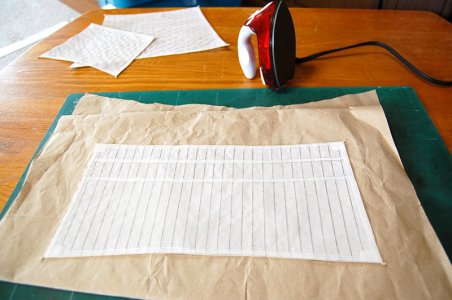

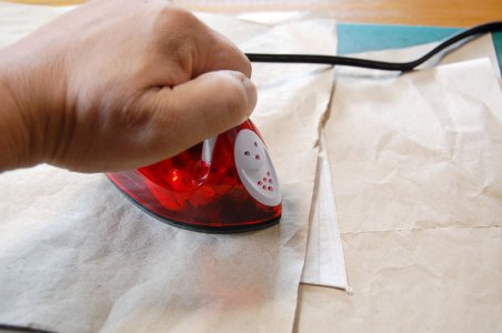

This is the main top gallant. It is wrinkled and bumpy like this.
Spray it with clear lacquer spray and let it dry.
Repeat this two or three times, and once the clear lacquer spray has dried and hardened...
Place the main top gallant sail between two sheets of Construction paper and iron it.
Surprisingly, the wrinkles and bumps disappeared.
I had predicted that this would eliminate the wrinkles, but I wasn't sure.
So, I decided to try it out.
It worked.

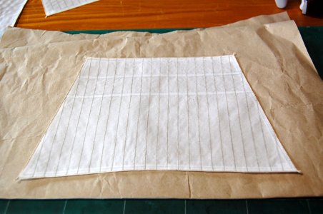

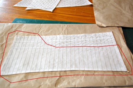

This is the main top.
This is also wrinkled and bumpy, but if you put it between two sheets of paper and iron it...
As you can see, the wrinkles and bumps disappeared as if by magic.

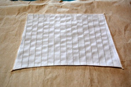

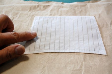

This is the main lower part.
The red line indicates where I ironed it.
The unevenness is gone.
I ironed the entire main lower surface.
The unevenness disappeared.
It worked.
