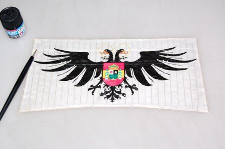

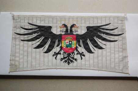

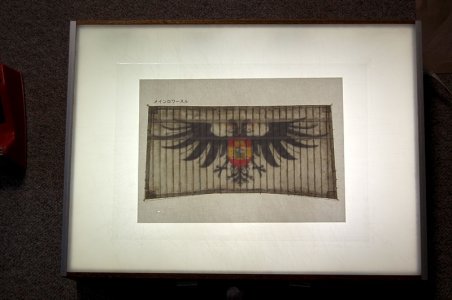

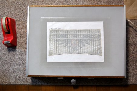

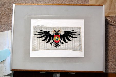

To transfer the decal onto the front side of the sail, place the illustration on the light table, lay the transparent film over it, and secure it with tape.
Place the main lower sail with its weathered paint finish on top.
When held up to the light, an illustration of a double-headed eagle appears.
This shows where to apply the decal.

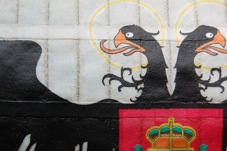

Soak the decal in water and wait for it to separate from the backing paper.
If the decal starts to peel off the backing sheet, quickly transfer it to the sail.

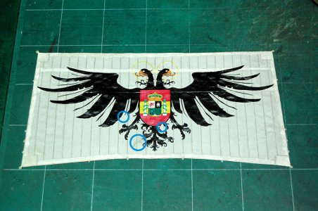

While cutting and peeling off the transparent varnish part of the decal with a design knife... the decal in the blue circle area shattered.
I corrected it using Tamiya lacquer paint (matte black).
The decals and retouched areas are completely dry, so I sprayed them with matte clear lacquer to eliminate the decals' gloss.
The front side of the main lower sail is now complete.

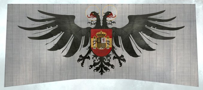

This is a concept illustration of the sail published online.
I believe this is the back side of the sail.
Please look at the illustration below.
The patch section on the belly is the same.
If you flip the patch section left to right, it becomes the illustration of the sail's front side.
This concept art has a shallow waterline.

To apply decals to canvas, I thought the fabric surface needed some kind of treatment, so I sprayed it with clear lacquer.
This must have worked because the decal adhered.
After applying the decal to the sail, I immediately pressed it down with a steamed towel.
The decal settled nicely onto the canvas.
After the decal dried, I applied Tamiya Decal Adhesive (with softener) to the decal's surface, pressed it again with a steamed towel, and let it dry.
Then I retouched any areas where the decal had cracked and sprayed it with matte clear lacquer.
Somehow, I managed to successfully apply the decal.:D

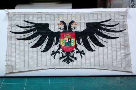

Apply the decal to the back side as well.
After applying the decal to the front side, spraying flat clear coat, and letting it dry, I also applied the decal to the back side of the sail.
I was relieved it applied without any issues.
I managed to position it exactly the same as the front.
I've included an image of the front below, so please compare them.
This is the front side.
I've included it so you can compare it to the back side.

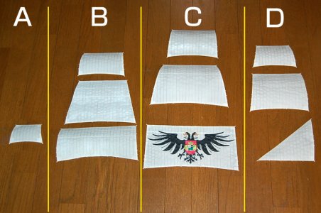

I worked on finishing the sail in August, and somehow managed to get it done.
I confirmed the sail names by checking the book ‘Sailing Ship Models - Construction Techniques’.
A: Split topsail
B: From top: Fore Top Gallant Sail
      Fore Top Sail
     Fore Sail
C: From top: Main Top Gallant Sail
     Main Top Sail
     Main Sail
D: From top: Mizzen Top Gallant Sail
     Mizzen Top Sail
     Lateen Sail
Sorry if any names are incorrect.

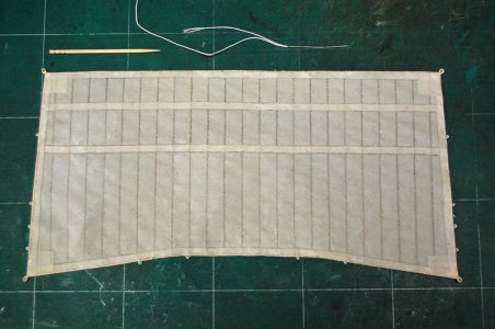

I'll add the reef points next.

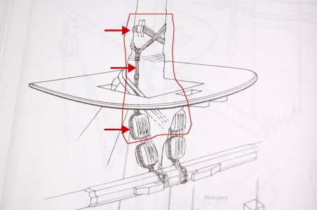

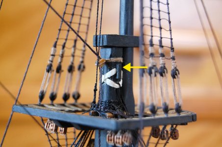

I'll try making the part outlined in red on Jeers' drawing.
It probably won't turn out exactly like this illustration, but I'll craft something similar.

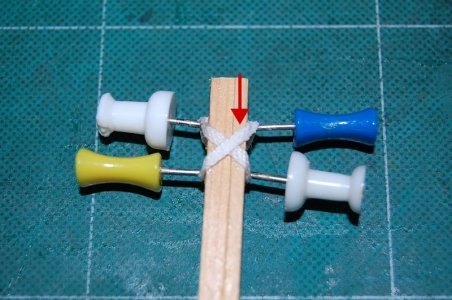

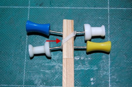

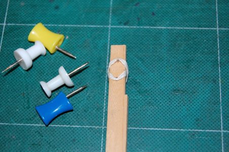

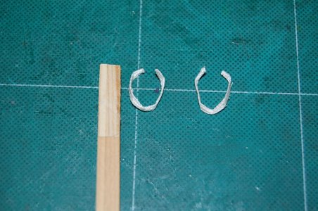

Prepare a rod of the same thickness as the mast's jeers section.
Insert four pins, wrap the rope like this, apply wood glue (white glue), and let it harden.
Once the wood glue on the previously wrapped rope has dried, wrap the rope like this and secure it with wood glue.
Make sure it doesn't stick to the rope below.
Once the coiled rope has hardened, remove the four pins.

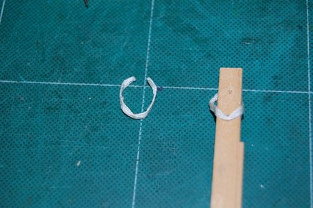

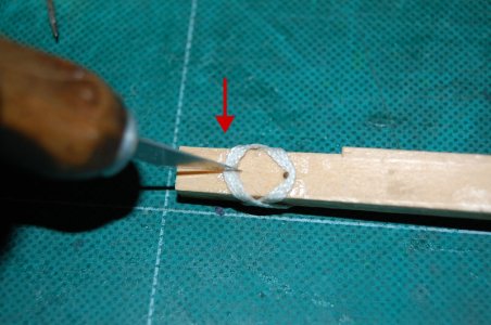

Cut along the red arrow.
Carefully peel off the tightly wound rope.
Cut and peel off the other side as well.

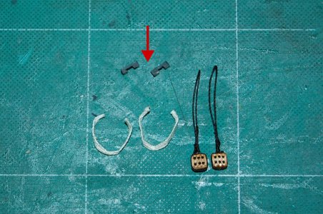

The part marked with the red arrow was machined from a 2×2mm square rod and painted German Gray.
All parts are now ready.
These will be attached to the mast.

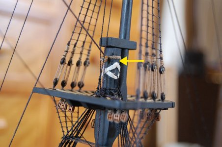

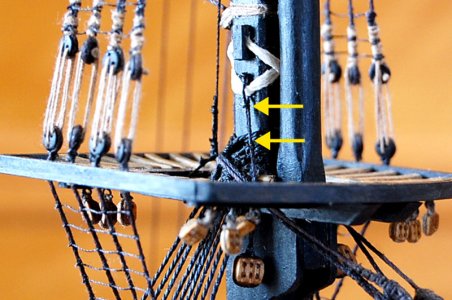

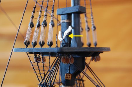

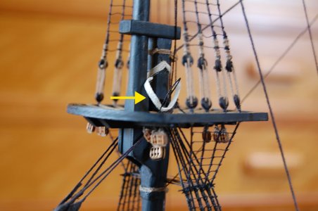

Set the rope section of the triple block and tackle to the foremast...
Set the tightened rope as shown by the yellow arrow.
Neatly attach the rope stiffened with wood glue.
Attach the other side to the mast as shown by the yellow arrow.
Apply wood glue evenly to the top of the hardened rope on the opposite side and attach it to the mast.

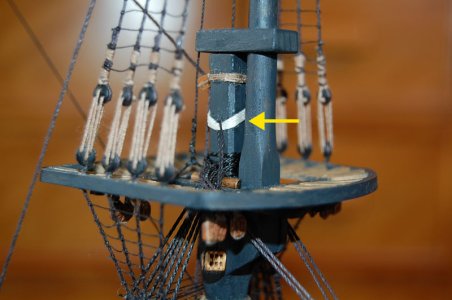

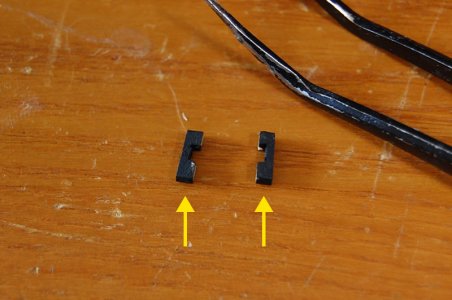

This is where this part comes into play.
Apply adhesive to the arrowed areas and attach the parts.
Check that the parts are attached in the correct positions.
Finally, tie the rope sections of the triple pulley at the two yellow arrows with thin thread.
The foremast jeers are complete.

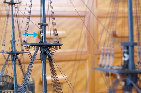

I worked on the jib section of the mainmast in the same way. (blue arrow section)

Since I want to put the double-headed eagle illustration on both sides of the sail, I didn't use iron-on decals.
In that case, I decided decals would be easier to handle.

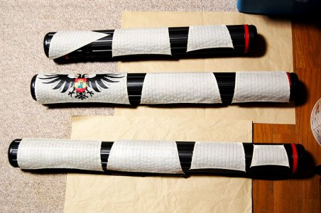

To protect the decals, I sprayed a matte clear coat onto the sail surface and wrapped it around a tube to dry (see photo).
I plan to observe it in this state for about a month.
No cracking has occurred on the decals at this point.

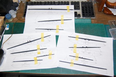

Each yard is currently painted in German Grey, and work is temporarily paused at that stage (see photo).
This month (September), I plan to proceed with installing footropes and blocks on the yards. I aim to complete all yard-related work by the end of September. :)

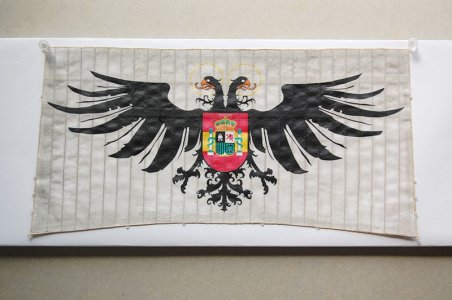

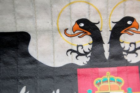

Hey, GIG1810.
I know you were wondering if the decals were adhering well to the sails,
so I'm attaching close-up photos of the decals applied to the sails.
I think the decals are adhering quite well. :)
Image of the sail's front side
Image of the sail's back side

Hey Mellpapa,
That looks really nice. Thumbsup
Thanks to the plasticiser, the sticker has moulded itself well into the sail. Really very nice and top work. I had to smile when I chose your coat of arms as mine is almost identical. Here is a picture of the city of Cologne in Germany ...
