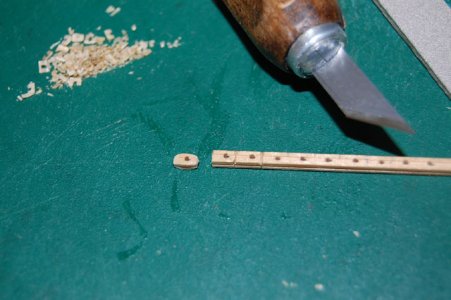

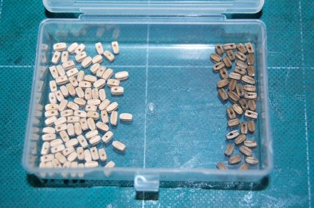

I will carve grooves into all four sides of a 2×2×900mm cypress board, drill holes, and shape each piece individually to create it.
Shape it like this, then sand it down...
Cut out the shaped pulleys.
I'll make a whole bunch of these by repeating this process.
The pale pulley on the left is the newly made pulley.
I made about 88 of them.
The brown-stained pulleys on the left are stock pulleys, and there are about 40 of them.

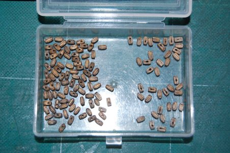

The newly made single pulleys were stained with dark walnut wood oil.
Combined with the old ones, I now have 128 single pulleys.
This should be enough... if not, I'll just make more.

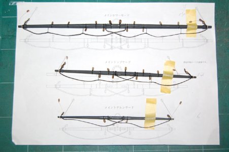

This image shows the pulleys installed on each yard of the foremast and the pulley set on the split-top yard.
These are the yard components of the main mast.

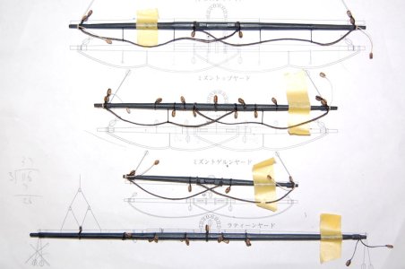

Image showing the pulleys installed on each yard of the mizzen mast.

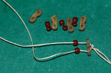

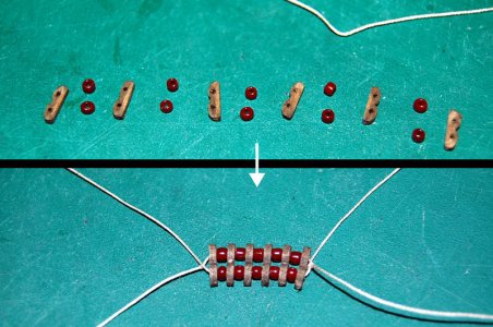

■Making Parral■

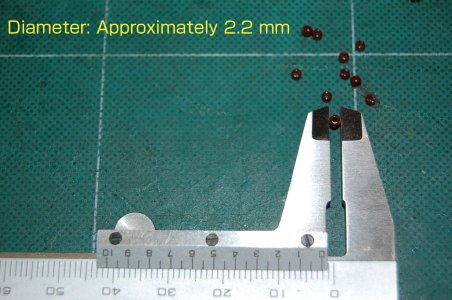

I once found and bought the smallest beads at Daiso's craft section.
I'll use them for the Parral truck.
I've also used them on 1/72 scale Black Pearls and Flying Dutchmen.
Since they're brown, I can use them as-is without painting.
Measured with calipers, they were about 1.8mm. I don't know if this size will fit the Silent Mary's Parral, but I'll build the Parral anyway.

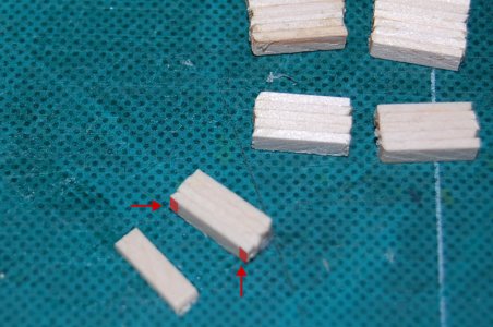

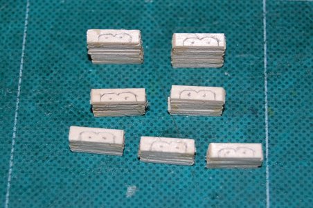

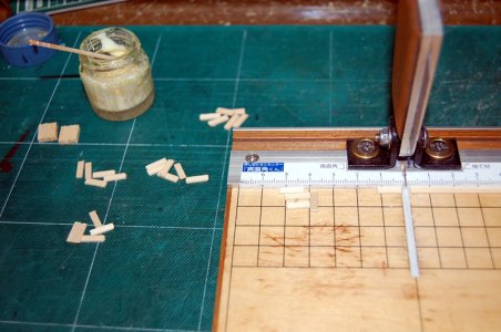

Cut the parral rib material. The material is 1mm thick, 3mm wide cypress wood.
Cut it into 1cm lengths using a chopper.
Apply Titebond adhesive to the arrow-marked sections of each cypress piece used for each mast, especially the red areas, and attach them.

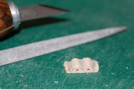

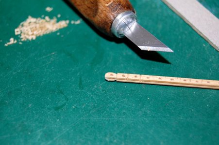

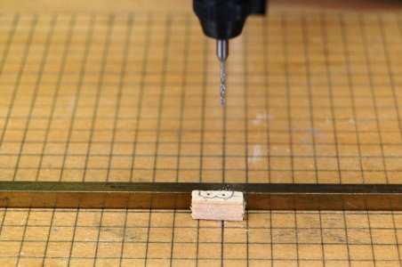

Draw a rib pattern on the topmost layer of laminated cypress used for each mast.
Drill two holes in the rib drawing.

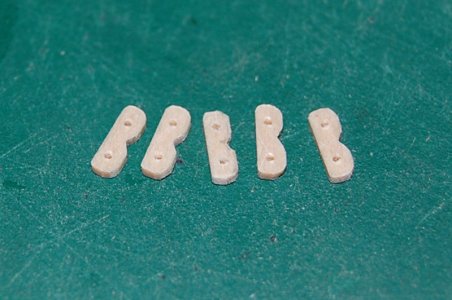

Shave it down as shown in the rib diagram.
Cut the adhesive portion and finish it with sandpaper.
Once separated, the ribs will be ready.

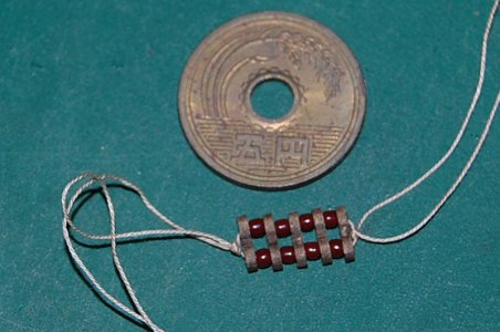

If they cannot be peeled off with adhesive, soaking them in water will cause them to loosen naturally.

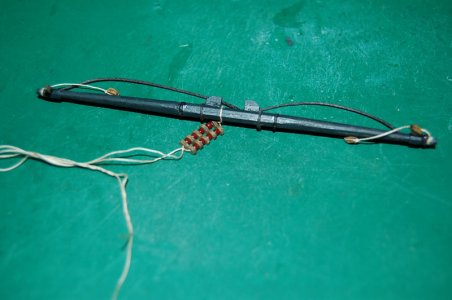

The ribs are stained with rich walnut oil, and beads resembling trucks are used to create the parral.
The parral is complete.
This parral will be used for the mizzen Top Gallant Yard.
I installed it on the mizzen top Gallant Yard.

Carving the rib that looks like the letter B took about an hour.

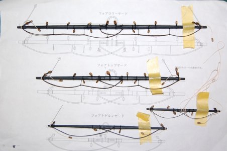

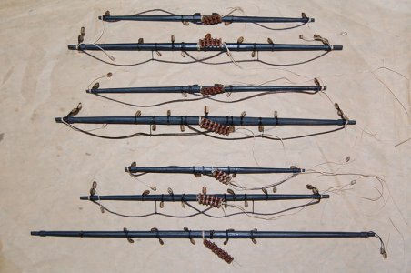

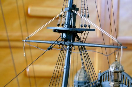

The yard parrels are ready, so I attached one side to each yard.
The names of each yard are listed from top to bottom.
Fore top gallant yard
Fore top yard
Main top gallant yard
Main top yard
Mizzen top gallant yard
Mizzen top yard
Lateen yard
Since the cross jack has no sail, I mounted it on the mizzenmast.
I attached a pulley to the mizzenmast cap to lift the cross jack, hoisted it with a lift rope, secured it with a slings, and fixed it to the mizzenmast with a truss.

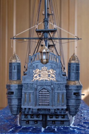

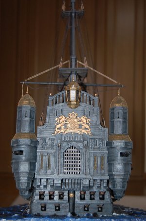

I attached the cross jack, so I tried taking a shot from the stern.
Pretty good, don't you think? Feeling pretty pleased with myself.

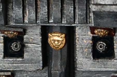

I need to add a lion's face to the rudder section...
That's the part with the red arrow in the image below.
I haven't made the lion's face yet, so I'll make it next.
If I don't make it when I remember, I'll forget about it.

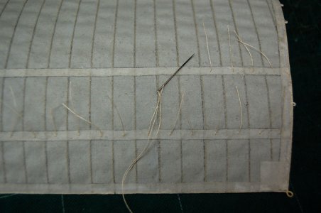

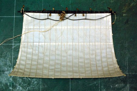

I've added Reef pointst to the Mizzen Top Sale. Since I used thread similar in color to the sail, they don't stand out.
It's fine if you can just sort of tell the Reef points are there, even if they're not noticeable.
In the movie, I couldn't tell at all whether the Reef points were there or not.
So for me, it's best if it's hard to tell whether the Reef points are there or not.

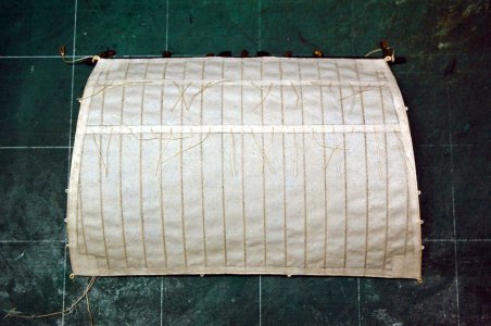

I attached the Reef points, so I tried putting a sail on the Mizzen Top Yard.
This is the front side.
The sail is blown white, so it's hard to see the Reef points clearly.
This is the reverse side.
You can clearly see the mizzen top yard here. The Reef points blend in with the sail's color, so they don't stand out. Or rather, they're hard to make out.

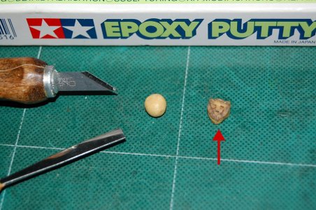

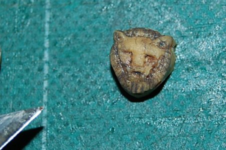

I tried making a lion's face using Tamiya's epoxy putty (fast-curing type).
Please look at the part marked with the red arrow.
What do you think? Does it look like a lion's face??
I zoomed in on the red arrow area.
It sort of looks like a lion's face, so this should be fine.
I can't make it any better than this.
After leaving it overnight to dry completely, I'll apply olive drab as the base coat and finish with gold dry brushing.

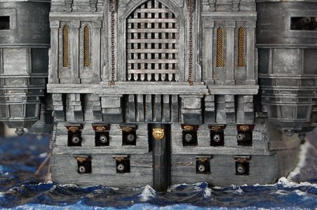

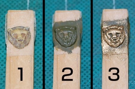

■Lion Face Painting■
1
Shave the back of the lion face to thin it, then attach it to the wood with double-sided tape to prepare for painting.
2
Apply olive drab as the base coat.
3
Dry brush gold to make the lion face stand out.

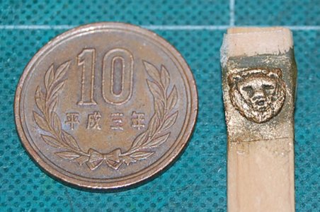

I compared the lion's face to a 10-yen coin.
Can you tell how big the lion's face is?
Measured with calipers: width approx. 6.8mm, height approx. 7.2mm.
The paint dried, so I glued it to the rudder.
Took a shot from the stern.
Maybe it's a bit small??
But I think this size is fine.
I'm totally satisfied with myself.
Zoomed in. This is about right, right?
Zooming in even further...
It exposed all sorts of rough spots. :eek:
I thought about deleting this image, but I'll leave it up.
This is the level of my craftsmanship.
It's nothing to brag about.ROTF
Fore top yard
Main top yard
Mizzen top yard
Lateen yard
I've added reef point to the Mizzen Top Sale. Since I used thread similar in color to the sail, they don't stand out.
It's fine if you can just sort of tell the leaf points are there, even if they're not noticeable.
In the movie, I couldn't tell at all whether the leaf points were there or not.
So for me, it's best if it's hard to tell whether the leaf points are there or not.
I attached the reef point, so I tried putting a sail on the Mizzen Top Yard.
The sail is blown white, so it's hard to see the reef point clearly.
You can clearly see the mizzen top yard here. The reef points blend in with the sail's color, so they don't stand out. Or rather, they're hard to make out.
Next is attaching the reef points to the mainmast topsail, but I'll take a break from that and work on the lion's face on the rudder instead.
■Create a lion face for the rudder decoration■
1
2
3

Namabiiru, hello.
You and I have the same beads.
We're in the same boat. ROTF
It seems there aren't any smaller beads than these.
Even at craft stores in Sapporo or Asahikawa, I couldn't find any smaller beads.
At that craft store, the same beads were sold for double the price.:eek:
I was a bit surprised, but I guess it's because of the difference in their suppliers.Speechless
For thread to use on the rope, if you go to the leather goods craft section at a craft store, they have lots of thread that looks like it could be used for a model sailboat.Ship-1
I don't know if these are what you have, but I just spotted on Ama$on,
Toho Round Seed Beads 15/0#222 'Dark Bronze' 8 Gram Tube​
It says they are about 1.5mm in diameter and that they string about 24 per lineal inch (1.05mm). They seem smaller than what you measured.
RussF, hello
The small beads I bought were about 2.2mm in diameter.
So there are even smaller beads than these, huh.
I immediately checked Amazon Japan and found them.
But they're currently out of stock.
I'll buy them when they're back in stock.
Thank you so much for the great information.
I'm really grateful.
