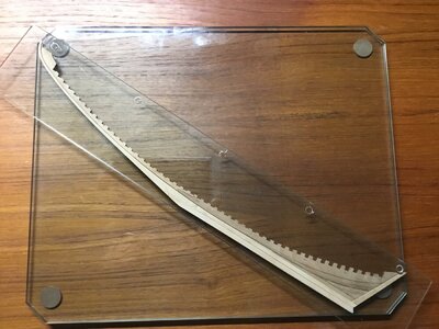

Decided to build the keel first.
A three layer sandwich.
I did the middle layer on a piece of heavy plate glass, and used a second piece to hold the keel flat.
(From a stacking table)
When dry, then added the two outer layers, still using the glass.
It came out perfectly straight.
and you can see if anything drifts.

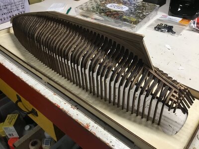

Started the ribs. 20 done so far. Find it delightful that the pieces can just be popped out of the sheets.
I have yet to bevel the edges, but the laser trace makes for a good start. I will leave the trace and a hint of the char with a final tweak with a sander after the hull is assembled.
I have found working on three ribs at a time with Titebond II premium glue on a rotating base works:
Pop the 2 center pieces, sand the connecters, glue with binder paper clips, on to next rib.
The first rib is now dry. File the notches, rib and keels, for fit. Next.
Proceed outwards with one piece at a time, always aligning with the paper template.
I have a suggestion for improving the BN kit. I have needed to file both notches in all the ribs as the inner and outer keel did nor fit. The rib slots are 4mm wide, while the inner keel is 4.2 mm thick and the outer keel sandwich is 1.1 + 2.1 + 1.1 = 4.3 to 4.4 mm. Probably not a CAD problem, rather a manufacturing issue.
To fit, the stock need to have a +0 -? tolerance if notched with another piece.

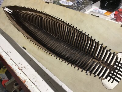

Just finished a dry assembly of the ribs. I will next disassemble it, bevel the ribs, decarbon, and fine tune the notching for consistency to the rabbet. Then fine tune the rib to rib for best graduation before glueing them to the jig.
Any good suggestions on minimizing the excess glue for best linseed oil finish?
And do you use different glues?
