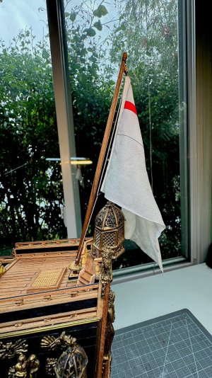

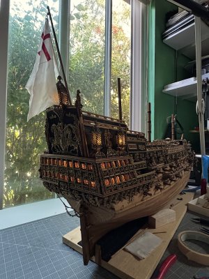

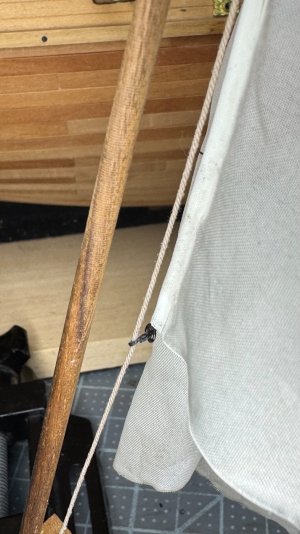

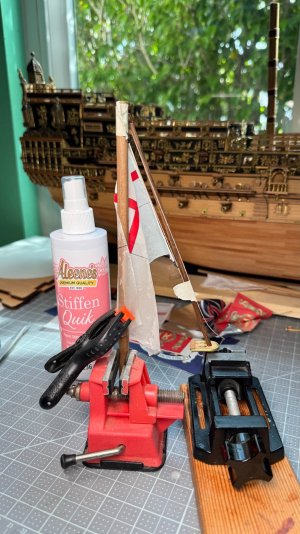

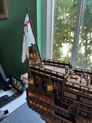

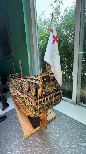

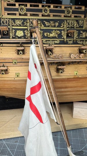

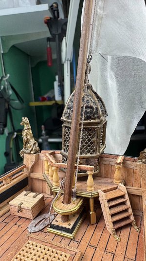

Stern flag is done. I chose the Segal kit included example. Some images.
Next up is designing a framing on which to set the ship onto its base platform.
Regards,

Wow.. the flag really looks great!
