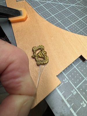

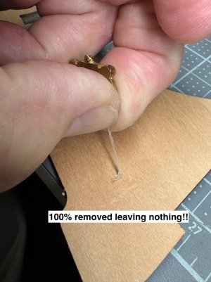

Noted - will follow up with what I have found to be the PERFECT adhesive that is ALSO totally forgiving it the metal part attached to wood needs to be
removed for any reason. It leaves absolutely on evidence behind.
I will remove one of the metal parts in order to demonstrate a good example of the glue..
PS: I have used this glue for all three of my model; Vasa, Santisima and current project.

So my friend, are you going to tell me what this wonder substance is or am I supposed to guess?
OK - Noted was working on a proper "sales pitch" :)

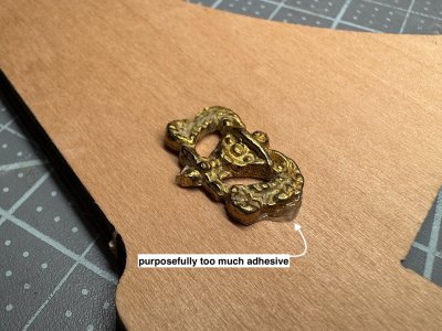

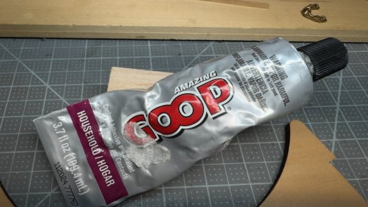

Goop -- best adhesive that I have found to be Perfect for so many applications in this hobby.
CAUTIONS
1) if you use too much Good Luck trying to later remove the part that was attached. This adhesive is super serious it holds forever…..only very little is needed. Think - if you use too much - permanent!! - and will adhere vertically in a few seconds as well - perfect - So using just a little will allow for, if needed, later part removal.
2)
also works perfectly for wood to wood - NOT for planks, but for adding bits to a deck or for attaching hull cannon door hinges to deck - Perfect adhesive. So many useful options. CA does NOT allow for any mistakes!!! and leaves scars....
3)

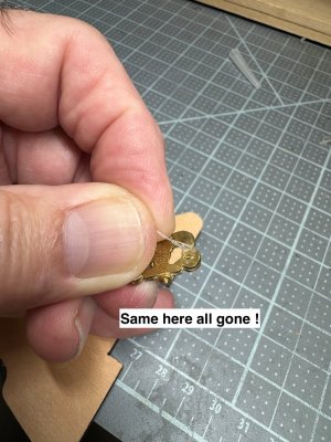

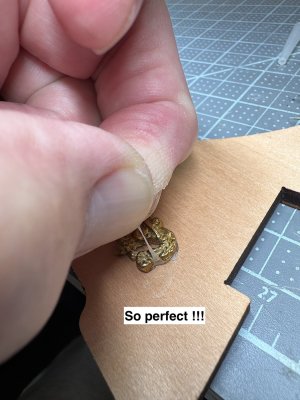

I you later need to remove a part - just slowly pull part away Goop will also remove itself as you pull part way - and as shown in images - again little needs to be used in the first place.

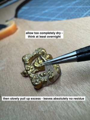

4) if you used too much and its visible - only after complete drying (think overnight) - just use Exacto knife to cut away, or just slowly pull excess away
leaves absolutely no visible residue on wood or metal.

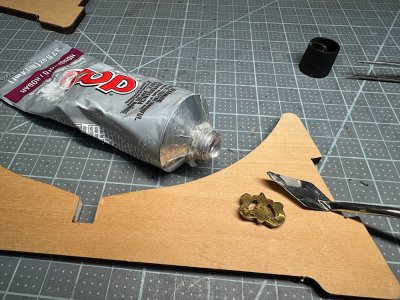

5) super messy to use - needs a small “something” for applications. See image
6) excellent for so many applications --- mostly GOODBY to CA Gel or otherwise. PS not for ropes!! PS: YES CA, and wood glue are also always my "to use" adhesives....perfect when needed.
7) Goop is the most perfect and forgiving adhesive that I have ever used -- Oh and I have used this for other purposes as well around the home.
All 600+ Sovereign decorations - All hull gun door hinges to hull, + many wood to wood bits on deck were all Goop attached.
Good luck !!
