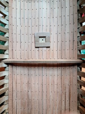

Hi Daniel,
see photo 4.014 of my model.
I made two rows of nailing.
KarlView attachment 196927
Hi Daniel!
Your deck is not sealed with tar. In the real ships, the joints are wide to bring in the sealing material. And a large part of the deck will be lined and later not be visible at all. And the nails . . . ?

Thank you Jeronimo and Thomas for stopping by and your comments. I really appreciate them and that is what I am looking from a building thread. Like Jimsky and Heinrich comments.
Let me provide an answer to both.

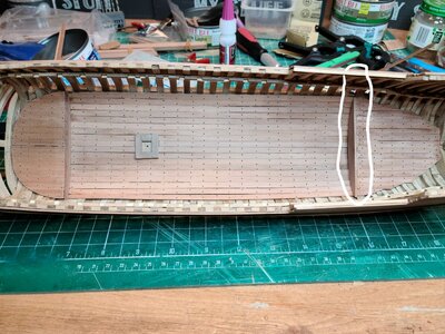

@Jeronimo.... I knew you did 2 rows of nails. I check your pictures every 5 minutes :-) . BUT !!! ... with big letters... I have an issue. When I need to do a fine detail, my hand start to shake. Very small but enough to ruin my job. If you ZOOM my posted picture (or see below picture white circle) I tried the first road of that deck with 2 nails. Looked horrible to me. I couldn't keep the distance or a straight line. I decided then to do as the Chinese modeler "1 row of nail" and for that I used a wood to help my hand (see picture below). Nevertheless, it isn't perfect, because I start to be nervous and my hand shakes more. Bottom line, I did my best.

Hi
Can someone teach me the name and what are those "extensions" (to call them in some way). See arrows in the picture.
Thanks !!!
Daniel
Hi
Thanks !!!
Daniel
Daniel, they look to me like monkey ladders (see Oliver's post https://shipsofscale.com/sosforums/...jean-boudriot-myself.3009/page-19#post-140541), not 100% sure. From the cross section, one can see that there are no ladders leading to the hold. Those that go all the way down to the keelson seem to be center positioned wrt to hatches. Those that do not, I have no idea. Jeronimo would know for sure.
