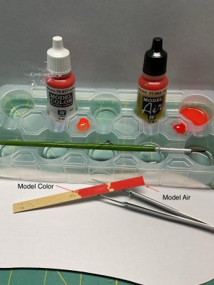

Vallejo Color/Colour red
Vic and Grant:
My notebook tells me I used Model Color scarlet #70.817 as the best match for the Model Air red #71.003
There is a very, very slight difference so I don’t combine the two colours on the same piece I’m painting. Interestingly enough the colours look different in the two bottles side by side but once laid they are very similar. To help I’ve just used both colours on a piece of scrap AYC side by side. Note: I did not use a primer for these samples. I just slapped two brushed coats on so you can see them. Don’t think it’s dry yet, :D.
See attached photo. Hope this is of some help.
Vic and Grant:

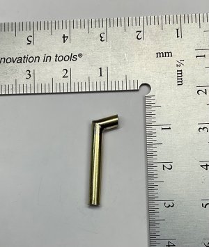

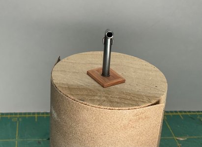

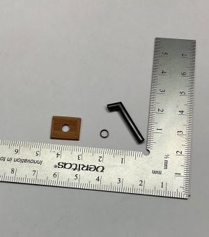

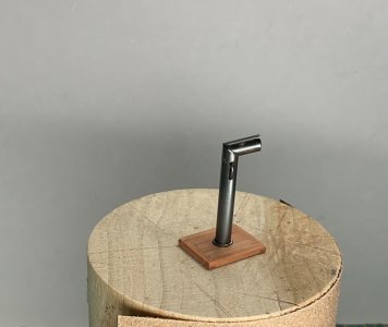

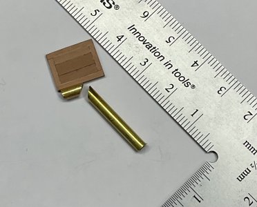

As my ability to stay at the workbench continues to be temporarily reduced I decided to work at a small achievable item. So I turned to the construction of the galley vent stack.
The manual advises using 1/8” dowel cut to length to make the stack, which sits on a raised platform. I didn’t like the look of it (see below) so decided to make one using brass tubing for the stack and brass wire for the handles. The handles shown on the plan indicate, to me, that it can be turned on and off the wind to prevent smoke being blown back into the cooking stove area. I was intrigued at how the stack was constructed in 1803 to prevent fire risk to adjoining wood structures. I also tried to find information about the sealing arrangement at the base of the stack. I had seen one solution being a steel or copper plate surrounding the stack and placed over the wooden platform. Another solution was a lining around the vent as it penetrated the platform. I elected to construct a tiny ring at the base to simulate that external lining.
I constructed the stack from brass tubing cut at a suitable angle and then silver soldered. I drilled four tiny holes in the upper tubing for handles, which I made from brass wire. I cut a suitable size brass tubing “collar” for the lining at the base of the stack. After frustrating myself to no end I then blackened the whole thing and test fitted it as shown in the accompanying photos.
Just a single item but it’s progress no matter how small. Thanks for following along.
