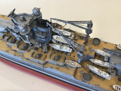

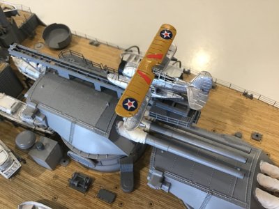

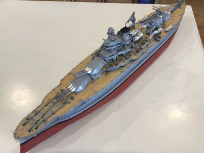

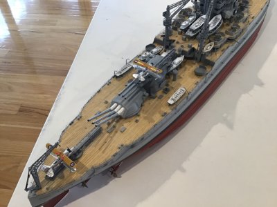

The Arizona 1/200. Trumpeter.
Another weekly update friends,
I have been working on the superstructure and fitting guns and the funnel. In addition I added the avgas fuel line to side of the ship. Currently installing the photoetch railings.
View attachment 524258View attachment 524259View attachment 524260
Hey Brian,
The speed with which you're getting through this build puts my humble efforts to shame. She's looking really good. I just have to ask, what did you use to replicate the AVGAS pipe along the port side? Particularly, what have you used as mounts/spacers along the pipeline?
Hey Brian,
Hi Steve, thank you.
With regards to the avgas line and brackets, I simply used fine brass rod for spacers . I drilled holes and glued the brass rod into the hull, then snipped them off to length . I then added the Avgas line to the tips of brass rod ( if you are following what I'm trying to say ). I used brass wire picture frame line from the local hardware store. Not sure how accurate this is, but it’s what I had laying around.
