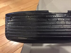

The first thing I noticed when opening the box was the "heavy handed" plate detail on the hull. Someone please talk me out of trying to "fix" that. The builds I have reviewed on this look great as far as I can tell from the photos. Wondering if anyone has tried to make the plating look better.

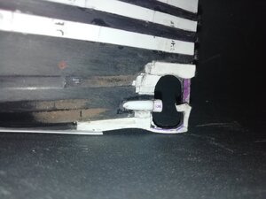

That's good to hear. I have some of the same stuff and have been experimenting with it. Did you drill out all the small port holes? Also the instructions say to "open the hawse pipes with a small file". Do they mean to cut out the area inside that raised oval? I haven't been able to find any photos clearly showing that area. thanks
Yes, I drilled out all of the port holes. I drilled out the hawse pipe holes in the center (use a punch so your drill bit doesn't wander) then filed them to size. I used my model files, a half round did the job.

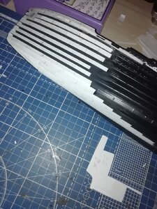

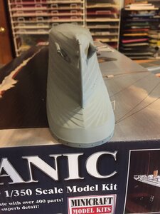

I've been experimenting with "glass" for port holes. I tried Model Master Window Maker but am not satisfied with the results. It dries clear but not smooth. I had much better results with Elmer's glue. It levels out nicely. It is more opaque but adding some "Future" over it made it nice and shiny. Since I am not planning to add lighting that should not be an issue ( I don't think it would be an issue anyway since there is no interior detail to see). I drilled out the large port holes on the port side. I will fill those with the Elmers/Future combo. I plan to just use Future on the starboard side. I left all the small port holes intact and will treat them with Future only. I will post photo(s) once I get the hull painted. So far it is just primer.

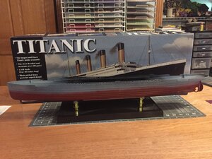

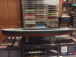

I finally got the hull painted except for the sheer stripe. I painted the antifouling section a "mineral red" and the mid area is a mixture of flat black and gun metal. The upper part is a semi-gloss white. The kit supplies decals for the sheer stripe but I can't imagine trying to apply then over those two rows of rivets. I will try painting first.hull.JPGpainted hull.JPG
