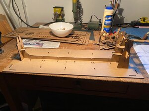

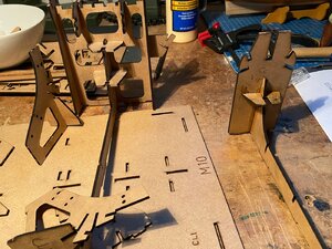

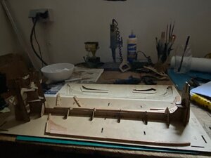

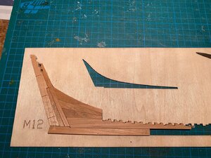

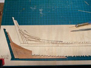

Ok, then quickly back to my pictures:

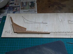

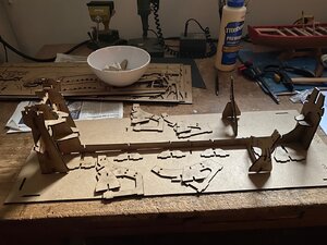

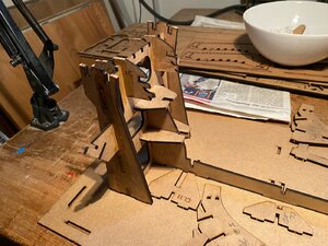

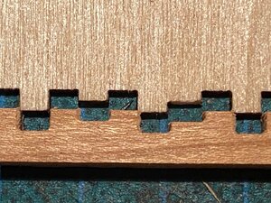

The single parts are just plugged in. The bow- and stern-section is already glued, but I will edit the baseplate again before gluing the two parts together. I try to widen the cut-outs a little bit, so that I don't have to use excessive force when completing the parts later.
Here now the pictures:

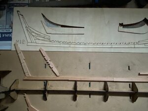

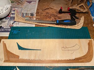

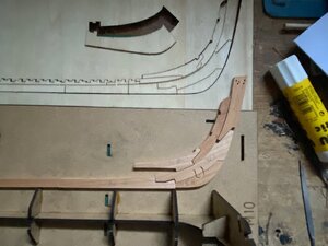

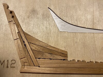

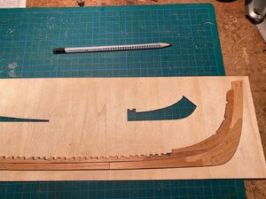

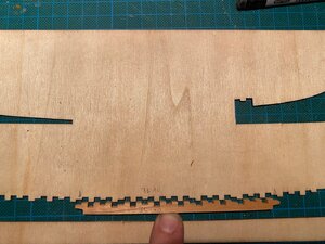

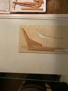

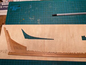

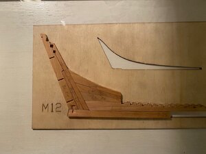

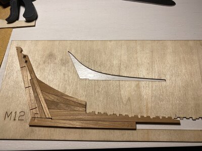

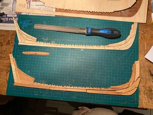

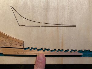

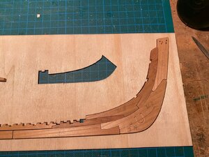

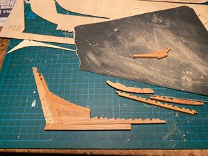

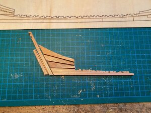

The next 3 pictures show the complete components of the keel. At first only roughly cut out, afterwards already roughly cleaned. Meanwhile they fit into the mould, but I will have to rework them quite a bit.
Next I will finish the stern part and then glue it together

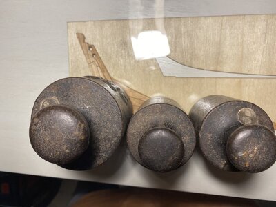

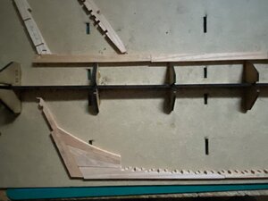

Hello, If parts are tight & snug fit in the template, use it. This will ensure alignment. You can still use clamps along with the template. But make sure you are using the glass or in your case is a tile to lay down the parts inside the template. ;)
