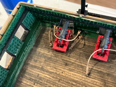

Welcome back to your Conney. I had to slow down too and think a lot about continuing when I got to the carronade rigging.- a very tedious and “tiny” job. Tried using Bluejacket’s metal blocks and it looked bad, so now I’m using Syren’s 3-D printed 3/32 blocks and their 3 mm hooks. IMG_0092.jpegIMG_0094.jpegMuch nicer. One carronade down and 19 to go!
Welcome back to your Conney. I had to slow down too and think a lot about continuing when I got to the carronade rigging.- a very tedious and “tiny” job. Tried using Bluejacket’s metal blocks and it looked bad, so now I’m using Syren’s 3-D printed 3/32 blocks and their 3 mm hooks. View attachment 587788View attachment 587789Much nicer. One carronade down and 19 to go!
That is an excellent job, and good luck on the remaining 19...patience is a virtue, so they say. Coffee goes a long way!
