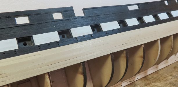

These rivets would be a later addition to the ship. Her 1920’s rebuild? The pattern does not resemble late Eighteenth Century early Nineteenth Century hand forged wrought iron fasteners.

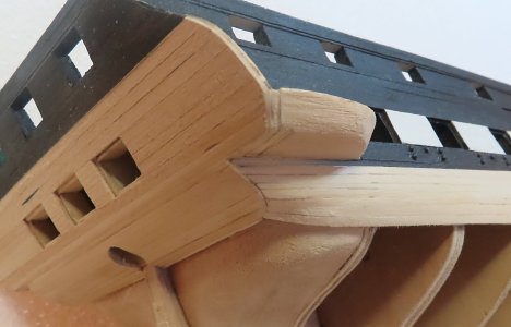

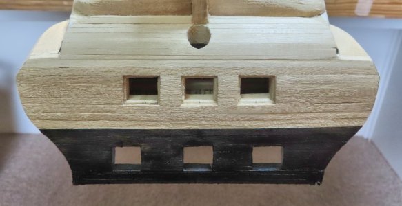

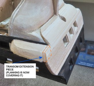

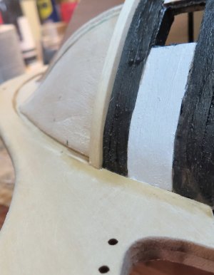

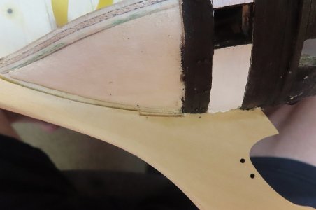

So, the Gallery is my biggest problem coming up. I will say hands down that if it were not for Bob Hunt's Practicum, I would have a very difficult time figuring this out. MAINLY due to the lack of views of the Stern Gallery section on the plans. Also, having real ship images helps.
I also had to buy some more 1/4" x 3" x 12" basswood stock, as the kit only includes one piece to make one side of the Lower Gallery section.
I could also have provided an ongoing list of the lack of building materials in this kit - it needs a MAJOR update (my opinion). This kit also needs to have some ISOmetric 3D drawings done in CADD instead of some hand-drawn images.
Ok, I am over my rant - Thank you Bob !!!

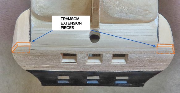

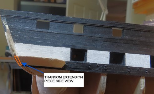

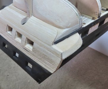

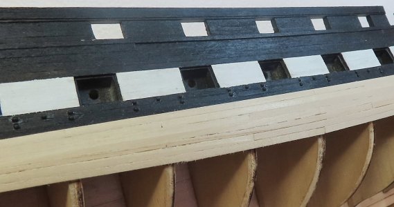

that transom extension piece was a nightmare to figure out. I had to contact Lauck street.

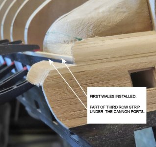

It is a big ordeal. After I laid the planks on the lower section, the FILLER BLOCKS had to be cut out more to allow room for the WALES pieces (which are very thick).
Here is the result.

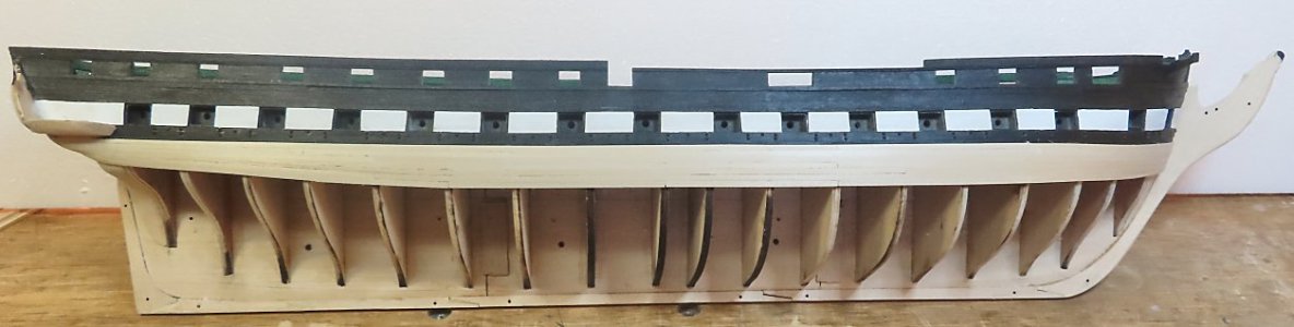

This is the first time I have seen an actual ship where the hull planking appears to follow the sheer of the gun deck and thus the ports as does your model. It seems it would be much easier than the British ships where the outboard planking sheer has no relation to the deck sheer. Very interesting.

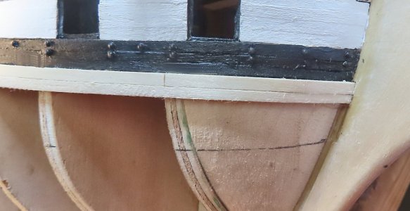

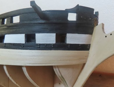

So, onward with the Wales. I decided to cut out more rabbet so the Wales would fit better. I wanted the same thickness vs. the thickness of the regular planking to be pronounced from stem to stern.
Yes, the first Wales is not tapered - I am leaving it alone. It will be painted over, and not worried about it. The remaining 6 will be tapered.
I just told the Admiral that this ship is probably going to be the last for a long time - it is wearing me out, mostly from trying to figure things out is the main problem, and not having any good direction. Again, thankful for Bob Hunt's practicum. However, it is just a guide, and a good one, but there are some steps I might have done a little differently. I would have planked the Wales before planking the lower stern.
