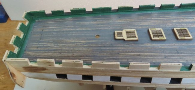

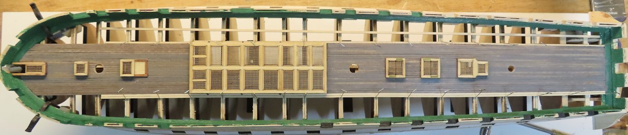

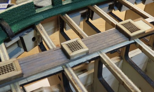

Starting the Deck Planking. Several pieces I already messed up and started over. The main point is deck COLOR. This is the combo I used and I am not saying this is the best. I am just saying that after different types of experiments, this is what I chose. Since I have a tendency to have little patience in this area, I opted for this combo. The pieces are being dry fitted - no glue up yet.
Taking a long raw strip of deck planking
1. Painting with stain (Dark Oak)
2. Painted with Weathered Gray Stain
3. Painted with another coat of Weathered Gray Stain.

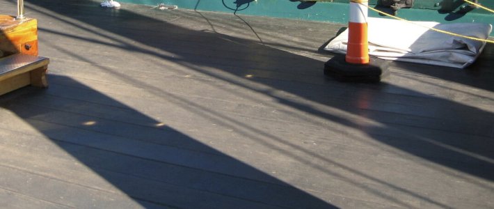

lighted sanded a few strokes of 1000 grit. In some areas of the real ship, it does appear to have some very dark red streak in the planks, maybe its the lighting on the real ship. In some photos it looks like just plain gray painted over raw wood. At any rate, I am probably going to stick with this. The light sanding gives a little worn affect, but not much. I might go back and add a little more gray stain if need be.
As they say - - I think it is close enough for Government work !!!

It gives nice contrasts in the woodwork, Donnie.
Gr. Peter

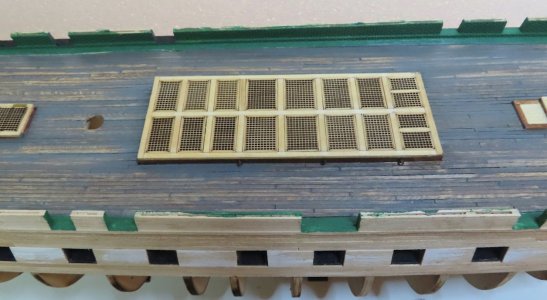

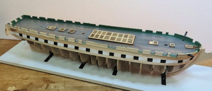

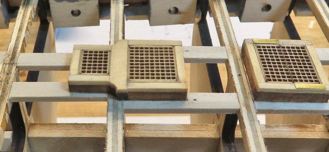

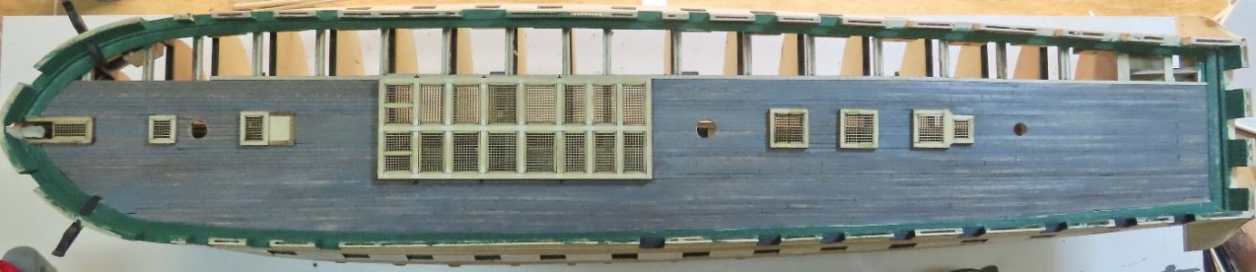

Thank you all for your support and encouragement. I was able to get more Deck Strips from Model Expo (ME). They did good and sent 40 instead of the 15 that I requested - so thank you ME !!!
Here is the latest on the Deck.
So, this falls into the dilemma of being happy with it and not happy with it. The deck looks better in real life than the pics do. Yes, I know that there are areas that look worn - but I might add some more gray later on.
However, when the deck furnishings get added along with the Cannons, Bitts, and rails, and what not , alot of this will not even be noticed or even seen. Lets just say that it is a well worn ship ! HA.
The Deck would have turned out A LOT better if this kit had a "False Ply Deck" to mount your deck strips to - like what OcCre does. This should be the first thing Model Shipways should do to this kit.
After working on this, I am tempted to say to myself, no more ship models.

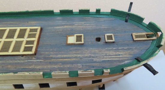

So here is the "Ugly Deck".
If you are not happy with the deck, you could try buffing it with some 0000 steel wool. It would take come of the color off and make the deck more worn, if that is the look you are after. :) There is always quilting..... ROTF Of course, that can get expensive too. My wife was looking at a sewing machine that was about $8K USD ! LOL

I think I see your deck differently than you do. You mentioned adding more grey. If it were me (and its not) I would take away some of the gray. Of course you are the captain and likely have a vision of what you are after. To me this doesn't look like wood greyed out by the sun and scrubbing - it looks like a painted grey deck with the paint worn through by weather and use. If that was your goal you are spot on - but if you intended to represent a wood deck greyed out by sun and time then it is the opaque places that need lightening.
Hope you don't mind I weighed in - I usually just sit quietly but wanted to risk a suggestion.

I hope you don’t mind me sharing a few thoughts about the deck. One of the key parts of building a model is deciding early on how you want to present it. That initial planning shapes everything, especially when it comes to how the hull and deck will work together visually.
What I’m trying to say (and please forgive any language quirks—English isn’t my first language) is this: if you’re presenting a defined age on the coppered hull, it makes sense to carry that same level of definition through to the deck, and even to the sails, in my humble opinion.
I agree with Jeff that steel wool should do the trick, and as Doc @dockattner mentioned, brightening the deck can help a lot. But in the end, as they both wisely pointed out, you’re the Captain of your build, and the final course is yours to chart!
