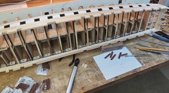

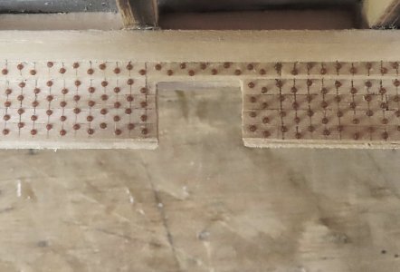

This is the latest:
Rivets:
Bought from Hobbylinc
.035 Rivets (200) -- HO Scale Model Train Part #8020 Note: the .035 is the Rivet "head" diameter and not the shaft part of it. DO NOT use a .035 Drill Bit.Hobbylinc
Hobbylinc.com carries over 70,000 hobby products at savings up to 60% including plastic model kits, model trains and railroads, model rockets, arts and crafts, paint, tools, supplies and more. Call to order toll-free at 1-888-327-9673www.hobbylinc.com

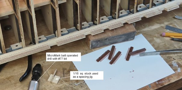

Use at least a #77 bit as shown in last photo. Lastly, if you decide to do this, cut the Rivets off the sprue using an exacto knife and cut them off at an ANGLE - this will produce a sharp edge to help go into the holes.

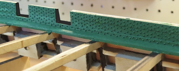

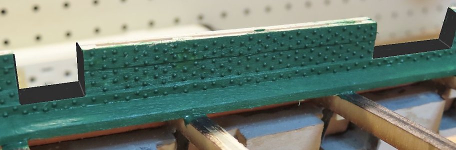

looks good. I decided not to include rivets but I may change my mind.I decided to change over to MicroMark's Battery Operated powered screwdriver with added chuck. The main problem with the chuck is that the opening of the chuck is slightly larger than the shaft of the driver, therefore the chuck wobbles slightly. To overcome this, I wrapped the shaft of the driver with one lap of tin foil which filled in the gap. Now, the drill bit and chuck runs true (well, lets say a lot better). Ideally, the tip of the electric screwdriver really needs to have a "screw on thread type" that will keep ALL attachments true. The motor and shaft do run quite very true (no run-out - i.e. wobbling). However, in MM's defense, I would say that after-all, the driver is really intended to drive screws and not drill bits. But, with a little modification, it gets the job done well.
So, this process is not really that bad. What you see here is about 5 hours of work. No glue has been used, just the pressure of the holes are keeping the rivets in place. They should not come out unless you or someone takes the time to pull them out.

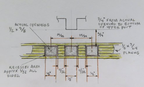

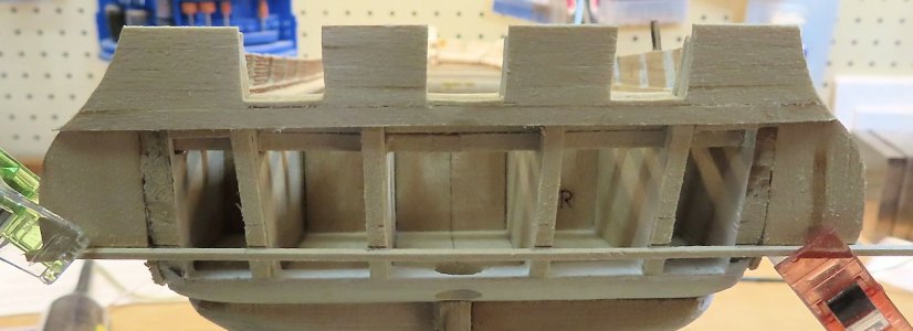

This picture (actual drawing of measurements) shows the result of getting things lined up for the 3 openings below the 'upper gun ports'. The center port is the only one that will be in a vertical alignment with the upper gun port. Here is a drawing of my results. There should be enough measurements to deduct reasoning. The remaining images show the build up.

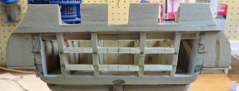

So, this is the beginning:

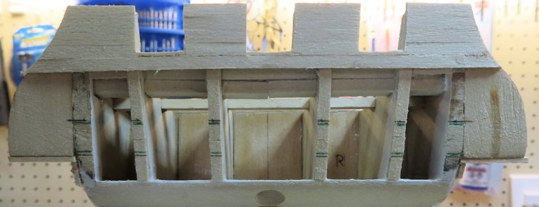

The scrap piece is used as an ALIGNMENT - the scrap piece is secured at the BOTTOM of the Transom Extension pieces. As I recall, all the measurements will be taken from this reference point. I also found out that the HEIGHT of the Extension pieces needed to have about a 1/32 to 1/16 scrap added to each side (eventually). for now, just use the bottom of the extension as they come from the kit as is.

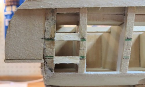

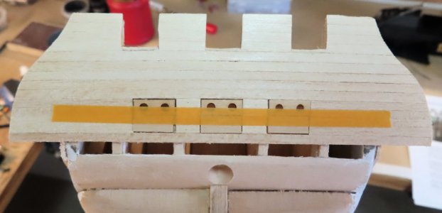

Here are the TICK MARKS laying out the position of the openings. You will notice that I have already added the scrap pieces to extend the HEIGHT of the Transom extension pieces.

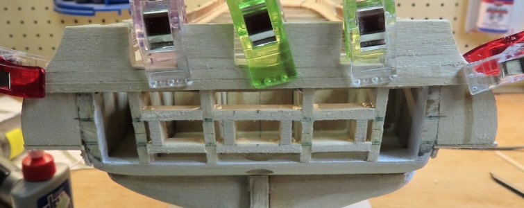

Start adding 1/8 x 1/4 pieces to "frame" the openings.
I found later on that I had to make some slight adjustments to the port framing (as we all know that wood is not exactly a perfect science). Adjustments as much as + / - 1/32" was needed on some framing to line up with the planking. This is all due to the nature that the stern has CURVATURE and is NOT a flat surface.
As I noted, you might have to make some slight adjustments to the frame versus the planking due to curvature. The OBJECTIVE is to make sure you have at least 1/32 inches as a recess for the LIDS to lay into.
And this is the final result of your achievements.
