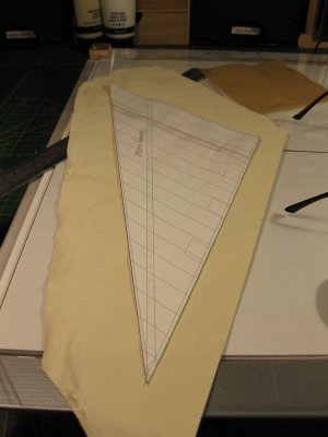

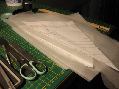

I am now making all the sail cloths. First cut the Japanese paper to size, then painting and drying piece by piece And then making a sail.
One is ready and now there are a few more to go. That will take me a while.
