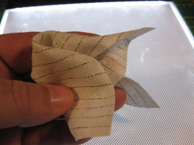

My first attempt was with Filmoplast@R and very thin cotton cloth

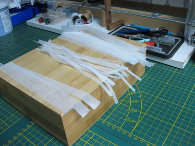

I made strokes of the Filmoplast@R (this is Japanese paper (8gmm2) with a layer of heat reaction glue.
These strokes I glued on the cotton.
I don't like the result.

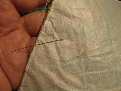

The second attempt was with silk cloth
This one is for my Newport. I rigged a dark thread into the cloth and sealed the edges with Filmoplast@R
Time is wasted, not what I want.

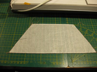

Third attempt, Peters method combined with Filmoplast@R
Kashmir Japanese paper 11 grams per m2
It looks better but.......
You have the need of Peter's fingers, patience and skills to handled that. That sail takes way to much time to make and is to fragile to handle.

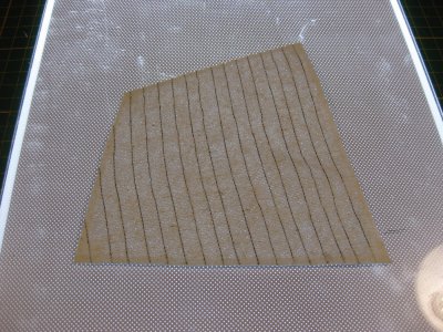

View attachment 511497View attachment 511498
