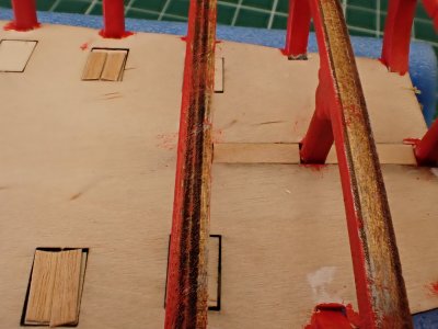

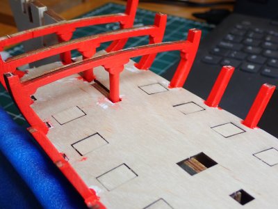

Two coats of Stynylrez white primer brushed on took me this far. It's a primer intended for airbrushing plastic and resin kits but works well on wood too. It's pigment heavy and covers the different aspects of the plywood, unifying edges and faces into an even white surface which reflects the light back through the always slightly translucent Vallejo Game Color paint and makes the 'Bloody Red' shade quite vivid. I thought Bloody Red was perfect for a pirate ship.
Two coats of red and Coquin begins to come to life! With both primer and topcoat, I was able to apply the second coat immediately after the first one. By the time I'd covered the aft end, and worked around the timberheads, the start point was dry enough to receive the second layer. Such is the joy of acrylic paint!
Note that I've glued the many holes for the gratings closed with the scrap material that originally came from them. There's one left open on this photo and you will see that the keel is visible just a millimeter below the surface. Every opening had either keel or bulkhead directly underneath. If this were seen through the grating, it would look awful, and planking around the holes would be tiresome for me, especially with the fancy planking scheme. I'll simply back my gratings with a slip of black paper which will give the impression of depth, and stick them directly to the deck.

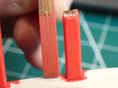

This is the result of using primer. The unprimed plywood scrap is not only less dramatic in colour but it's clearly made of plywood. I love the plywood for it's strength and stability but it's hopelessly anachronistic and ugly as a boot, even on the faces. If the instructions (suggestions?) are followed, the prow will be plywood, dyed to approximately match the hull planking. Ew, nasty! Consequently I'll be veneering any plywood which remains visible above the smooth white bottom of our saucy little bateau.

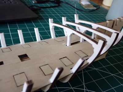

Some of the holes in the deck for the gratings, together with the long slot under the quarterdeck, needed filling to make the deck more or less even. I didn't manage to glue the deck down perfectly but let's keep that between us, eh?

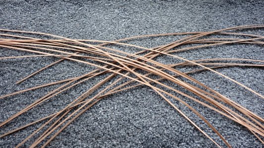

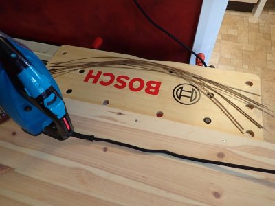

While the patches were drying I started bending wood.
I use a smoothing iron and a pine board. I briefly wet the planks with boiling water from a kettle, clamp one end and then as I move the iron along the plank I feed the free end in at an angle. That's very unclear, sorry. I can't think of a better way to describe it right now. Maybe next time?
I did ten each of milk and plain walnut. The bends are various, approximate and irregular and somewhere on each strip I can usually find a section with a curve that I can use. This is the way I plank hulls too, as you will see quite soon if you stick around.

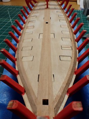

I laid three 4mm 'king planks' straight down the middle before starting to work the curved ones in from the bulwarks. Originally I intended to use a third colour wood but subtlety won out and I used some wood that matched one of the curving timbers.
[That's just a damned lie Mr Smith!]
OK. I picked up the wrong sheaf of 4mm planks and accidentally made it more elegant. I was aiming for orange but overnight I confused myself and put the two sheaves down in the wrong places. I didn't realise until much too late to do anything about it. I certainly wasn't going to start over.

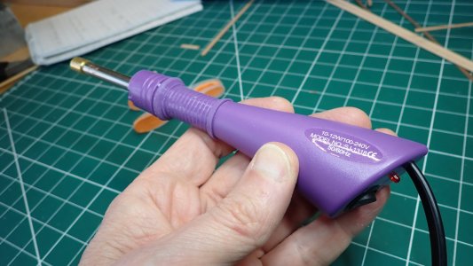

Seven full planks in a (bad) day is quite good progress, even if the quality of the work is a tad sub-par. The speed and ease of tacking the curves down instantaneously is achieved by heat setting the Titebond with this rhinestone applicator. Much loved by dressmakers and cowboys alike, it's available from China via the Amazon, which is a curiously long way round. It was far cheaper than those yellow handled plank bending tools and all the better for having a power on light and a switch. It heats up much faster but doesn't get hot enough to char the wood. Just a brilliant little tool that you really must have or you are a rubbish modeller (laughs bitterly at own hypocrisy). Note that I have cut the heat guard away from mine for added excitement.
For more discussion of the heat setting technique I refer the honorable members to a post I made in an earlier project of mine HERE.
