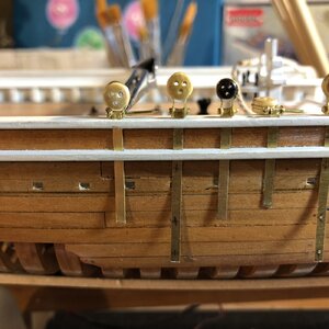

Today the first four chainplates were installed. It's a very time consuming task, especially since I'm making the deadeye rings myself, using the M0,8 bolts and nuts I was given by @Peter Voogt and some required additional blackening. Adding to the challenge is that I actually have a very vague idea what needs to be done, but no experience in the tasks at hand, meaning quite a bit of trail and error is involved.
Still, I'm happy with the results so far. Up to the next 16 chainplates. Boy, am I glad I'm not building the Cutty Sark.

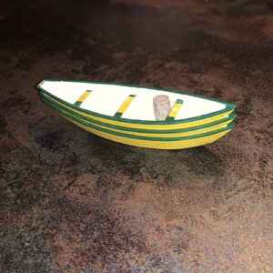

Also nearing completion are the dories, at least the basics are there, still some work required, but they are definitely taking shape and I am still happy to have opted to buy some good old Billing Boats dories.
The four chainplates for the main mast shrouds installed, looking great!
The four dories, three port and one starboard. I played around a little with the colors, assuming that the dories might have different paint schemes, think about dories being repainted, repaired or replaced, that's how I justify my choices... ;)
At least the beer kegs are already loaded!

For the restoration of the Bluenose my father build, I used the dories as delivered, with a little paint.
Now I have chosen to add some frames, a mast base and hoisting ropes, making the dories a lot more convincing, although in all likelihood not historically correct.

On the starboard side all 10 chainplates, including deadeyes, are now installed. Onto the next 10 chainplates...
Some pics of the dories, with a comparison between the YQ- and BB dories:
On the left the YQ dory, the right dory is a customized Billing Boats dory from their 1:65 Bluenose I kit. The ropes to stem and stern still to be added.
Left the BB-dory, to me geometrically more convincing, more proportional than the YQ-dory on the right.
Customizations to the dory are the supports for the benches, the representations of the dory frames, the mast foot underneath the front bench and of course the barrel, aft of the front bench. At a later stage some more equipment will be added.

Twenty deadeyes with shackles attached to the chainplates attached to the hull. This really feels like an accomplishment: twenty self-fabricated shackles, twenty chainplates and twenty M0,8 bolts and nuts, given by a generous friend, plus 60 nails, simulating bolts; finally I am able to close this chapter.
And yes, I scaled down the deadeyes to 5 and 4mm...
