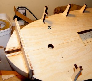

Next up was the deck, as I said before the plywood was great and the deck had a line etched down the centre.

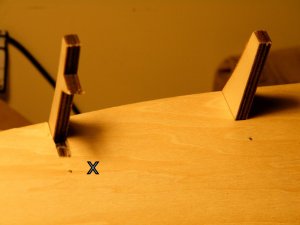

I had one little problem and I had to cut the slot in the deck a little longer to manage to get it over the bulkhead and down to where it had to go, X marks the spot they say, you can see how I had to cut it.
A close up view

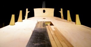

After the main deck was on I started on the planking, the planks all come cut to lenght and have two nail holes at one end and one at the other, you can either leave them as they are, they are quite small, or you can use them as a guide for drilling and inserting Trunnels, you can just see them on the ends of the planks,
View from aft, I lightly pinned a steel rule up against the centre line, and i used a four butt shift
