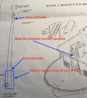

Before I glue the deck/roof on the Boiler structure I need to build the Main mast. I've made several attempts at squaring what would be the bottom of a round dowel. But .......
The instructions call for a 6mm ( 1/4inch ) dowel, 154mm (6 1/4 inches) long. To keep up with the taper of the mast ( 6mm at the bottom and 4mm at the top) I've been experimenting with 10mm (3/8 inch) dowels. While the instruction call for a completely round tampered mast I like the look of a square bottom between the uprights. The space available is about 27+/- mm.
So SUGGESTIONS????

Hi Jan,
This is what the Alan Bates Cyclopedium shows. Perhaps it helps?
From the Main deck to the Boiler deck, you can make it square.
On the boilerdeck between the curved uprights octagonal.
And above that point, you make it round.
A stempiece is not needed because the mast is supported by the Boiler deck and the uprights.

Excellent information Peter. It never occurred to me to start with a square piece and trim it to shape. Just did not “Think” enough about that step.

Aah ...... I forgot to look at the 3D video.
Perhaps square between Boiler and Hurricane. And on the Hurricane octagonal till the hight of the Texas?
And then round?
On my Lee I went also from square, to octa, to round.

A test fit of the idea. The square part and a 4.5 mm dowel (easier to do in two pieces). Looks like the square bottom should end just below the arches. I did not see the octangular part on the 3d photo, but I definitely will try that.
