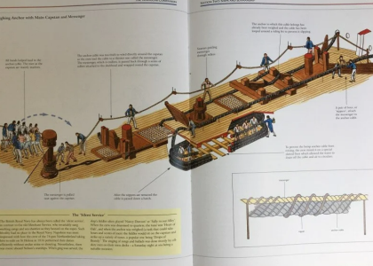

Hello iutar!
Thank you very much for your feedback. I will do it as you say.... The rope was only temporary, just to see if the rope through the holes I drilled in the hull were big enough..
On the other hand, I found the photo of the Diana attached on the internet...
In principle it is as shown in the diagram....and as already said I will implement it like this (later)..
Marc
