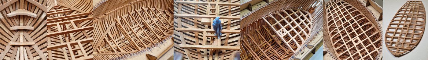

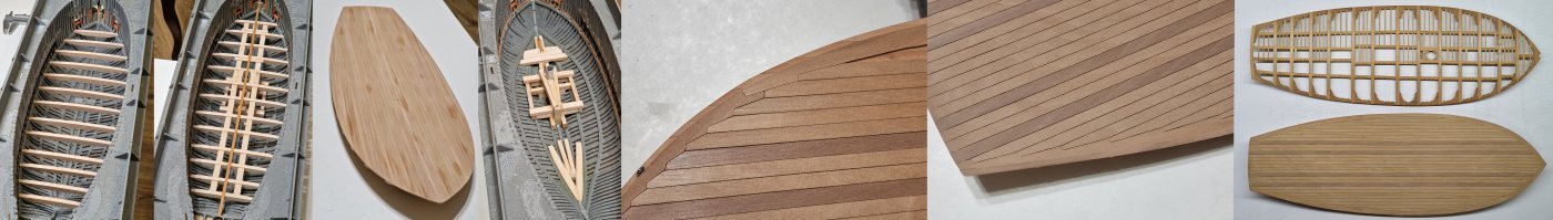

I have very ambitious plans for this project. Let me briefly outline everything I want to implement.
I want to build 2 separate hulls. Maybe even both hulls will be in one showcase (but this is not certain).
So, the first hull will be a complete skeleton (the construction will be carried out according to the Trident kit). But only until the end of the upper deck and railings. Everything on the deck will not be fixed to this hull.
The second hull will be an exact copy of the first. I will do this by scanning the wooden hull and then I will print the second hull on a 3D printer. It will be completely sheathed with slats both outside and on the deck (without access to the interior). Also, all the deck parts will be installed on this hull: guns, hatches, etc. As well as all the rigging parts: masts, yards, etc.
But that’s not all. I also want to scale up the ship’s anatomy plans to match the kit’s dimensions and print them 1:1. Using these plans, I’ll fabricate the masts, yards, and rigging for the second hull. I’m undecided on whether to include sails.
The result will be a continuous building process with two extremes: 1. An admiralty-style skeleton hull. 2. A fully finished model with no cutouts to view the interior.
Some might find this approach strange, as it’s common to plank one side of the ship and leave the other open for viewing. However, I’m drawn to the two extremes: either a complete ship or just the skeleton.
I’m unsure if my plans will change along the way, but I’m committed to this vision and hope it comes to fruition. Wish me luck as I embark on this long but exciting journey.
