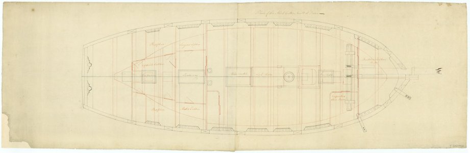

Now, let’s proceed step by step, starting with the drawings.
The drawings are at a 1:1 scale to the model, which is great. However, there are two issues: 1.They were folded many times (I had to iron them to make them usable). 2. Who thought of drawing blue lines on a light blue background? It’s barely readable!
3. And the most important thing! Attention, this drawing is not 1:1, but 0.5% smaller than the original scale of the model! I will fix this.
To address this, I’ll scan and print them in black and white, supplementing them with anatomy plans. And I'll fix scale! I’ll dedicate a separate section to this topic.
