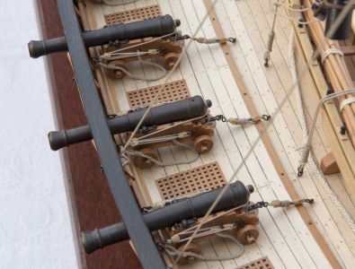

Now I am done with stamping the metal parts, just blackening later in the process and started to work on carriage rigging. For this I decided not to use kit provided ropes but instead third party. Ropes from kit are fairly low quality and personally it does not make sense putting so much time, money and customization into kit to be finished with low quality rigging, which is the most visible part of a model. Maybe in the near future I master the skills of making my own rope but for now, some online purchased ropes were used.
End result..
How did I get here? First I build a small jig that will assist keeping carriage fixed while working on rigging.
Then I cut all ropes in correct length and add an eyebolt on one end of the rope. Rope with eyebolt was put in helping hands..
.. seizing was put around it...
... I used polyester rope in darker colour than rigging rope since I like seizing to be visible. Poliester rope get tendency to split when cut so I put a small drop of CA on area were cut will be applied. It is clearly visible where cut was done. I do not care too much about split rope since seizing will make sure no hair is sticking out and a drop of CA will keep all in place.
Then I run excess seizing rope 5 times around the tan rope, and use a small clothespin as a weight, pulling one seizing rope side down..
End result...
Then the loose tan rope end was drag thru the carriage..
Another eyebolt installed with the same process when it comes to seizing..
Once the tan rope was pull back towards the carriage so it stay tight, the seizing was applied, glued, and second eyebolt was moved to helping hand, assisting with 5 rounds of seizing rope around and drop of CA to freeze the seizing. Again, small clothespin was used to assist. End result..
Happy modelling...
