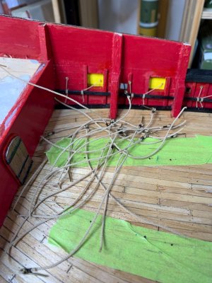

All gun lids were mounted in open or close position and lid ropes were pulled thru.
Then I started to tight all those gun lid ropes to the ship hull..
The ropes were run around three times and freeze up with a drop of CA glue. Continue to all ropes and then will start with gun rigging... fun part.

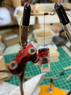

Then I cut all ropes in correct length and add an eyebolt on one end of the rope. Rope with eyebolt was put in helping hands..
.. seizing was put around it...
... I used polyester rope in darker colour than rigging rope since I like seizing to be visible. Poliester rope get tendency to split when cut so I put a small drop of CA on area were cut will be applied. It is clearly visible where cut was done. I do not care too much about split rope since seizing will make sure no hair is sticking out and a drop of CA will keep all in place.
Then I run excess seizing rope 5 times around the tan rope, and use a small clothespin as a weight, pulling one seizing rope side down..

Once the tan rope was pull back towards the carriage so it stay tight, the seizing was applied, glued, and second eyebolt was moved to helping hand, assisting with 5 rounds of seizing rope around and drop of CA to freeze the seizing. Again, small clothespin was used to assist. End result..

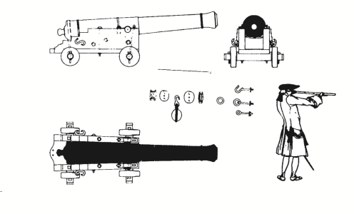

Your seizing looks wonderful, but I’ve never seen breeching ropes run through the carriage like that. They usually run through an eyebolt on either side of the carriage and wrap around the corbel of the gun.
If I could, gentlemen... it was common for the French (and a few other nations) to run the breech rope through the carriage - it was an English (and American) practice to rig the guns through eyebolts and around the corbel on the barrel. Having now shared this, keep in mind that my wife assures me that I am often wrong...about most everything... :).
I believe you are correct...

Going back to the French way... here is snippet from Ancre' Xebex monogram, showing pretty much what we chatted about...

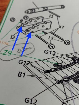

And then looking at this picture, I noted that all my guns are not sitting tight in the carriages... So back to the kit instruction...
... here is a part I missed, very misleading... being in tech for a while, got used to correct technical drawings but this one is not quite right. The openings for a carriage wheels is cut in side cheeks and this diagram shows openings in carriage bed. So if not attention is made like in my case, I assumed the side cheeks will be mounted outside of the bed not at the top, which causing axles to fit nicely in the cheeks but the whole carriage is wider that gun, causing guns not to fit tight into... Now I am facing a slight dilemma, should I go with rebuilding from scratch all 18 carriages or blame kit instructions for not being detailed enough?
I think I might just build one prototype and see how it fits into overall ship and go from there... just looking into wider carriage that needed and having guns loosely sits in carriage might not be a good view...

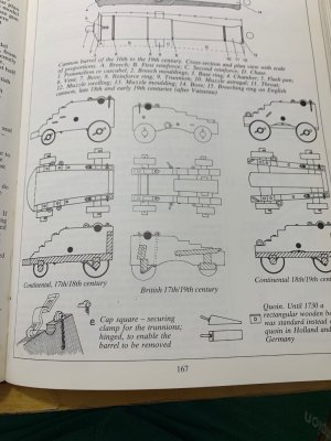

Will see and post updates... Bellow is what continental gun carriage should be like...
