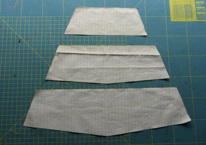

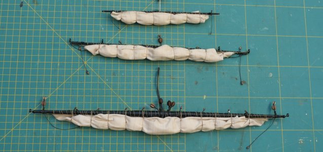

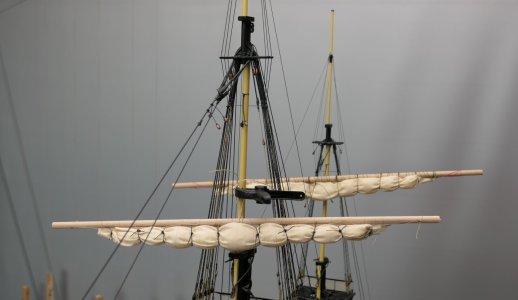

50 The Sails

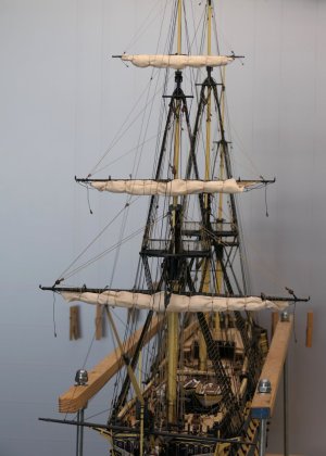

Over the past few weeks I've mainly been busy with the sails on my Victory. The idea for now remains to have the sails furled on the three masts and the bowsprit. How I'm going to do the mizzen sail, I haven't quite figured out yet, but that will come later.
Some time ago I received the necessary tips about the material to use and how things could be executed. A few weeks ago, following up on this, I visited Peter Voogt to admire the sails on his Blue Nose. Truly beautiful.
The conclusion was that for now I'll start working with paper. Fabric seems to me to quickly become too thick at this scale. On the Papier Royaal website I found the Japanese paper mentioned earlier. The choice there is huge, so there was nothing for it but to order several different sheets.
I started with Tengusho 9 grams. Peter used this paper on his Blue Nose, and it's also recommended by Stephan. After it arrived, I was shocked at how fragile this material is.
I've now ordered a second batch, consisting of: Kozo High 22 grams, Yama Kozo Hadaura S-1 and S-3. The latter two are 16 grams and are colored.
My idea is to first gain some experience with these materials and, depending on the end result, make a choice.

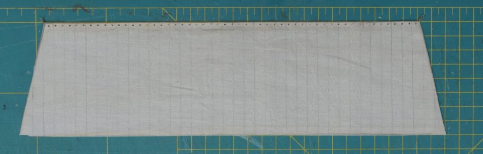

After my visit to Peter, I quickly had some ideas about the technique in my head. It comes down to this: I mount the yard in the lower fixture and pleat the cloth between the "fingers." Then, at regular intervals (next to the fingers), I can tie the bundle together, creating the characteristic bunt.
Meanwhile, I had started a search for the sail dimensions. That wasn't easy, but Claude.ai only partly provided the solution here. Longridge doesn't write anything about it either. But since the sails will be furled anyway, the height measurement in particular isn't that important. Eventually I managed to generate a complete cutting plan in which I can vary the height.
Initially I tried coating the hem of the sail with glue first and then folding it. This wasn't successful because the paper becomes soft and does all sorts of things you don't want. The solution is to fold the hem dry, which works very well, and then coat it with glue using a brush. The glue I use is Lineco Neutral pH.
Once that's done, carefully pick it up and hang it on a line with a couple of clothespins. This first test I did with the thinnest paper, 9 grams/m².

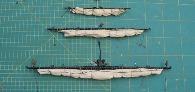

Next I did a test with Yama Kozo Hadaura S-3. Here too, the hem was folded first and then coated with glue afterward. The glue soaks through the hem and reaches the bottom layer as well.
Once the hem had dried somewhat, I immediately made a first attempt at applying the boltrope, the rope attached around the edges of the sail. In reality this rope is sewn to the sail, with the sewing thread passed through the middle of the rope. Aside from this painstaking work, almost nothing of this detail can be seen at this scale. So in my case I glued the rope against the edge of the sail. I left a loop at the corners for the clews. I applied the glue with a small brush. That actually went fine.
I finished off the clews with a small whipping, sealed with a small drop of superglue. Then I finally got the yard out.

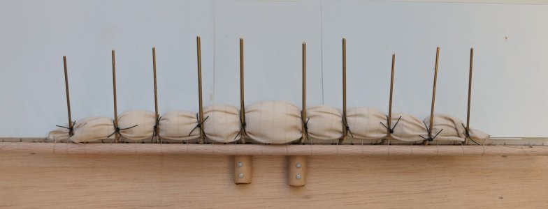

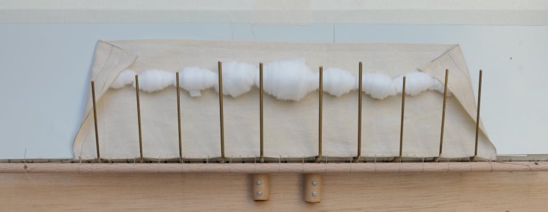

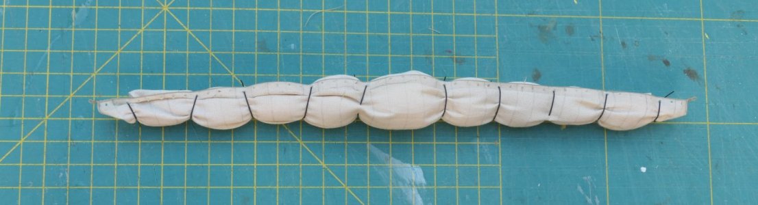

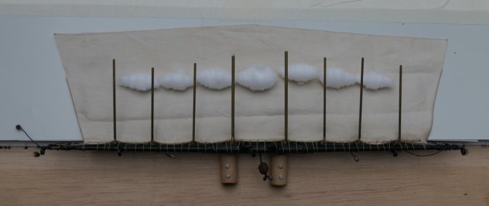

To be able to bend the sail to the yard, I drilled a 1 mm hole every 5 mm in the hem and then threaded a thread through these holes with a needle and around the yard. The way it's laced isn't quite proper, but it's sufficient for now. It is, after all, just a test.
Next I placed the yard with the sail in the fixture with the fingers, folded the bottom corners inward, and crumpled the sail up a bit.
Then, using some red thread at regular intervals, I gathered the bundle together a bit to approximate the characteristic shape. These red gathers will later be hidden by the final ropes in the correct color.

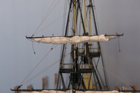

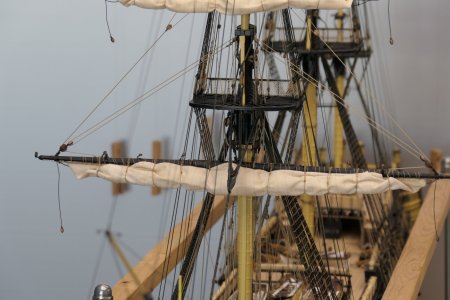

In the model this looks as follows.
Conclusion:
  • A good first test
  • The chosen method isn't difficult and is quite manageable
  • The dark paper used is too dark and shines like paper, not suitable
The next test will be with the 9-gram paper. I have a feeling this will turn out better.
To be continued

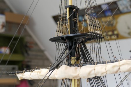

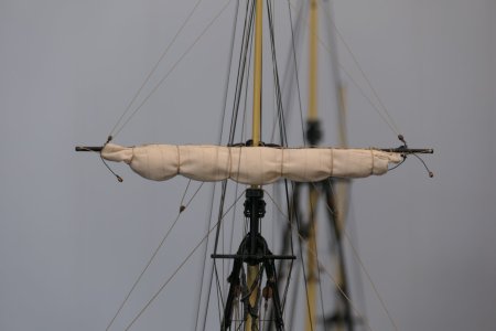

That indeed looks like a successful test, Wil. Especially on this scale. That board with the ‘fingers’ is a clever solution.
This way you get a good feel for the paper. The color as shown in the last photo looks quite old-fashioned, with the necessary shading color variations in the folds. But a lighter would indeed be better, I think.
This week I spent a day on a new sail trial. Now using Tengusho 9 gram paper. Very thin and fragile paper, so extra care was needed, which wasn't easy.
Cutting the paper with the rotary cutter I bought works fine. Scissors or sharp hobby knives/scalpels are a bad idea with this material.
Pre-folding the hems and then gluing them also works well with a brush. I put a small amount of glue on a jar lid and dose it from there with the brush. Manageable. You do need to watch that the seam doesn't get too wet, otherwise the brush wipes the paper apart.
After the hems cured, I glued the boltrope. I only did this along the top edge and part of the sides. You don't see the rest anyway, and it's just a stiff element in the whole.
Next I drilled holes every 5 mm in the hem to tie the sail to the yard. Then attached the sail at the clews to the yard and started the tying. During this tying the sail gets manipulated quite a bit, which caused the paper to tear along the hem. Holes also appeared elsewhere in the paper. So I took the sail back off and glued a 1 cm wide strip of paper over the hem for reinforcement.
Once the sail had cured again and the holes were redrilled, mounting could resume. This went well. You just have to watch closely that the horses stay clear and don't get tangled in the tying. A few times I had to undo some stitches. This remains an important point of attention.
Then I placed the yard with the attached sail into the fixture with the fingers and folded the ends inward. Then rolling up could begin. The hem reinforcement caused little trouble.
While bundling the sail I noticed I still get too little belly in the paper. I have a feeling I need to add more material to the sail, so I can pull the tying lines a bit tighter around it.
Conclusion:
  • A successful second trial
  • The thin paper used drapes better and looks more natural than the thicker paper used before
  • Add more filling between the bindings (cotton wool?)
Next trial is again with the 9 gram paper, expanded with today's lessons.
The sail is still too white. I'll add color once I have the process fully under control.
To be continued
My adventure continues, though. After yesterday's idea about the cotton wool filling, I had a clear moment last night about how to solve this. The filling shouldn't be too firm, so it can move along a bit. In addition, the shape of the filling needs to be pre-formed a bit toward the desired end result, meaning wide here and narrow there.
That's when I came up with the idea of using the cotton wool from a pressure bandage. From this I cut a number of tapering strips in various lengths. The widest measurement is 25 mm, which is the distance between the robands used to attach the sail to the yard. The narrowest measurement is 5 mm. The lengths of the strips vary from 75, 100, 150, 200, 250 to 300 mm. You roll these strips up, giving you a set of fillings of varying thickness. I fixed the thin end with a very small amount of glue, so the little roll stays in one piece.
Quite a while ago now I bought cotton sailcloth in Dordrecht, which Hans colored using oak (I believe) through some secret process (?!). During the expo in Amsterdam last year I had a choice of different color schemes for it. Naturally I chose the one that suited my ship best at the time, a bit faded and mottled. I wanted to give this material a chance before making the definitive switch to the thin, fragile paper that I still had to color. To avoid getting too much cloth onto the yard, the sails ended up 8 cm in length.
Unlike the trials with paper, I haven't applied any hems here, fearing this would become too stiff. I traced the sails onto the cloth and coated the cutting lines with a bit of glue (Lineco Neutral pH), just wide enough to prevent fraying after cutting. I kept the side that comes against the yard a good 5 mm wide, to leave room for the holes through which the rope needs to be threaded. I kept the bottom edge a bit shorter, more on that later.
The approach and continuation of this process were the same as with the paper sails, including applying the boltrope.
Next, as a trial, I took a piece of 6 mm dowel and mounted the sail onto it. Then the threading could begin.
Once the rod with the sail was placed in the finger-held fixture, I fixed a series of fillings to the cloth with a small amount of glue, increasing in thickness from outside to inside.
And then tucked the filling in nicely, so nothing of it is visible anymore.
Then the tying-off at the narrowings begins. I did this from inside to outside, pulling each roband tight one by one in such a way that a natural roll forms. I noticed a nice resistance from the little rolls here, and a good opportunity to pinch the sail at the robands. What I also discovered is that I run short of sail material at the end to properly close the bundle. Next time, then, I should make the sail wider toward the bottom instead of narrower. Lesson learned.
The result then looks like this:
Conclusion:
  • A successful third trial
  • The cotton used drapes better than expected and looks more natural than the paper used earlier
  • The filling idea worked out well
Points of attention for next time:
  • Let the bottom points of the sails taper outward rather than inward, so there's a bit more material to close the bundle
  • In my previous trials (directly on the yard) I had quite a bit of trouble with the horses and blocks present. This requires extra attention, and a mistake is easily made here. I want to try replacing the robands with new ones that go only around the sail and not around the yard. Then I can cut the bundle loose and thread it onto the yard separately afterward. Maybe that's worth trying.

In my previous post I mentioned a few points that might be worth improving. Over the past week I tried out some things, and I'm slowly getting to where I want to be. Below are my experiences from the last few days and the final result of this adventure.
First I made a sail whose bottom edge is wider than the top, so that at the end I'd have more material to close the folded package. As a test, I also drew the stitching seams on the sail with a pencil, which I later erased lightly with an eraser, leaving just a faint fake seam.
Then I added a bit more filling material in the middle and closed the sail.
On the model it looks like this:
My conclusion here is that the sail is too puffed up and therefore doesn't fall naturally. The reason: too little sailcloth relative to too much filling.
Solution: to make the sailcloth fall nicely, there needs to be a bit more cloth in the middle, and the filling should be reduced somewhat.
What did work was detaching the whole package from the yard. This way the sail can be made separately and later attached completely to the yard. On my model, for example, this needs to happen at the staysail yard, which is already mounted on the model. Here it becomes a matter of finding the holes in the sail and threading a lacing line through them.
I feel like this is more or less the end of the trial period. I've now made 4 trial sails and think I've reached the final result. I think the photos below speak for themselves.
You can clearly see here that I have a bit more cloth available to allow for more pleating. The nice thing is that later you can still make small corrections here and there with tweezers. The end result doesn't look too tight and has a slightly playful appearance. That's what I was looking for.
With that, the three sails of the foremast are done. I'll be hanging them in place over the coming weeks, so I can show up in Amsterdam properly "dressed."

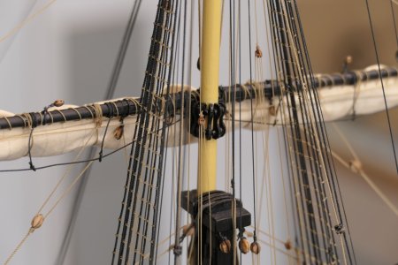

Starting with the lowest yard, the fore yard. This is hung from a sling in two parts. The upper part, which lies over the masthead, is connected to the lower part, which sits around the yard with a double loop, by means of a tackle. In practice this happens when the yard is in its upper position, to relieve the tackles in wind and to fix the yard vertically. Normally the yards hang in their lower position with the sails furled, but on my model I've made an exception for the lower yards by hanging them at the top, so the construction with the sling is clearly visible. It also obstructs the view of the deck less. (Caldercraft's building plans, incidentally, also assume this position.)
To the left and right of the sling, the jeer falls are also clearly visible. Their purpose is to be able to lower the yard when furling the sails. These tackles are hung from the mast, just below the masthead, by means of a jeer block strop and lashings.
Next come the lifts and the sail sheets, which in practice keep the yard in the correct horizontal position when the sails are set and the yard is hanging from the sling.
The thickest one on the outside is the fore topmast sail sheet. This runs via a large block at the tip of the yard downward, behind the sail, and then via another block to the belaying point on the deck. At the top, the sheet is connected via a block to the fore topmast sail clueline, which runs via a second block directly under the yard to a belaying point on the deck.
Quick question in between: I don't quite understand the interplay between the sheets and the cluelines in this context. Perhaps the experts among us can explain this?

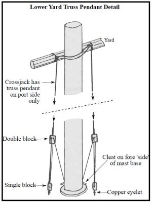

In addition, the fore yard is fixed against the mast by means of the truss pendant. Schematically, this looks as follows. At the back of the mast, the truss pendant is held up by the "nave line", which allows the truss pendant to move smoothly up and down with the yard. A nice bit of fiddly work that ends up completely hidden behind the sail. Hence the schematic drawing below.

The photos below give an impression of the end result.
Next time, on to the mainmast. But for Amsterdam I already have something to show.
