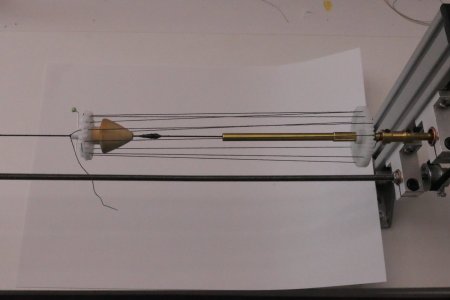

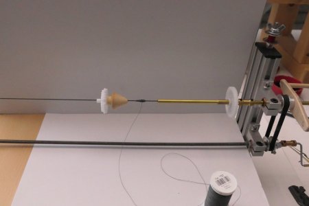

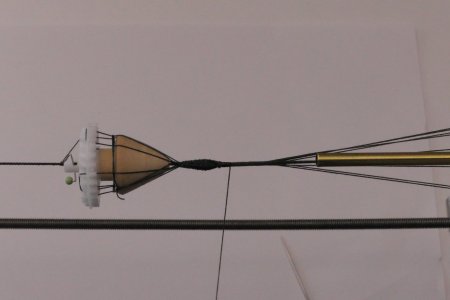

In the meantime, I have been working on building a serving machine, based on the example of Stephan (Steef66), who wrote an article about this. A very good tutorial by Stephan can also be found on SOS: https://shipsofscale.com/sosforums/threads/serving-tool.7615/
A very clear explanation that works well as both a construction guide and a reference. Not too difficult for us handy types, provided you have the right materials.
This project was more or less my first independent experience with AliExpress. Many different components in various sizes. It seemed like a nice challenge to order everything this way. Well, I certainly found out. I’ll spare you the details, but from day one I was buried in emails from the Far East. Each email referred to just one component. It turned out that the order was shipped from multiple locations. I hadn’t paid enough attention during ordering and ended up with many different suppliers, each adding their own shipping costs. Some items were suddenly no longer deliverable because of “transport issues.” Getting a refund? Not a chance. Long story short: an expensive lesson. But well, that’s part of the experience now and then.
After several weeks everything finally arrived, and I could get started. My Victory will need a huge number of served lines, so this machine will be a very useful tool.

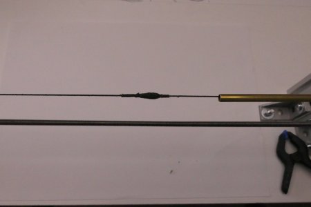

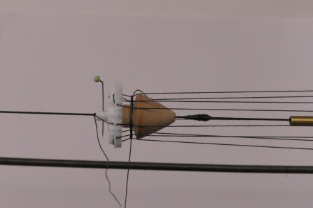

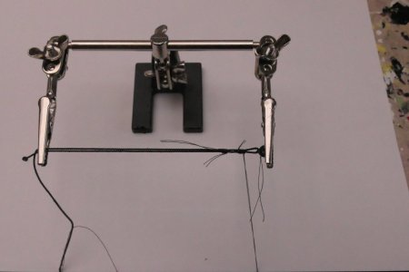

As a starting point, I used a full 1-meter M5 threaded rod. This results in about 80 cm of free length between the two halves of the machine. Perhaps a bit large, but better too big than too small. I have no idea yet how long the pieces I’ll need to serve will be. Plenty of workspace, at least.
The machine is now finished, and this afternoon I served my first rope, see the photo series below.
And the final result, photographed with the macro lens:

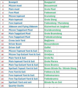

In other words: I am completely ready. I am not going to produce large amounts of rope in advance, but will determine what each project needs and then twist and bake those ropes. This keeps the process fun and varied. I suspect the journey will still be quite long, my feeling is that I’m only halfway through the Victory.

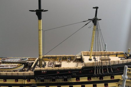

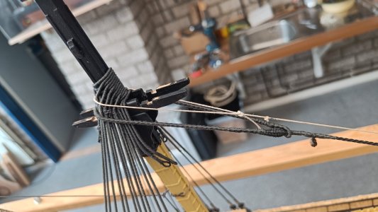

The first ropes on the ship are now installed: the gammoning on the bowsprit. It was fortunate that I had accidentally broken off the “marines’ walk” on the forecastle earlier. This gave me better access. The photo below shows what a fiddly job it turned out to be, straight through the bows.

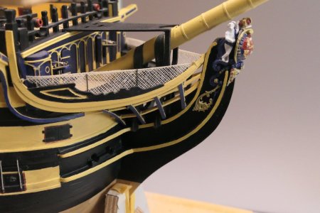

Part 1 of project 1 is now finished. The rest of the bowsprit will be completed later together with progress on the standing rigging.

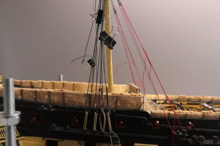

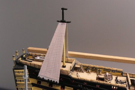

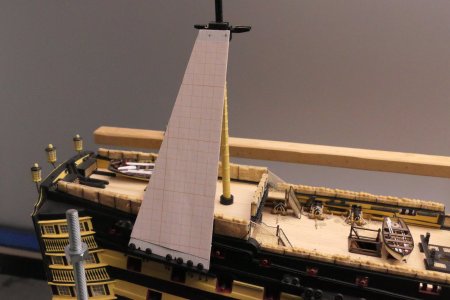

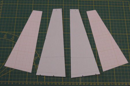

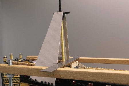

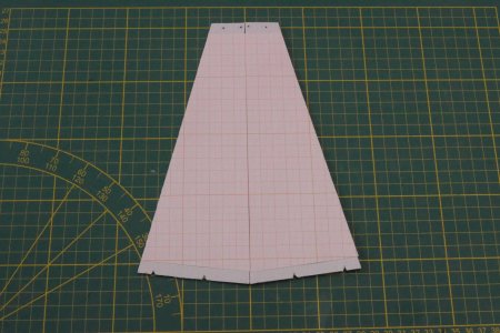

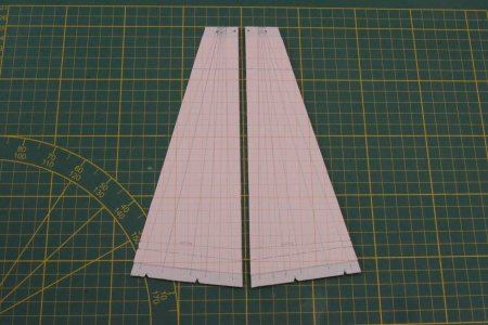

To get an idea of the dimensions of the shrouds, I made two cardboard templates, mirrored: one for port and one for starboard.
Using the guard rails I installed on my slipway, I drew a reference line on both templates, perfectly horizontal and at the same height on both sides. This after carefully adjusting the height of the rails.
I then glued graph paper onto both templates, with the horizontal lines matching the real horizontal orientation in the model. These lines later served as the reference for the ratlines, which are spaced 6 mm apart — roughly 45 cm in full scale.
In the model it looks like this:
I then marked the shroud ropes at the centers of the lower deadeyes and the area where the shrouds will wrap around the mast. I also marked the centerline for the upper deadeyes and the location of the futtock staves.
Finally, I drew in the ratlines. With a loose template like this, fitting and measuring is easy and very clear. In the model it appears as shown in the photo below. I fixed the templates at the top with a red thread, which I can remove later.

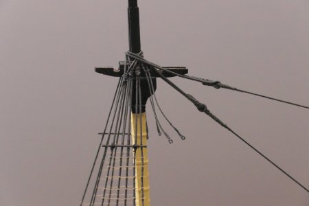

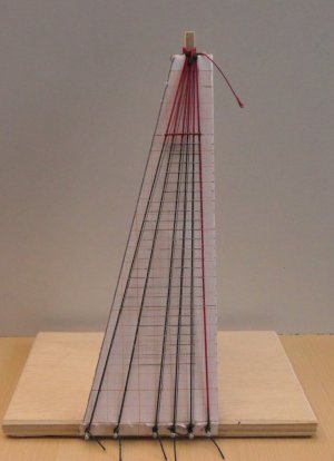

I explained how I prepared for my first rigging task: the standing rigging on the mizzenmast.

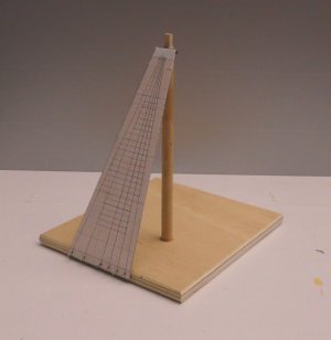

Until Stephan pointed out that I should first make a test piece. And it’s a good thing he did.

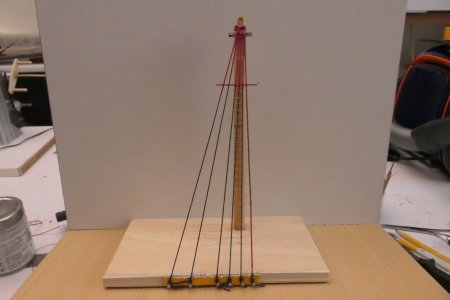

To compare with the situation on my actual model later, I first built a small mock-up of the mizzenmast setup, essentially the same configuration but more manageable.

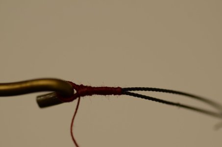

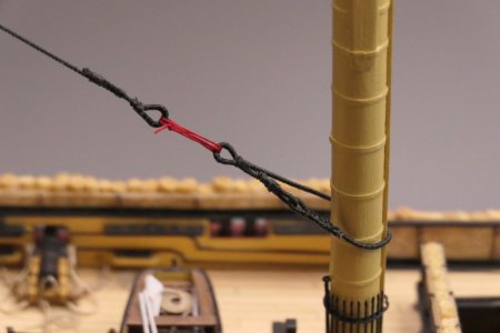

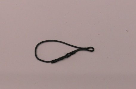

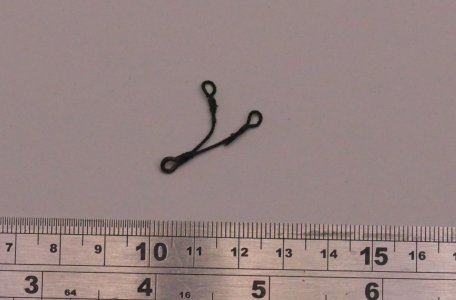

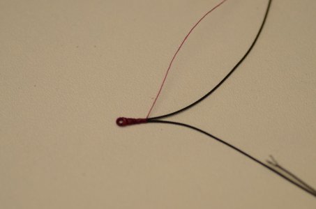

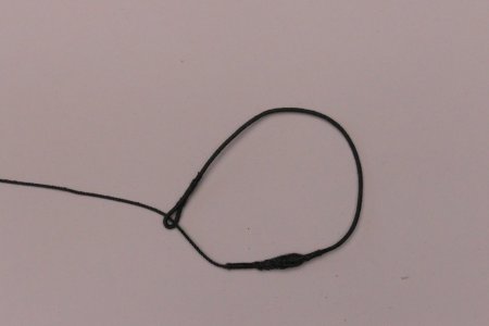

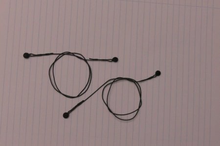

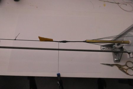

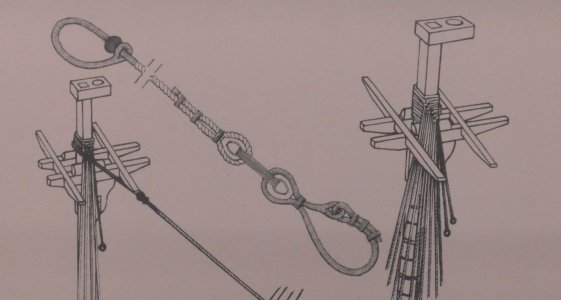

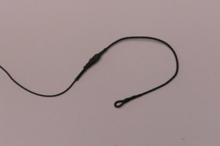

First challenge: making an eye splice, for the pendants where the tackles will later be attached. First, I wrapped a small section of rope and bent it around a brass hook. Then I twisted the two outgoing lines together. See photos:
My first rigging task after the bowsprit is now a fact, but I can tell I still need more practice.

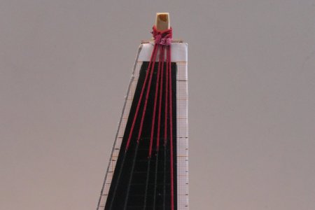

On to the shrouds. The foremost shroud must be completely parcelled. The upper sections of the other shrouds must be wrapped as well. To highlight the differences, I wrapped everything , including the pendant, with red thread. Installed on the model, it looks like this:
For the rope diameters I tried to match the dimensions listed in McKay’s table as closely as possible. For the seizings that gather the shrouds near the mast top, I used rope that turned out to be too thick. They are bulky and interfere with each other.
Then I installed the ratlines using thin beige thread. This was manageable thanks to the graph paper in the background providing alignment. Lastly, I added the futtock stave. The result so far:
When I removed the graph paper to get an impression of the final look, I was somewhat shocked, especially after placing black paper in the background.
The actual appearance of the ratlines had not fully registered with me before that moment, and it wasn’t pretty.
Tying ratlines is not difficult in itself, but achieving a consistent look, with ratlines that sag slightly instead of being too tight, is a whole different story.

• Burton pendants: z-laid 3×3, 0.55 mm
• Shrouds: s-laid 3×9, 0.90 mm. I used s-lay rope to visually match the other, thicker shrouds made from s-laid cables.
• Futtock stave: brass rod 0.7 mm wrapped with thread
• Ratlines: z-laid 3×1 beige, 0.2 mm
• All ropes except the wrapping thread were hand-laid.
There is still a lot to improve before I can be truly satisfied. So I will make another test piece on this mock-up, incorporating the following lessons learned:
Points for improvement
• I tend to tie knots and seizings too tightly. This makes corrections nearly impossible, so I must work looser.
• I pulled the seizings on the shrouds as high as possible. This isn’t necessary. They can sit lower, creating a better distribution.
• The eye splice of the pendant is too bulky. Maybe a larger hole or another method. To be tested.

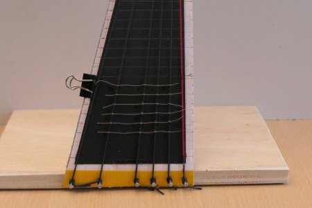

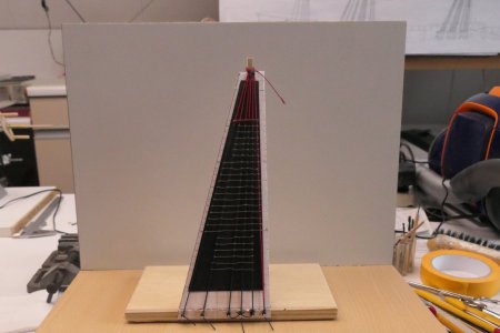

• Graph paper as a background for ratlines is unsuitable, too little contrast. Black paper is much better.
• Much more focus on tying the ratlines: far more precise, and especially avoid tightening intermediate knots too much so they can be adjusted.
• Fix each ratline knot immediately with a tiny drop of CA glue.
• I still don’t know which knot or seizing should attach the futtock stave to the shrouds.

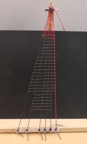

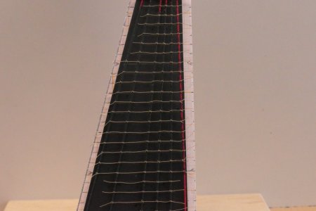

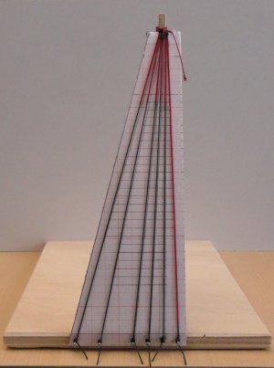

Second test piece
Over the past week and a half, I created a new test based on the lessons learned.
I rebuilt the same mock-up, including the woodwork, so that I could compare before and after side by side.
The situation around the mast top has clearly improved, although I’m still not entirely satisfied with the seizings.
For this test I again used different colored threads for the wrapping and seizings. This makes every flaw stand out, with black, it will be far less noticeable.

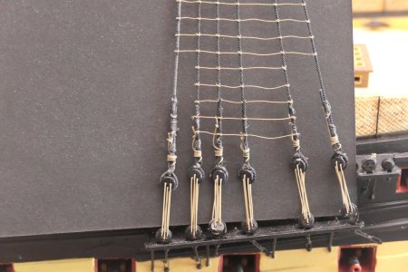

After installing the shrouds, I could begin tying the ratlines. Using pencil marks on the black background made the alignment much easier and much calmer to work with.
When you remove the black background, you get a view much closer to how it will appear on the model. Since the ratlines are only 0.2 mm thick, they are barely visible like this.
To compare results properly, I again placed a black sheet behind them for visibility:
All in all, I am satisfied with the progress, let’s call it a successful test.
The next step is to apply all these lessons to the actual model.

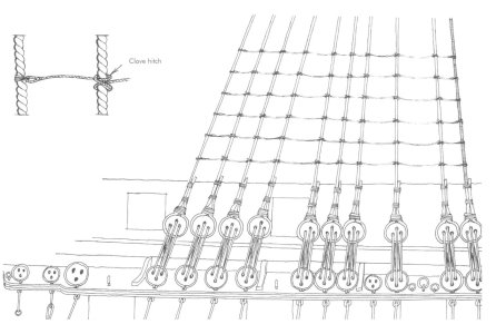

I'm going to tease you a little :) . The beginning and end are tied to the shrouds with a binding, and the ratlines have an eye. 19th-century method
Stephan, teasing is fine, no problem at all.
I know that in reality the ratlines are attached to the shrouds with a loop and a strap. But at this scale that’s not doable. Besides, you’d end up with even more knots and cut-off ends showing.

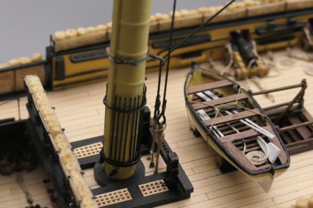

42 The Standing Rigging, in Real Life

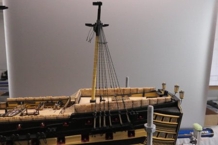

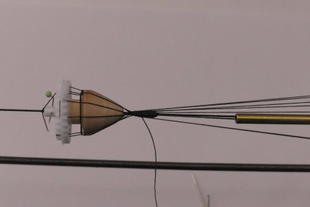

During the discussions in my Dutch build log, Stephan advised me to use thicker thread for serving the rigging. I have now bought thicker thread. However, I had already served the shrouds for the mizzen mast, and I prefer to leave them as they are. I fear that adjusting them now would disrupt the proportions between the rope diameters. But for the mainmast and foremast I did use the thicker serving thread. In the photo below you can see the first pairs of shrouds, one for port and one for starboard. The foremost shroud is fully served along its entire length.

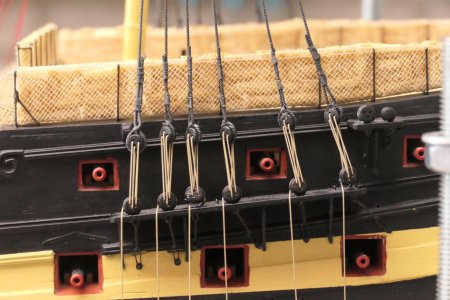

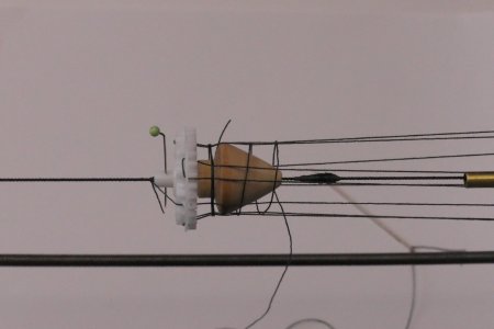

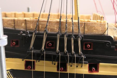

The biggest challenge here is ultimately getting the deadeyes nicely aligned.
In the photo below, you can see that I have already reeved the lanyards through the deadeyes of the first pair of shrouds, loosely for the moment. What immediately stands out is the twisting of the lanyards of the second shroud. This happens as soon as I put the slightest tension on the lanyards.
Question: How can this be prevented?
Should I first twist the shroud a few turns against its lay direction before reeving the lanyards?
In the second pair of shrouds you can see that I use two small brass fixtures, bent at a right angle at the end. With these, I fix the upper deadeye in position, after which I wrap the shroud around it and hold it under light tension. With two tiny drops of CA glue on the left and right side of the deadeye, I then fix the deadeye in place. This determines the exact length of the shroud.
It is also immediately noticeable that the lower deadeye of the third shroud is not mounted perfectly in the correct orientation. I originally glued it by eye, and now I am paying the price. Perhaps it won’t be too noticeable once all the lanyards are installed and tightened. These are the smallest deadeyes, about 4 mm in diameter, so even the slightest misalignment becomes visible. Nothing can be done about it now.
A short experience:

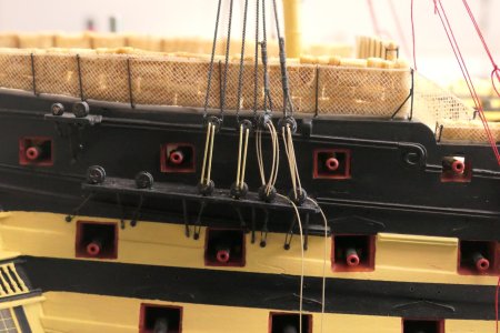

Yesterday I spent an entire evening installing the 3rd and 4th shrouds on both port and starboard. My chosen working method simply did not work. I crawled across the room on my hands and knees multiple times looking for escaped deadeyes. After 2.5 hours of struggling, I had nothing to show for it except total frustration.
This morning I got up, tore everything down again, and started over this evening with an adjusted method. This time it worked perfectly. Fortunately!

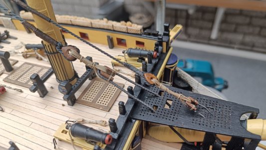

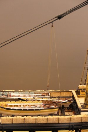

Various blocks must be hung under the tops. The build instructions prescribe eye bolts to which the blocks are tied. But I’ve also seen solutions where a rope loop from the block is passed through the platform’s deck, secured with a wooden peg above. This latter method seems more logical for the period in which the ship was built.
Can anyone comment on this?

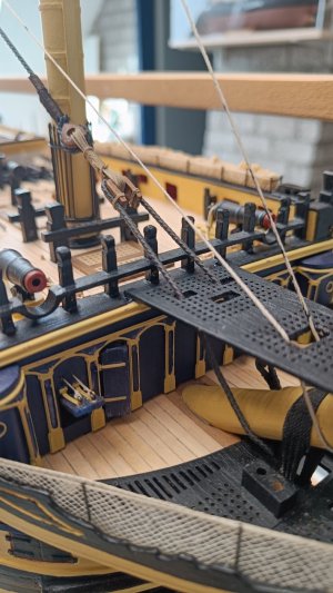

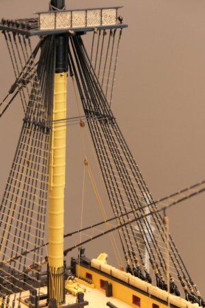

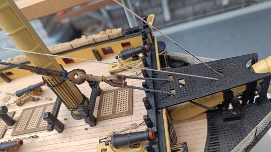

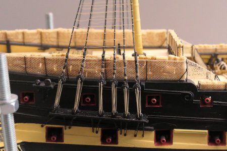

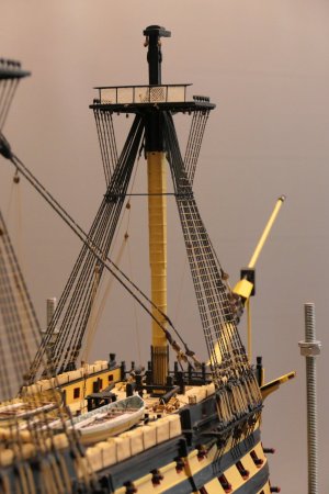

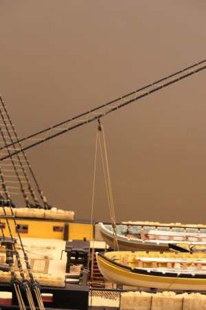

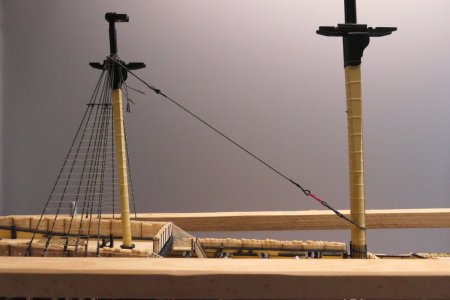

In the weeks that followed I focused on completing the mizzen shrouds. After adopting the improved method with the deadeyes, making the shrouds went smoothly. On AliExpress I had come across the small third-hand tool shown below, very handy once it arrived. A compact tool that really delivers, resulting in neatly organized knots.

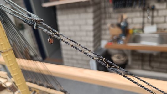

Soon all shrouds were hanging from the mast, all lightly tensioned. In the first photo, however, you can see that the upper deadeyes on the starboard side are not perfectly aligned. Later, when tensioning the shrouds, this improved somewhat, but not entirely to my liking. Something to pay extra attention to next time. On the port side (second photo), things turned out better. The twisting of the lanyards is still very visible.
Another thing that stands out is that the rope ends above the deadeyes are too long and look rather bulky. This needs refinement.

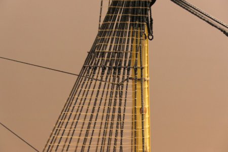

Then I started tying the ratlines. The photo below shows how I work: additional lighting to clearly see the contrast between the ratlines and the pencil lines on the black background. Again, the railing around the ship is very important, both to protect the netting and to support my arms during this intensive work. I do all work on my model standing up, which I really like.
The end result of an evening’s work is shown below. Everything still needs to be finished, for example trimming the loose ends. PS: After tying each ratline, I secure every knot with a tiny drop of CA glue.
To counteract the twisting of the lanyards, I came up with the following idea: insert a sufficiently thick strip of wood—here 3 mm—between the lanyards. The twists in the lanyards are then transferred into the shrouds, evenly distributed along their entire length. The glued ratlines effectively lock the shrouds into a stiff flat plane. After removing the strip, the lanyards remain relatively straight.

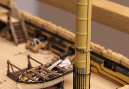

The lower ratlines are not yet successful. Mainly because the finishing of the rope ends above the deadeyes is still too bulky. I don’t think they should lie on top of one another like this.

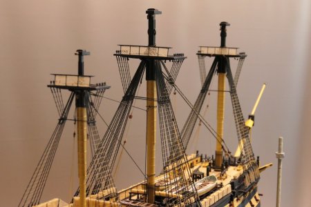

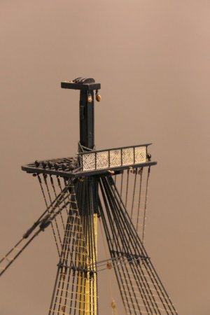

The final result for the mizzen mast is shown below. I am not fully satisfied, but repeatedly tearing everything down won’t get me anywhere either.

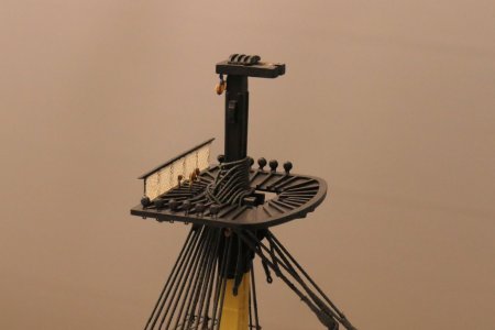

Meanwhile, I also designed a railing for the tops. A bit of painting and a net later, and it’s done.

Good morning. A fine example of how to do rigging. Your serving of the shrouds is fabulous. I also really like the way you did the hammocks in the netting- adds loads of character to your Victory. Cheers Grant
43 The Mouse
The last part of the ropework for the mizzenmast is the mizzen stay. This includes making the famous mouse. Once again I studied Stephan’s method carefully, he described the process in detail in one of his articles.
For the required components (gears) I dismantled an old printer. Luckily it contained parts I could use. The wooden cone I made from a piece of broomstick. The core of the mouse was formed by winding black thread around the stay rope into the desired shape.
The result is shown below.
Weaving the mouse went very well, as you can see in the photos:
At the end of the stay a rope eye splice is made.

44 The Stays
At the other end of the stay comes the lower heart block (closed heart) and the stay collar, as shown below:
The final assembly should match the drawing shown below, also found in Zu Mondfeld on page 284.
On the ship it currently looks like this. I have temporarily made the lanyards with red thread.
One thing that concerns me is the fastening of the stay to the mainmast. In my case it is attached with just a few drops of glue, but that certainly wasn’t the case in reality. I think I should wrap it an extra turn around the mast. But is that enough?

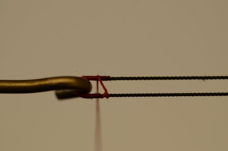

Armed with all the advice from the Dutch forum, I set to work on the mizzen stays. The photos below show the results.
First, the solution for the binding around the mast, the so-called “Rose Lashing on Collar”, as described by Longridge.
Contrary to the Caldercraft plans, I added the preventer stay in addition to the mizzen stay, after studying Longridge. For the preventer stay I had to add an additional belaying point at the foot of the mainmast. This completes sub-project 2 of the ropework: the shrouds and stays of the mizzen mast.
Next, I continued with the shrouds of the mainmast (sub-project 3). The same principle as for the mizzen mast.
Then on to the main stay and main preventer stay. First I stretched a thin helper line from the masthead to the hole in the knee of the head (stem), where the main stay will be secured. Along this I marked key positions so that back at the workbench I can accurately place them on the real stay. From top to bottom these points are:

With the experience from weaving the two mice for the mizzen stays, the main mouse is now next.
I placed the mouse on black cardboard for clarity. I am actually quite satisfied with it, except for one major mistake: I wove it the wrong way around, so the eye of the stay collar ends up against the thick part of the mouse instead of over the narrow pear-shaped end.

For the two stay tackles I want to use the bottom figure on page 270 of Zu Mondfeld as a reference, although I prefer a combination of figures 2 and 3. Longridge shows another variant similar to figure 4.
ad 4:
After tensioning the thin helper line I saw that it passes just above the spear rack. I will later need to check how this works with the thick main stay rope. The main stay must run along the starboard side of the mainmast.
Photos of the Victory in Portsmouth show that the upper heart block (closed heart) sits behind the foremast, and the lower heart block (open heart) in front of the foremast. The lanyards therefore lie against the foremast. But photo 70 in Longridge seems to show that both heart blocks lie between the foremast and the officers’ walk.
ad 5:
The frame of the officers’ walk causes a kink in the stay ropes. Whether this is true in reality I cannot confirm, but it seems odd unless wear-prevention measures were taken.
The two ropes running around the open heart block pass through the left and right openings of the walk.
ad 6 and 7:
The stay then passes left and right of the bowsprit and through the hole in the stem, inside the bows. Fine, fiddly work!
One question remains: how is the entire loop between the open heart block and the hole in the stem closed? Is this done with two interlocking eye splices, or should lanyards be used here as well? And where should this construction sit, somewhere under the officers’ walk?
The preventer stay and the snaking between the stays are also finished. The photos show the latest progress.
In the first photos you can clearly see the helper line that I strung to determine the relative positions of both stays. Initially, using the three original openings in the officers’ walk, the stays touched each other. I solved this by creating a fourth opening, giving the wedge shape between the stays proper definition.
I also made the mouse on the preventer stay shorter, without the extra pear-shaped end.
The snaking was tricky, especially tying the knots neatly with a long thread. But it turned out well and I’m happy with the result.
What now remains of project 3 are the ratlines and futtock staves for the mainmast.

The stays of the foremast, particularly the connection to the bowsprit, required modifications. The supplied open heart blocks of 7 mm were too small to fit over the jib-boom. Even 10 mm blocks wouldn’t work. So I made slightly larger ones myself. I think the result is quite a nice bit of detail.
The stay collar that wraps twice around the open heart block is essentially a rope without ends, almost impossible at our scale. I placed the two ends of the served rope against each other under the seizing. After finishing the seizing, nothing of the splice is visible.

The snaking between the stay and the preventer stay was made from my thinnest thread (3×1), like the ratlines. The challenge is representing the real appearance without pulling the stays too close together while still getting the snaking reasonably taut. I solved this by first installing the snaking slightly loose and securing each knot with a tiny drop of glue, which brought the stays a bit closer together. Then I brushed the snaking lightly with CA glue and gently spread the stays apart while it cured. The stays and the snaking now retain a straight form.
45 The Area Around the Tops
The build manual says little about the catharpin legs, nor do the drawings. So I followed Zu Mondfeld (figure bottom left on page 277), without the blocks. The catharpins on page 276 were not an option because they conflict with the masts.
I also began adding the various blocks on and under the tops. The foremast top is essentially done, though I still need to touch up the paintwork. The other two tops still follow. I will show details later when the work is finished.
What I see more and more is how important the proportions between the different rope diameters are (I use about 15 sizes). Converting McKay’s table to metric scale allows for truly precise accuracy. All the preparation is now really paying off. I’m very happy about that.
After some remarks from colleagues, I checked Longridge (page 231) regarding the catharpin legs.
I was confused by the idea that horizontally crossing catharpins would interfere with the mast, assuming that every level of shrouds should have a catharpin. This made Zu Mondfeld’s alternative seem logical.
After Herman’s correct remarks, I removed the existing catharpin legs immediately fortunately, that was easy and installed new ones, this time correctly.
One thing I should have done (but realized too late) was serve the catharpins.
The tops have been fitted with the necessary blocks. I chose to use eye bolts after all. I had already pre-drilled many holes and in several places the alternative method (loops with pegs through the deck) conflicted with the ribs of the tops. The eye bolts are practically invisible once the paint is touched up.
After replacing the catharpin legs, the futtock shrouds were next. At the top, against the underside of the tops, these are hooked into the frames of the deadeye strops as supplied. At the bottom I wrapped them around the futtock staves and secured them with seizings against the shrouds.
Then I added the last ratlines to the futtock shrouds, completing all standing rigging of the lower masts. The photos give an impression. It is beginning to look like something—I’m very satisfied.

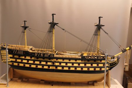

Bravo!!!!! This is one of the best Victory models from a kit I have seen. All the added details and correct rigging is brilliant. Cheers Grant
46 The Tackles
Meanwhile I noticed in McKay’s table that stay tackles and side tackles should be installed. I searched the build manual and Longridge but found nothing. Herman explained: tackles were not permanently rigged, but only installed when needed and removed afterward.
Fair enough, but I still wanted to show something. So I turned to Zu Mondfeld, and with the figures on pages 270 and 271 I could work. My idea was to rig two side tackles with single blocks and two with double blocks on each mast. For the differences, see the lower-left figure on page 271. These side tackles are hung from the four pendants first laid around the mast top. In the end I rigged only two side tackles per mast: two single blocks and four double tackles. Enough for the idea.
The stay tackles were simpler—they are shown on the Caldercraft plans. Two of them on the main stay. I even hung a boat from one of them.
Maybe, I may add a third stay tackle between the mainmast and foremast, as shown on page 270, second figure from the top.
