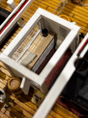

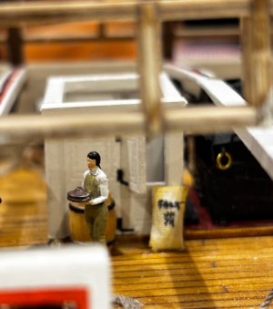

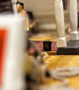

A little diversion while I’m waiting for some paint to dry
Years ago when I was building another Victory kit I sourced some small brass buckets that turned out to be too large in scale, but I went to the trouble of making some GR cypher decals for them. I came across them the other day and decided to place some around the ships pantry with some sacks
Hey Alan,
Wow, that looks great. May I ask how big these letters are and where you had them made?
By the way, the figures look very nice. Are these the figures from AL for Victory?
Hey Alan,
Thanks Gunter
The whole cypher is probably about 2mm high. I made them myself by copying the cypher, reducing it in size using desktop publishing software and printing a batch of them onto clear decal paper in my printer
Yes they are the AL figures although I had to adapt the one sitting down
