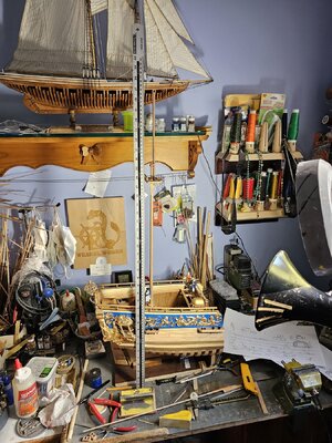

Hello Ship Mates, Last night the little fellows and I glued the cheeks on to our mizzen mast. This AM we dry fitted on the previous built mizzen platform and it looked good but when we dry fitted on the mizzen top mast [ un tapered ] it was an hoarer story. This is when the Admiral Bernadette and I realized this would never do. With the Mizzen top mast close to 37" or 940mm and to add sails to this would be just too much.
We welcome any feed back on this situation, please speak freely, other wise the sails on our YMY Fubbs is out of the question, it is too bad that I could not see this in advance, just had to have sails.

Good afternoon Lawrence. My approach would be to exclude sails. I personally feel it would look out of place on a section build. Once the shrouds, booms, yards and associated rigging are attached the look and feel will add to an already impressive section build. My 2 cents. Cheers Grant

Hello Grant, Thanks for your suggestion, I am still up in the air as to know just what to do! I believe that I will leave it ride for a few days before deciding what to do.

Hello Ship Mates, Well after a lot of thought and a lot of reconditions that all were good and well worth considering the little fellows and I have decided to reduce the over haul mizzen mast height by 1/3. This looks very good to us the only fly in the ointment is the mast palatiform is a bit over size. This matter I will pass along to my ship mates, [Do I keep it or do I build a smaller platform?]

Good morning Lawrence. Eish a difficult one. Once again I think it comes down to builders preference. What I would do (although difficult to access from photos only), is one of two options. I personally would not change any scale aspects of the build. Your hull etc are so good and accurate.
1. I would leave off the mast and rigging and just display it with mast stump or
2. I would keep to scale and present standing rigging only. May look weird however the accuracy is maintained?

Hello Grant, I do thank you for your honesty, This has been a difficult decision for me to make. All though the mast are not true to scale I very much like the new look. My Admiral Bernadette and I do want to add a set of sails, some how just the mast stub just will not do it I also wanted my my ship to look just a bit different. Some how my picture just dose not justify the new look, yes not true to scale but then again I can live with it.

Hello Ship Mates, The little fellows and I have run into another road block in our HMY Fubbs. We wanted two Mizzen Shrouds and one Mizzen Back Stay. We built her as such but when we added the Back Stay it lay across the after end of the mast platform. So we stripped it all back down again and built her with three Mizzen Shrouds. This was due to the over haul mast shorting.
