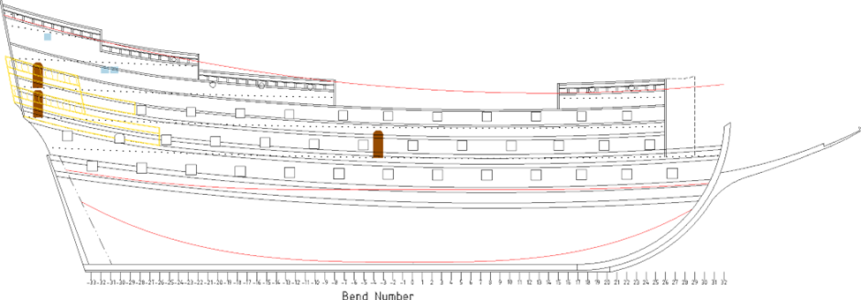

if you are wondering if the Sovereign was built to be looked at (as well as being a very powerful warship) the answer has to be a very definite yes. In that time the Navy and its ships were regarded as the monarch's personal property, and part of their function was to reflect and magnify the monarch's power and prestige. The fact that even now, almost 400 years later, we are still talking about her, is testament that this was successfully achieved with the Sovereign. She was talked about then because she was designed to be an object of admiration, with her lavish decoration designed solely for display. What other purpose would this serve that could lead to such expense being considered worthwhile?
She was certainly, within a few years of her launch, considered to be a tourist attraction; and in later times there is ample record of a small industry which grew up around handling visitors, extending as far as squabbling over how the money they paid should be divided.
Regarding the entry port, I am dubious that she was built with this feature. The first evidence for its existence is the Van de Velde portrait showing it on the port side. Nor am I aware of any earlier portrait of a ship which shows an entry port (I would be happy to be corrected in this!) Sir Henry Mainwayring's dictionary, which dates from the 1620s and describes several methods of entering a ship, makes no mention of an entry port. To my mind, this is reasonable proof that they did not yet exist, although three-decked ships did. My personal belief is that the entry port was added during the Commonwealth or Protectorate periods, although there is no evidence of this occurring. I also believe that the fact that there is no entry port shown on Payne's engraving should be regarded as supporting the absence of such an item when she was constructed; which is the easiest way to deal with its non-portrayal here, and then needs no explaining away.
Ratty
As later ships had entry ports built in during initial construction, and the king did indeed expect to spend time on her, hence the Kings Cabin... does one expect the king of the realm to clamber over the bulwark by climbing a cargo netting thrown over the side of the hull?
Someone did note a theory of the entry port being built as a means to "protect of the modesty" of the ladies from having to clamber over the side via climbing the cargo net. If the navy would have done such expensive alterations to such an expensive ship, they would have done it at the start.
Besides, wouldnt the installation of the entry port damaged the priceless gilding?

The truth of the matter is that certainty over the dating of entry ports is not possible in the present state of knowledge. I have a picture of a Van de Velde drawing of the 'Constant Reformation', dated 1648, in which she clearly has an entry port on her port side, so they were in use by this time. Tball's comment that they might have been introduced to protect ladies' modesty is charming, but most ships were not visited by women, except on rare occasions, so this must remain unproven.
Henry Mainwayring in his dictionary only mentions 'entry ladders', which he describes as being used to access the waist, and having ropes on each side to hold onto. This name and design lasted as a concept for at least the next two hundred years, alongside entry ports. It is perhaps pertinent to remember that the substantial tumble-home of a 17th century ship's side meant that a good part of the climb was far from vertical.
My own belief, and I stress that this is only a theory, and has no basis in fact, is that entry ports were introduced during the Civil War period, when large numbers of soldiers became both Admirals and captains. Admirals were known as 'General-at-Sea', and were not at all accustomed to sea-faring. It is possible that their complaints led to the adoption of an easier entering system.
I for one do not believe that the Sovereign was built more as a floating attraction. She was built to project power, which she undeniably did very well when in service; and to reflect the king's prestige. She became a tourist destination more by default of any other purpose whilst she was laid up in Ordinary, than from any deliberate intent. We have no idea what kind of active career Charles intended for her, as shortly after her launch he became embroiled in the Scottish rising which soon developed into full-scale war, and his navy perforce had to take second place.
It would also seem to me most unlikely that Payne would miss something as obvious as an entry port were one in existence. He does show many much smaller details. We will have to agree to disagree on the entry port, methinks!

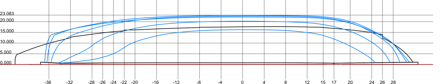

The Rising Lines (continued)​
The Aft Lower Rising Line​
The aft lower rising line, which the Treatise calls the aft rising line alow, is also called the aft lower rising line of the floor. To simplify a what can be a lengthy discussion, we only need know that the Treatise tells us that the line ends at the “tuck.” Its ship has a square tuck stern, so its line ends at the post. The Sovereign had a round tuck stern, so when Pett gives us the “height of the tuck at the fashion piece,” we can infer that the rising line ends at the fashion piece. Pett’s listed “height of the tuck at the fashion piece” is 16 feet. This is substantially different from the height the Treatise would have us use (⅔ the depth, or about 12 feet 10 inches on the Sovereign), and is one of several substantial differences between the Sovereign and the Treatise that we find at the stern.
Notice that Pett gives us both the height of the gripe and the height of the tuck. The line’s height at the midship bend is understood to be at the floor here. Therefore, Pett is giving us a considerable amount of information about the entire lower rising line.
This line’s height affected how the water flows around the rudder. As explained by Mainwaring (52 p. 215):
“We say a ship hath a good run when it is long and comes off handsomely by degrees, and that her tuck do not lie too low, which will hinder the water from coming strongly and swiftly to the rudder; and a bad run whenas it is short and that the ship is too full below, so that the water comes slowly and weakly to the rudder, the force of it being broken off by the breadth of the ship alow, which will make (as it were) an eddy-water at the rudder and that we call a dead-water.”
As the aft lower rising line moves forward from the tuck, it, arcs downward until it reaches the midship bend. The Treatise captures this downward arc using a cubic function that is computed just like the function for the fore lower rising line, except that the height and bend of the tuck are substituted for the height and bend of the gripe. As the Treatise’s author explains, a cubic function is used because it “maketh a line which runneth along by the touch and by that means keepeth the water under the bilge of the ship, yet tucks up severally both afore and abaft, which gives life and quickness to the ship’s way….”
I have I have corrected for deadrise when computing this line. Recall from a previous section that the position of the fashion piece is speculative.
The red line in the figure below shows the entire lower rising line. Notice that it includes some details I forgot to include in the sheer plan posted earlier.

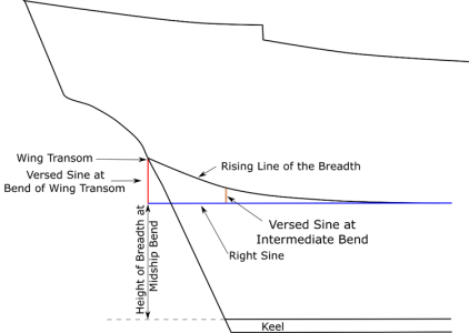

The Fore and Aft Upper Rising Lines​
This section discusses both the fore and aft upper rising lines. These lines tell us how high the widest part of the ship is at every bend.
The Treatise refers to the upper rising line as the rising aloft. It is also called the rising line of the breadth. This line’s fore and aft parts both have a straight and a curved part. A straight part is incorporated because the line will rise too much if a single, simple arc is used. As its author explains; “But because every circle doth raise the breadth in the quarters somewhat too high where it should be kept down to bear with the luff, the best way to help this defect will be to carry the breadth from midships by a straight line near ¼ of the keel each way….” The result is that the line is flat for about one half of the keel’s length.
The curved parts of the fore and aft lines are both parts of a circle. The heights of points along this circle are calculated using trigonometric quantities the Treatise refers to as the versed sine and the right sine. Figure 75 illustrates how these two sines are used to compute the aft upper rising line. The versed sine’s length tells us how much higher the breadth is at any given bend than it is at the midship bend, where the versed sine’s length is zero. The right sine tells us how far any given bend is from the midship bend. For example, the right sine is relatively long at the wing transom because it is relatively far from the midship bend. The versed sine is also relatively long here, so this tells us that the breadth is higher here than at the midship bend. Both sines become progressively shorter as we move from the wing transom to the midship bend.
Figure 75. Using the Versed Sine to Compute the Aft Upper Rising Line’s course.
1757345821818.png​
Note: Figure not drawn to scale. Among other things, the curvature of the rising line is exaggerated for the purposes of illustration.
Calculating the course of the line aft of the midship bend is straightforward. It involves using the Treatise’s method to construct a line that runs from the wing transom to the height of the breadth at the midship bend. We have already determined the post’s height and, since this is also the wing transom’s height, we know where the line’s aft end is. Phineas Pett gives us the height at the midship bend.
Things are more complicated for the line fore of the midship bend. The Treatise’s method probably does not work for finding the height at the Sovereign’s bow,[1] so I rearranged its proportional rules for calculating the post’s height and the height of the breadth at the bow to express the height of the line’s fore end as a proportion of the height of its aft end. I then added an additional 3.85 inches to the height of the line’s fore end because the lower rising line’s fore end (i.e., the height of the way forward) is 3.85 inches higher than the Treatise would have us make it. This addition maintains the space between the upper and lower rising lines that the Treatise would have us use. The result is a fore height of the breadth that is four inches above the bottom of the upper main wale. I stress that although this line is derived from the Treatise, it is obviously a guess. It would be reasonable to place the line as low as the bottom of the upper main wale, or as high as this wale’s top. Lower may be preferable to higher. There is some evidence that the breadth was lower in early 17th century ships, and was only made higher later on, perhaps because the beakhead bulkhead was moved forward at this time. (Endsor, 2020, p. 165)

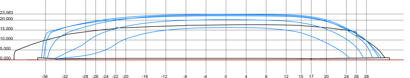

The Toptimber Rising Line​
The toptimber rising line helps us draw the toptimber sweep on the body plan. This line does not does not locate the actual tops of most of the timbers.[1] It is only a guide used to draw the upper parts of the bends.
Shipwrights only rarely (if ever) drew a toptimber line on their plans. The Treatise tells us that it is not “needful” to do so. The toptimbers’ actual heights were what was drawn on plans.
Some contemporary sources do not even mention the toptimber rising line. It is not mentioned in John Smith’s “Sea-Grammar” from 1627, (Smith, 1627) or in Sir Henry Manwaring’s “The Seaman’s Dictionary” published in 1644. (Mainwaring, 1644) Deane also does not discuss it. The toptimber line may have received such cursory treatment because shipwrights felt that it had little, if any, effect on the way a ship sailed or steered.
The Treatise’s author only gives the toptimber rising line passing mention. He merely says;
“I might here add a third rising line for carrying the top timbers, but because the proportion of double the depth set off from the breadth line upon every bend doth very well direct the same, it shall not be needful to draw any other line.”
Bushnell[2] only tells us that the line is “drawn from the top of the Poop to the Fore-Castle,” without mentioning whether the line is straight or curved. Regardless, this results in a line that is above many of the bends.
The Treatise’s would have us place the toptimber rising line at twice each bend’s depth. This does not work well for a ship as big as the Sovereign. One difficulty is that it ultimately leads to a roundhouse that is too narrow to accommodate the stern decorations. Therefore, I have used a version of Bushell’s line, drawing it as a circle that runs from the top of the foremost bend to the top of the aftmost one.
The figure below shows the toptimber rising line.

The fore upper narrowing line (also called the narrowing line of the breadth) tells us how wide the widest part of each bend is fore of the midship bend. The Treatise’s author tells us that “the narrowing aloft forward must be on a fuller line than the narrowing aft, that it may run longer in the touch to keep out the bow to bear with the quarter and that it may round home suddenly to the stem…” Contemporary thinking also held that bluff bows allowed ships to float higher in the water than ships with a fine bow, and this allowed for more (or heavier) cannons to be mounted forward. Also, a bluff bow was thought to keep the ship dryer.
The Treatise’s method involves raising each bend’s number to the fourth power. This probably does not produce a bow that is round enough for a 3-decked ship. These ships tended to have bluffer bows than the 2-decker the Treatise describes. (Fox) Further, plans ostensibly drawn by Phineas Pett for the Phoenix (1613) (Porter, 2023) suggest that Pett preferred a rounder bow than the Treatise’s author would have us draw. Therefore, I have raised the bend number to the fifth power. The Sovereign’s bow could plausibly be made even rounder.
Changing the power is not as capricious as it sounds. When the shipwright Jonas Shish designed the Tyger, he computed the narrowing of the fore upper narrowing line by using the Treatise’s method, but raised the bend number to the second power. (Endsor, 2020, p. 120). This created a ship that was sleeker than the Treatise’s ship or the Sovereign.

Raising and lowering the anchors was assisted using catheads, which are timbers that project from the ship. The catheads can be seen on the Payne engraving and the van de Velde drawing, where they appear to be supported and stabilized by a decoration that acts as a hanging knee. Catheads needed to be as short as practicable. Longer catheads are more easily ripped from their moorings than shorter ones. Longer catheads are also more likely to bend or break. A good way to keep them short is to make the ship wide near them. This is partly why the forecastle’s fore ends on models of the Sovereign and other 3-decked ships of this era flare out. This flaring often produces a deck that is a little wider than the ship’s breadth here, which is the case on the present plans.
I obtained a realistic forecastle by using the same method used to compute the aft upper narrowing line, and by raising the bend number to the same power used to compute the fore upper narrowing line (i.e. the fifth power). The advantages of this are that it gave me some control over the width of the forecastle’s fore end, and that it employs a curve whose shape conforms to that of the fore upper narrowing line. There is certainly no guarantee that this is the method Pett used for the fore toptimber narrowing, but it is at least a method available to early 17th century shipwrights.

Although the widths of the ship at the bends’ tops narrow as they move away from the midship bend, these widths were not directly determined. They are a byproduct of how the toptimber rising and narrowing lines are constructed.
On the other hand, the heights of the bends’ tops were not the product of any rising or narrowing line. They were determined by the individual shipwright’s desires, and there was considerable variation in how they did so. Deane explains, that these heights are drawn according to “no certain rules,” so the timbers were drawn “as the contriver sees fit.” Mungo Murray’s treatise from the mid-18th century tell us that “The heighth [sic] of the breadth line of the top timber […] is limited in midships by contrast, afore and abaft only by the fancy and judgment of the artist, according to what sheer he designs.” (Murray, 1754, p. 134) We can determine the heights of the bends on the Sovereign from the heights of the rails that run along each bend’s top.
This completes the section on the narrowing lines. The waterlines that result from them are shown in the figure below. As noted previously, early 17th century shipwrights did not use waterlines. I show them because the narrowing lines these shipwrights drew are difficult to use to build a model of a ship. Indeed, a major purpose of their narrowing lines seems to have been to help them draw the body plan, which we will turn to next.
Note: Waterlines are at heights of 5 feet 4 inches, 10 feet 8 inches, 16 feet 0 inches, 21 feet 4 inches, and 24 feet 2 ¾ inches above the keel. The latter is the height of the wing transom from the keel’s top. The numbers at the left of the figure are feet of width, and those at the figure’s bottom are bend numbers. The midship bend is bend 0, and bends aft of it are denoted by negative numbers.
