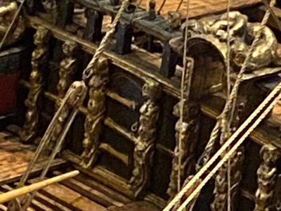

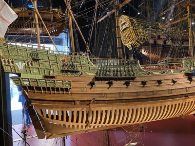

i came across this pic online of the SOS, lots of detail but what intrigue me is the external access to each deck via internal stairs only , how accurate would that be , cos i cross reference other ship around that period and none does that
ref . navy board ship model 1650/1750 john franklin and i live near by the greenwich maritime museum uk
i am using the deagostini model as the base but with massive rework from all your reaseach which as so much appreciate , huge amount of research and i am so greatful to camoe across all this
Hi Barry;
Thanks for the pictures; I can safely say that there is no evidence for internal stairs running up from the bulkheads in the Sovereign. This does not mean that they did not, although that would be very unusual: I have never seen any such stair on any early models, nor on any surviving draughts or artworks.
Payne's engraving of the SoS shows a ladder used to access the aftermost poop deck, which does not appear to do anything more than rest on the top of the bulkhead. Van de Velde's later picture of the Sovereign, although not accepted by all as being a true representation, does show fitted, curving stairs with short gangways to access this deck, which was certainly the case with other ships later in the century.
