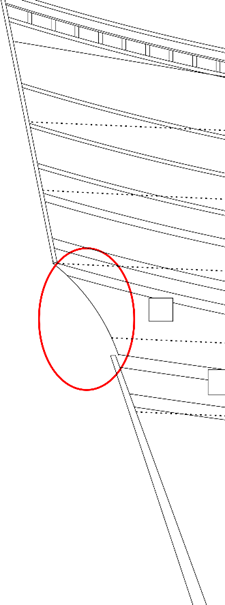

The current plans use a modification the Treatise’s method. Thus, a radius of 11/10 the depth, or 21.15 feet, is drawn from the post’s true head (but accounting for the rabbet’s width here) to the underside of the upper gun deck’s planking. Figure 62 shows the counter circled in red.
Figure 62 The Counter
1740852597834.png​
This design ultimately causes all the weight of the upper stern to rest on the wing transom. This represents a weakness in seventeenth century ship design that persisted for quite some time. Because there is so much weight on this transom, it carries an “unduly heavy workload for a single timber.” (Lavery 1984, pg 34)

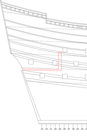

The Sovereign was built before the invention of the ship’s wheel, so it was steered with a tiller and whipstaff. A whipstaff is a vertical pole that was attached to the tiller. The helmsman moved the whipstaff from side-to-side to move the tiller which, in turn, moved the rudder. The helmsman faced forward. The tiller rested on a horizontal wooden bar called the tiller sweep, which was sheathed in metal and coated with soap and grease to minimize the drag of the tiller as it rode across it. The whipstaff was connected to the tiller through a pivot point called the rowle.
We can approximate where the Sovereign’s whipstaff joined the tiller from the position of the 12th gun port on the middle gun deck. It appears to have been moved so the gun arming this port would not recoil into it (see “Gun Port Spacing”). The whipstaff likely ran from just under the middle gun deck to the upper gun deck. (Fox, Personal Communication) This made the Sovereign’s tiller and the whipstaff rather long. This is desirable. Both act like levers, and less force is required to move a longer lever than a shorter one. This harks back to Archimedes’ statement “Give me a lever long enough and a fulcrum on which to place it, and I shall move the world.” The difficulty is that when a ship becomes very large, it is impractical to make the tiller long enough. This likely encouraged the adoption of the wheel on larger vessels. (Reid 2016)
Figure 63 The Tiller and Whipstaff
1740852674716.png​
Note: The red dashed line shows the space available for the tiller and whipstaff , and does not portray their actual thicknesses. Both could be thinner than the portrayed spaces. As on a real ship, there is little room for the tiller, so some may find it convenient to reduce the thickness of the middle gun deck’s beams beyond the 12 inches described in the previous section on the midship bend.

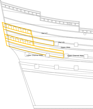

The Sovereign’s upper and lower galleries align with the wales and rails in specific ways. (Figure 64) The lower channel wale is at the lower gallery’s bottom and the upper wale is at its top. The upper wale and seventh rail similarly align with the bottom and top, respectively, of the upper gallery. Since the upper and lower quarter galleries are the same height, the distance between the lower channel and upper wales must equal the distance between the fifth wale and rail #7, and all three wales, as well as rail #7 must be parallel. Finally, the rails of the lower quarter galleries wrap around the stern, and these must be placed to align with the upper gun deck’s stern chase ports. This will be further discussed in the section on the stern. Additional details about these rails will also be provided in the next section.
The Treatise’s ship has one quarter gallery whose length is one sixth the length of the ship. [1] This works out to be 28 feet 10 inches on the Sovereign. The Sovereign’s galleries are longer. The lower quarter gallery is almost 35 feet long with its extension, and the upper quarter gallery is a bit less than 32 ½ feet long.[2]
The Sovereign’s quarter galleries, like those of other ships of its time, are set at an angle. Many models of this ship mistakenly portray them as horizontal. The Pett painting shows that the lower quarter gallery starts on the middle gun deck and ends on the upper gun deck. The associated stern windows serve the highest of these two decks. Similarly, the upper quarter gallery starts on the upper gun deck, and ends on the half deck, and its associated stern windows serve the latter deck. The Pett painting is not the only source to show that the galleries slope upwards as they move aft. The Payne engraving shows it, too. The Treatise tells us that the gallery’s should rise by one-fifth of their lengths. This is about how much the Sovereign’s galleries rise.
The galleries’ rises are not captured by a painting commonly used to model the Sovereign’s stern.[3] This painting, “Peter Pett and the Sovereign of the Seas” (which will be provided in the next section shows the galleries as horizontal. This is one of several errors in this painting (its other errors will be discussed in the next section).
Figure 64. The Quarter Galleries
Note: As previously discussed, the top of the middle gun deck’s second-from-aft port is comprised of an arch in the gallery floor. Accordingly, this port, which I previously drew as square, is now shown as arched. Note also that the galleries project aft of the plane of the upper stern. This mimics the Pett painting.
