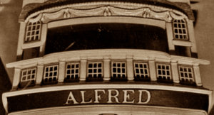

Dave am not sure were the roof over the balcony came in to play and I thought we was talking about the balcony itself.
yes we were talking about the floor of the balcony itself I just mentioned the roof because it too has to extend out.

sorry Dave the roof over the balcony doesn't extend out and doesn't go any further then the side counter timbers see post 121. What sticks out past the side counter timber is the taffarel, which attaches to the poop deck deck transom and holds most of the carving. The roof over the balcony is really the bottom of the poop deck above. Gary
oh! ok your right it is not a roof over the balcony i see what you are talking about.
sometimes stupid just happens I know better thanks for that slap WAKE UP!

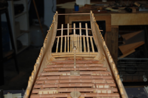

found an image before the balcony rail was installed. It appears like Harold simplified it by just adding one solid sheet for the balcony floor and my guess he glued the rail to the edge. Behind those pillars would be the stern timbers cut off at the floor height and filler blocks added between the timbers.
As for how it really was done is still a guess which I think it was the deck planking run out to the edge of the molding, but if that was done there still had to be something that tied all the ends of the planks together. I doubt that molded edge was cut into the ends of the deck planks.

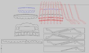

this is the file for the stern timbers
notice on timbers 1 , 2 and 3 there is a cut in the profile of the timbers leaving only a thin area. This is because those timbers are cut away at that location. I left the top joined to the botton until the two upper transom pieces are fit.
The top view of the transoms show the notches for the timbers and the side view shows the arc. These pieces present a problem for laser cutting, the top view is no problem but the profile arch requires stock to be 1 3/8 thick to cut that arch.
The stern itself can be cut from thin plywood or solid sheet stock.
You lost me a little bit on that statement? Are you saying the stock for timber parts 1, 2, 3, and 4 need to be 1 3/8" thick? If so, not biggie. Either just CNC them or laser them in 2 halves and glue together.
the stock for the stern timbers is 3/8 thick that is for parts 1, 2 , 3 and 4
in the drawing to the left of the red stern drawing are the transom pieces and here they are in place. In the first picture you can see they arch. when you go back and look at the drawing the side view shows the arch. In order to cut that arch in the lower (black) drawing of the transom you need stock at least 1 3/8 thick
Dave what about putting a joint in the stern timbers right at the quarter deck transom because they have to be cut off there any way and it would save on the width of the timber. Gary
what Harold did was built the stern with the timbers as one piece then after he added the transoms and stern then he cut away the yellow section of the timbers. What i did was draw the sections that are remover smaller which would locate exactly where the two transom pieces will go
I see what you are saying now Dave. Curious, how thick are the transom parts? Can't the arch be shaped over a former from a flat piece? If not, I would just fab the transom part by CNC if this were for a kit. Other option would be to laser the notches on thinner wood, glue them together, and then use a former. Heck, multiple solutions... LOL.. easy stuff.
