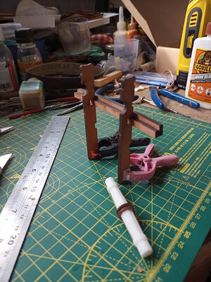

Due to the fun and games with my foredeck and supports and my decision to increase the galley deck, I've moved on to assembling and trial fitting of the windlass supports to make sure it all goes together OK and It looks like I won't have any problems. Thumbsup
However there looks to be a problem with the cut out in the windlass supports X10 and part M1b. The cut out in X10 for M1B is about 5.5mm deep but M1b is cut from a 4mm sheet leaving an ugly gap:
I know it's not catastrophic (there are lots of things we could do to hide this) but I think Victor and Co need to alter the laser cutting app for future kits.
Unless, of course, there is another reason for the gap????
Tom
