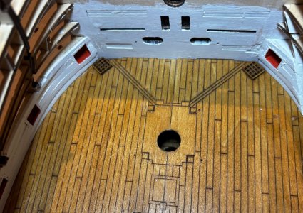

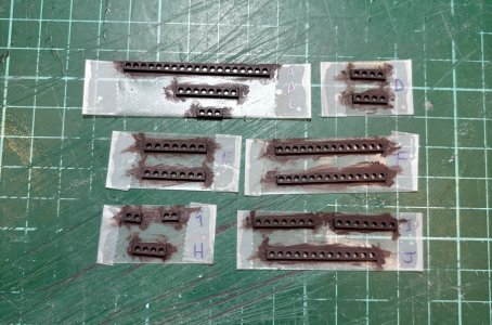

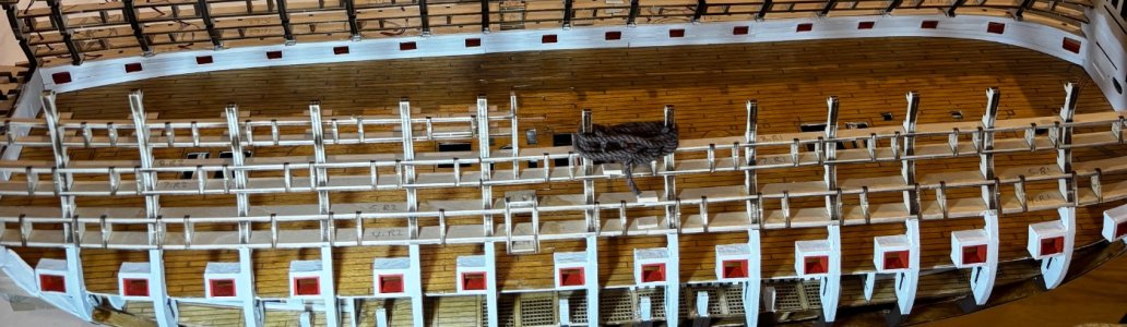

Instructions Video #17 completed
Well, that took a lot longer than I expected

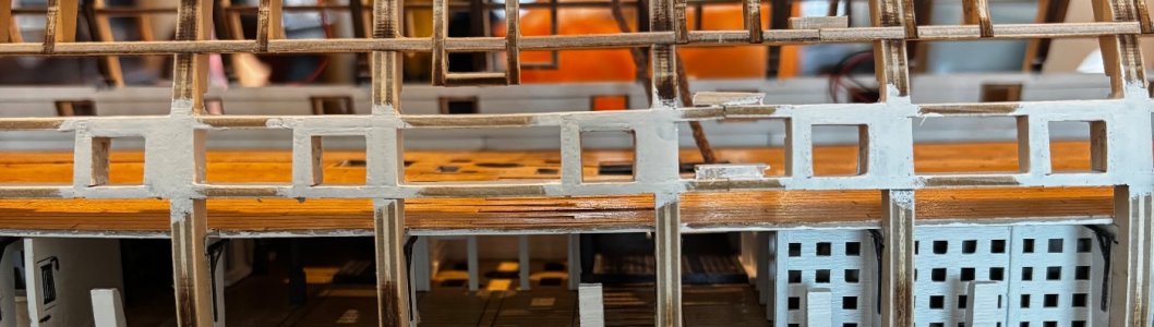

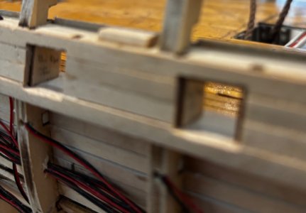

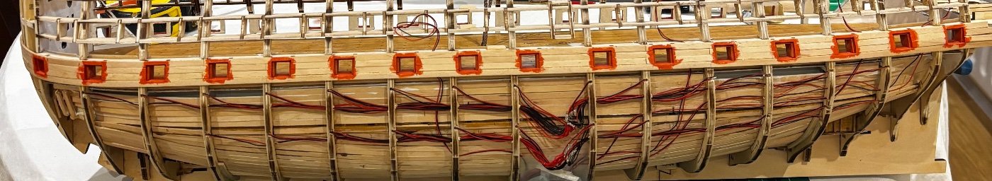

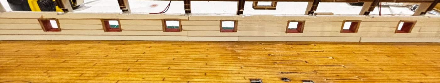

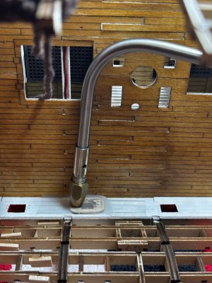

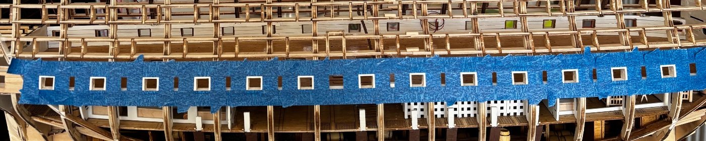

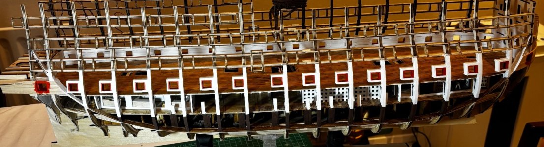

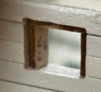

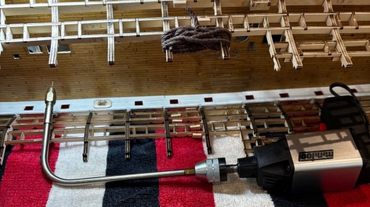

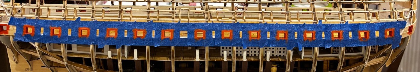

Apart from the slow progress due to hand pain as previously mentioned, the masking, painting and touching up of the gun ports took some time. I ended up getting 1.5mm hard wood strip to bring the gun port linings flush with the internal planking (sanding down as required) A couple of things I did that were not done in the video, I filled the gaps on the 2 or 3 gun ports that were not directly touching the upright framing and also painted out the framing down to the hold, making a change of colour from white to brown at the line of the orlop deck. I contacted AL regarding the make etc of the small chuck and extension bar they used for drilling gun tackle holes from opposite side of ship, but thus far I have no reply, but searching through my modelling tool boxes for a short pin vice I found a 90 degree angled bar with a hex drive at one end and pin vice at the other, which made light work of drilling all those holes Thumbsup
Hi Akan
That's an interesting tool, don't think I've seen one like that. Masking heaven well done! Your patience is paying off.
Regards
Tony
I’d forgotten I even had it or where I got it from, It was possibly Micro Mark in the USA, I did buy quite a bit from them back in the day, but I checked their web site and it’s not listed. This is the first time I’ve ever used it in 20 odd years :rolleyes:

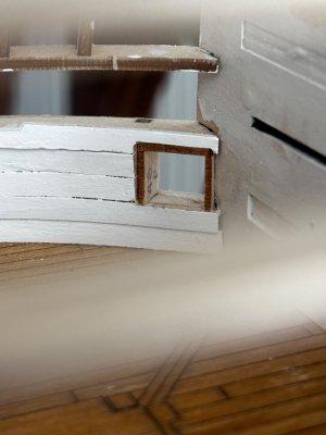

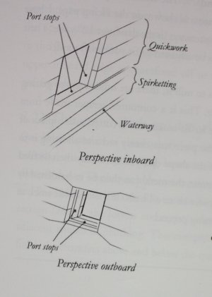

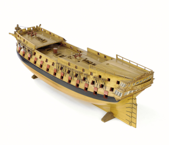

I realize it is too late now, but for the future, unlike the exterior planking, the planking of the inboard bulwarks always covered the edges of the linings/stops. This can be seen on contemporary models such as the one below made in 1800. The drawings below are from in Volme 2 of The Fully Framed Model page 69,by David Antscherl.
I realize it is too late now, but for the future, unlike the exterior planking, the planking of the inboard bulwarks always covered the edges of the linings/stops. This can be seen on contemporary models such as the one below made in 1800. The drawings belwo are from in Volme 2 of The Fully Framed Model page 69,by David Antscherl.
Thanks for the info Allan
Although I didn’t realise that’s the prototypical way to do it, that’s exactly what I ha planned to do on the next deck by fitting the linings before doing the internal planking
But that’s not how they show it in the video :(
Regards
Alan

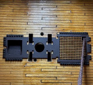

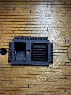

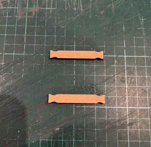

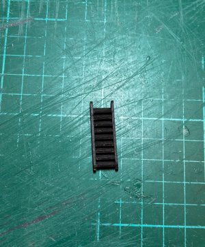

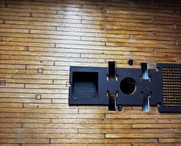

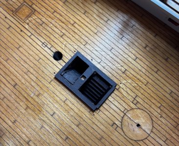

Instructions Video #18 completed
Pretty straightforward this one
Nice to have a quick easy one often the last marathon :DThumbsup
