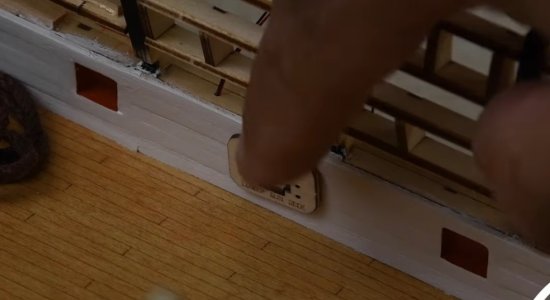

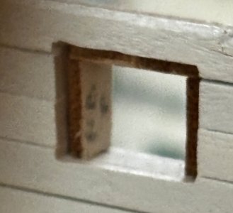

Something I’ve noticed in video #17, although the gun port linings seem to finish approximately flush with the inside of the planking on the outer hull (pic 1) which would seem to be correct for the flush fitting of the gun port lids, on the inside of the hull the video shows a flush fitting to the outer edge of the planking (pic 2). In reality mine finish flush with the inner edge of the planking (pic3)
It looks like this will effect the position of the holes for the eyebolts on the gun rigging as I have temporarily fitted the hole gig in one of the ports. How they achieved this it does not say apart from the mention of making a paste from CA glue and talcum power while showing fitting the bow most lining which actually doesn’t look set that far back
Filling all the gun port edges with filler would be a lot of work and messy so I’ve ordered some 1x1mm hardwood strip to make up the difference with hopefully minimal sanding/filling

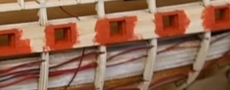

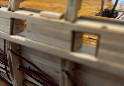

My internal and external linings are shown in pics 3 & 4
Hi Alan
Interesting. I note that at one point he seems to push the lining back with a file against his finger as if he is making it flush with the very inside of the planking?
Is there any chance that the planking on the inside of the hull should sit slightly higher than the skeleton frame work? This would then cause the lining to be flush (I think). Then this still would not explain any misalignment left and right. Having not inspected the parts this is just conjecture. With the lining parts being precut you have no play.
As for filling any misalignment with filler, that just seems way to complicated and messy.

I did think that myself but my planking is tight on the sub frame that’s why I used the plank bender on this deck , even so, on the straight sections it would be flush anyway
I did try putting a liner in so it was flush with the inside planking but that left a very deep recess on the outer side, and as you can see from pic 1, that is not the case on their model, and not how I want mine to look
The lining pieces are approximately 7mm deep as is the framing at tha level, that leaves the thickness of the planking on each side or a 3mm recess on one side.
Anyway, it’s done now so I’ll have to deal with it

I think I’ve located the parts that will be the gun port lids, they are on sheet 11 which is 1mm thick, that would make them about 3ft thick at scale which seems more likely. Take your tape measure with you in September :D
Regards
Alan
Nice work. :) Keep in mind the three pieces that make up the stops/linings in each port were no more than about 1.5 inches thick (0.5mm at 1:84 scale)
