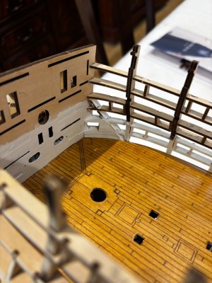

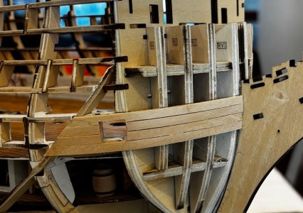

More excellent progress Alan and now I see the beam I mentioned to be cut away. What are your thoughts on the finger join approach AL have opted for the front to back decks?
Not a big fan to be honest as it gives little leeway for anything slightly out of line/ square
Think I mentioned in an earlier post that a straight forward butt joint would be easier to work with, but saying that, the lower gun deck hasn’t worked out too bad

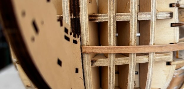

After doing the first bow plank curve I remembered I had the Amati Form-a-strip in my ship modelling tool box, much quicker as you can form the curves dry off ship before final fixing. You may also find it useful to temporarily fit the beak to more accurately mark the bow plank cut points

You seem to have nailed the curve with using the Amati Tool, good work! With the finger joints on the decks I may look at the possibility and practicability of veneering the upper decks with new individual thin strips as this is the only deck you can see in full. Not sure about this as I have not really checked out the ramifications etc. Will put that idea on the backburner. As I mentioned earlier I am continuing on with my San Fransisco build, will probably get the 1st planking done today. After a little filler, the odd ale and a hour or two of aggressive sanding she should be ready for 2nd planking. I will post a pic of my efforts in my next reply to your thread. Keep up the great work!

I'm using CA glue to attach my 1st planks to the San Fran just wondering what you are using. Yes I see from your pic temp attaching the Beak is a good idea!

Yeah, I’m using CA glue, just be careful to wipe away any excess at top/bottom of planks before it dries too hard

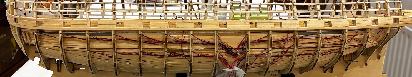

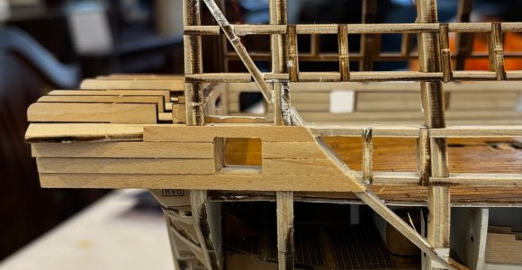

It looks like the planking of the hull on the model is following the sheer of the gun ports. The sheer line of the planking has no relation to the sheer line of the decks and gun ports. I realize this is a kit design mistake, but you can fix it if you want to. It would really not be that noticeable except that the wales, which follow the sheer of the rest of the outboard planking, will look odd. You can see the difference very clearly on the Longridge and other drawings that you posted.
Hi Allan
Thanks for your observation
I think it’s too late to change anything now without causing a lot of damage
One thing I did check early on by watching upcoming videos is that the wales do follow the correct lines in relation to the gun ports etc. Hopefully when everything is sanded down smoothly and painted it won’t be that noticeable
