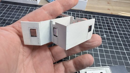

Today I painted the rooms,
A couple of coats of white paint which I let dry before a light sand and another coat, applied with an airbrush.

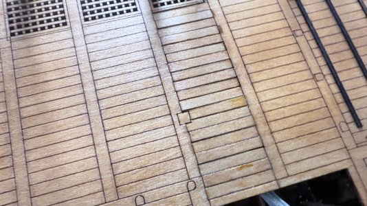

I rescribed the door frames where the paint had filled in the groove and re-puttied a couple of areas that need some attention. Tomorrow when the putty is fully cured I will give everything another light sand and another coat of thinned paint.
I blackened the door grills and the hinges and latches with AL's blackening solution. It seemed to work OK but when dry a lot of the black simply rubbed off. I may just go with the greyish colour and give them a light coat of varnish to lock the blackening in.
Thanks for looking
TJ

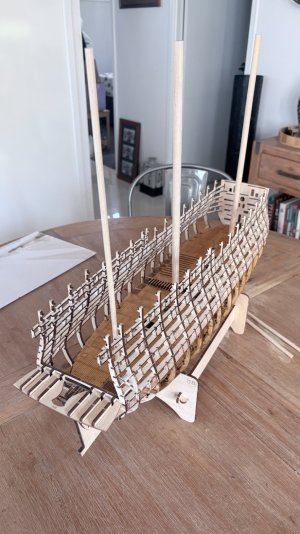

It's probably important to get the keel straight and square at this point so I'm working on a flat MDF board.
A long steel rule keeps things straight.
I believe that this point in a ships construction is called “laying the keel” and should be celebrated accordingly. Who am I to disagree?
I wanted to celebrate the occasion with an English Ale brewed in Victory’s resting place in Hampshire. But here in Australia English ales are limited somewhat. But I did manage to get a Kentish ale more than suitable for the occasion.
In a strange stroke of irony I am building the greatest fighting vessel of its era HMS Victory, whilst celebrating the occasion drinking an English ale celebrating IMHO probably the greatest fighting aircraft of ever made; the Spitfire.

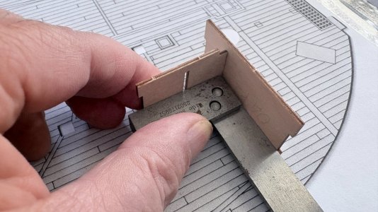

I do realise the kit comes with a working base, but for the hull construction I thought I would make something a bit more sturdy.
Each of the bulkheads fits into a slot which in turn is secured with a peg type piece.
Nearly all the bulkheads come in 3 parts with a good area of overlap to glue.
The kit supplies 3 jigs to place on the top of the frames mainly for protection when all the frames are in place. But I thought
using them to help alignment may be worthwhile.
I used a steel rule once again to ensure the parts lay very flat whilst the glue set.
Note the use of an expensive modellers tool used to encourage the frames to set square. :rolleyes:
I followed the instructions and used rubber bands to hold everything together.
The fit of the bow parts was perfect, well done AL.
The only part which I had some trouble getting to fit was part RH7 which needed a bit of clamping. This was mainly due that this parts
needs to bend slightly.
Well that's as far I got on my first day and still lots to do on Video #1 :eek:

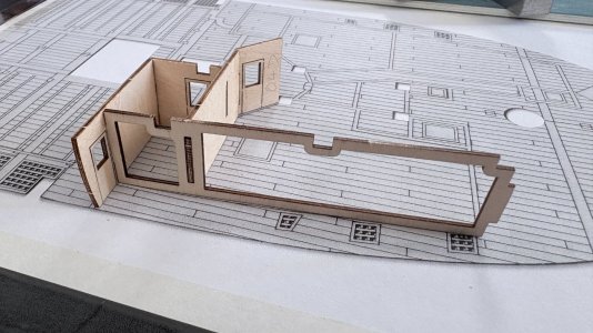

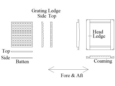

Sorry Tony, Picture below should be easier to explain than words. For some reason, AL has never been very diligent when it comes to designing a kit compared to high quality kit makers like Vanguard and Model Ship Dockyard. Keep in mind very few things were exactly the same from ship to ship. On modern day Victory the battens run athwartships on the carpenter's walk gratings for some reason. Anything seems to be possible from the days of sail.
Allanr

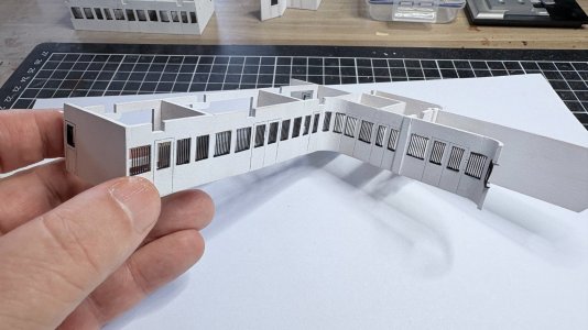

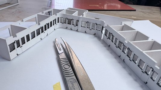

Video 8 - (Complete)

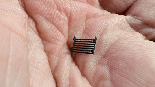

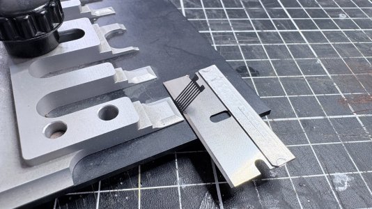

Here I am again with my love/hate relationship with PhotoEtch Redface I knew this was going to be fiddly but those hinges and latches were like teaching a hippopotamus to play a banjo... challenging. Can I suggest if you are new to PE or you struggle with really tiny pieces you may wish to give those hinges a miss.
Anyway just one 'TTT' (Tony's Top Tip) for those who are going to attempt the PE. When folding the tops and bottoms of the door grilles it's best to use a PE folding tool, this will give you a crisp sharp bend. Secondly, you have to be very accurate where you fold, it MUST be right on the area where the bars meet the folded top and bottom. If you are not accurate with the bends then the grill will be to small leaving a gap, if to long then you are in big trouble. As I found out on a couple of grills if they are slightly too big then there is the tendency to force the grill into the hole. Let me tell you, these PE parts are extremely bendy, too much force and they buckle badly.
My folding tool.
I placed the parts in place then applied a small amount of CA at the back of each part.
Thanks for looking.

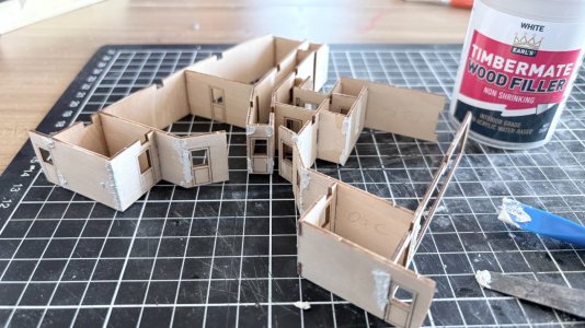

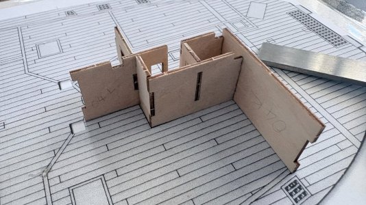

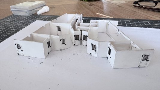

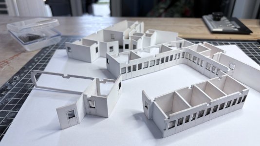

Video 8 - (Part 2)

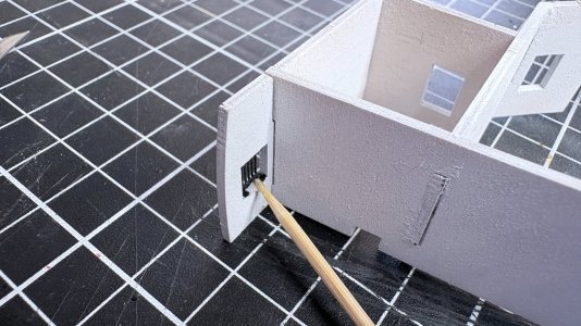

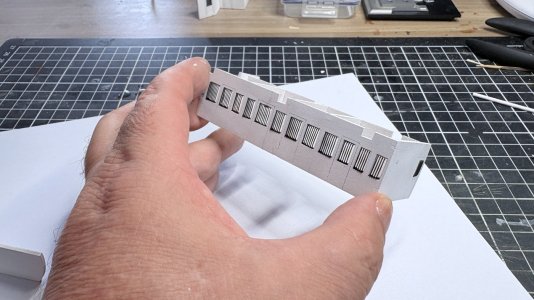

Thanks for looking
TJ

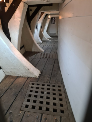

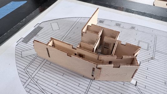

The rooms are all for various types of storage etc or personal cabins for the carpenter, purser and surgeon, also a carpenters store and work room. As far as I’m aware Victory didn’t have cells, offenders were punished usually by flogging in front of the ships company and in very severe punishments would end up on the orlop deck in the sick bay

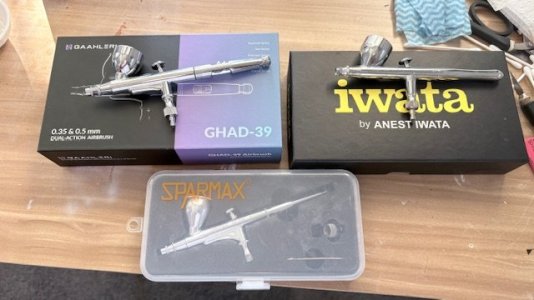

Hi Mike
I have 3 main airbrushes which I use for different purposes. 0.35mm needle for fine work, 0.5mm needle for larger coverage and one which I use specifically for metal paints like aluminium (or is it aluminum). ROTF
My latest one is the Gaahleri GHAD-39 which I got from Amazon for $70 AUS ($50 US). It's the cheapest but really good. You get two sizes of needles and I recommend it for a beginner.
It's actually the one I've been using on the Victory.
The Iwata airbrush is a more mid range price.
Airbrushes come to two main flavours; single action and dual action. Single action simply means which you pull back the trigger paint comes out. Dual action you push down for air then back for paint. I would strongly recommend a Dual Action Airbrush as you have heaps more control.
There are heaps of instructional videos on the interWeb. So give it a go they are a really good tool to use.
Best of Luck!

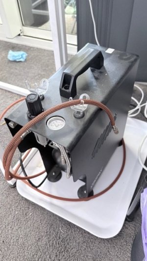

You will also need a compressor. This is my Sparmax 610 but you really don't have to start off as expensive. A small one like the one I have shown here will definitely suit your purposes.
Hope this helps.

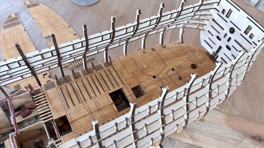

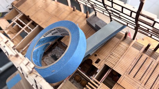

Video 10 - (Part 1)

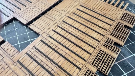

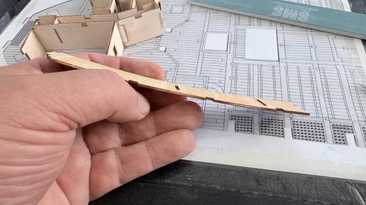

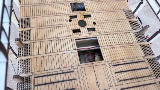

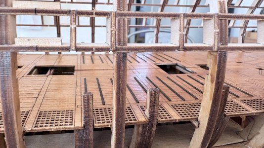

Installing the spars on the deck, then attaching the actual deck. It's been well documented by others that the finger joint approach used by AL is less than ideal. At one point I did consider attaching front right to back right, just to concentrate on getting a good join, but decided in the end that it may not give me enough wiggle room if there are alignment issues. Plus I may break the join bending the whole assemble engaging the small tabs front & rear.
I did employ some rather unusual cantilever techniques to persuade the joints to align flush. The results although not perfect were better than I hoped for.

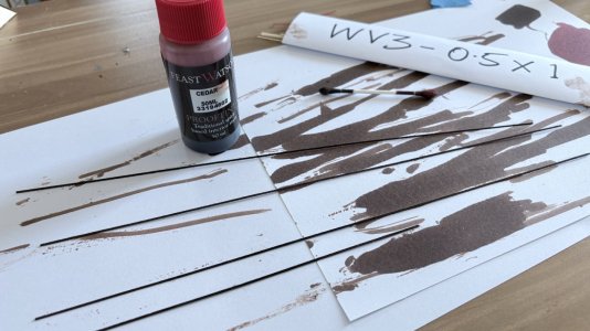

I used stain for these parts, intending to use it where AL 42 Dark Red Leather paint was used. However after some experimentation painting two adjacent colours (for example the two colour grates) I found I was getting bleed issues. I really don't want to buy any more paints as I have lots already, so I will mix my own brown colour from my Tamiya supply.

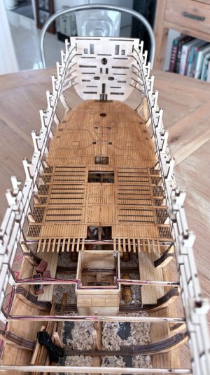

Loose test fit.
Everything OK withs masts so far. No doubt the next deck will show any issues.

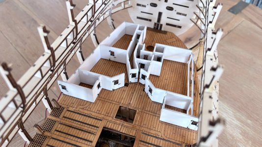

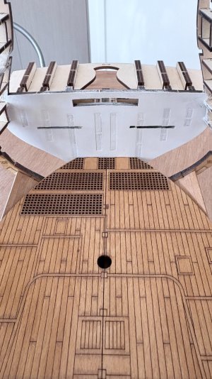

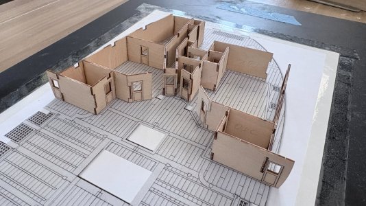

Quick peek at some of the rooms in situe.

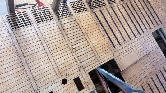

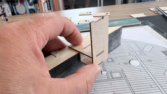

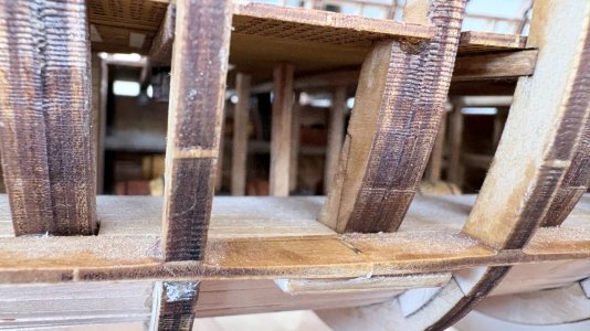

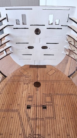

After much pushing up and down and wiggling this way and that, I found that if I stood on one leg put my finger in my ear and adopted some less than conventional techniques I could just about manoeuvre the fingers into a decent position.
As you may see from the image above I concentrated on the top 8 or so fingers then flooded the area with diluted wood glue, wiped off the excess and let it dry for a few hours.
Then repeated the process for the remaining fingers. Yes it's a long process but IMHO worth it.

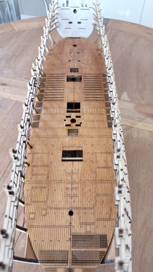

The deck in place.
Very happy with the final results.

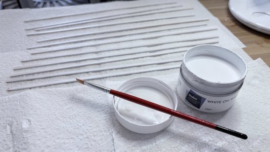

The timbers for the inner planking painted white. I used a sample pot of house paint which gives great coverage. Once this is dry and I have a had a beer I will give them a light sand and apply a thin second coat.
Thanks for looking
