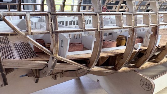

Video 12 - (Complete)

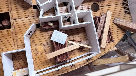

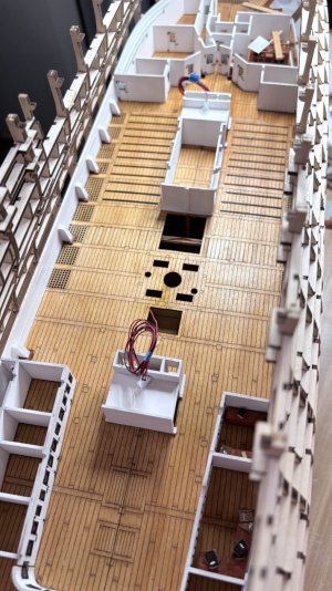

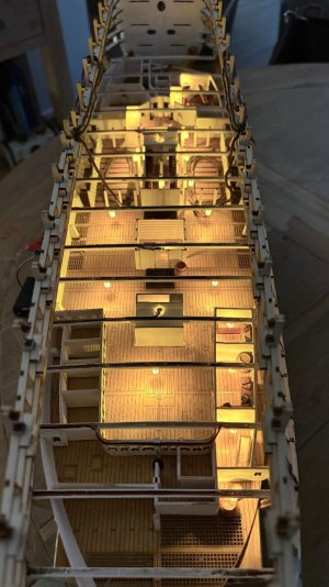

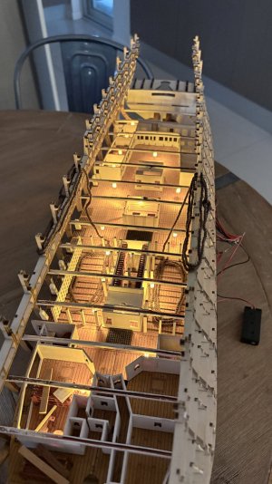

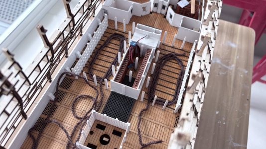

More assemblies for the Orlop Deck.

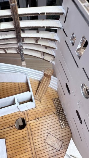

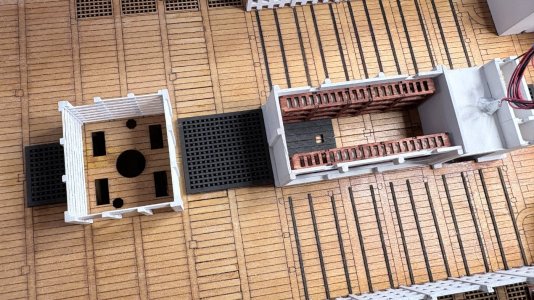

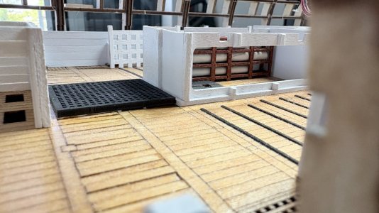

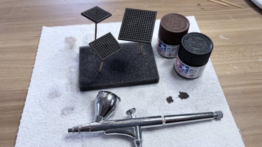

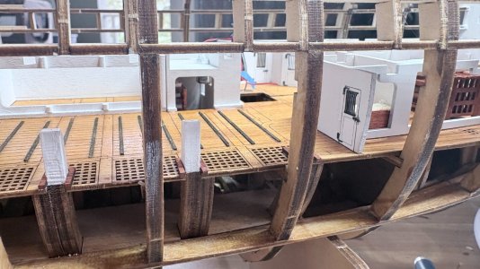

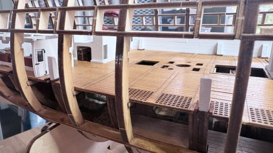

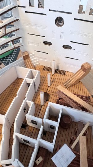

These first two pics should have been in Part 11, they just show the process of filling and sanding.

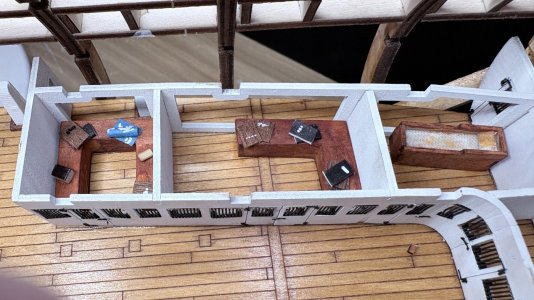

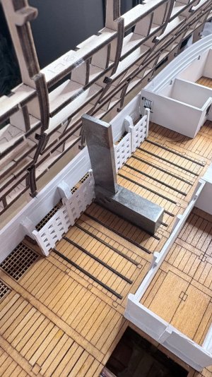

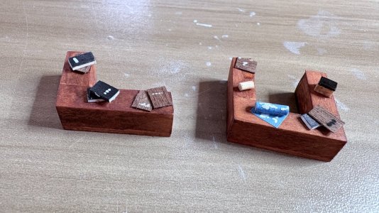

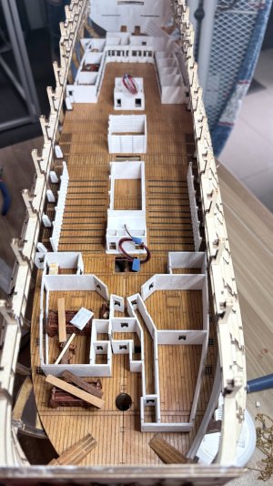

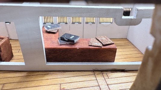

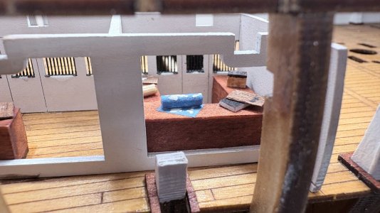

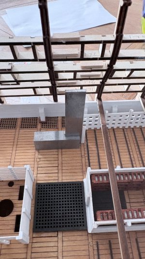

BEWARE! There is a mistake in the instruction video. The 'L' shaped desk you see above is incorrect the 'L' should be the other way around. It was a simple fix to flip the part over and add another top.

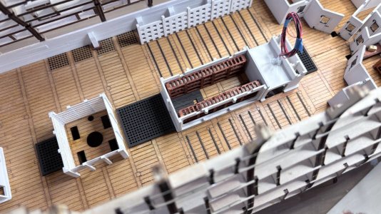

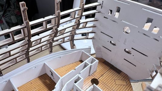

BEWARE AGAIN! There is another couple of errors in the instructions. To be fair the error is noted in the instruction video comments.

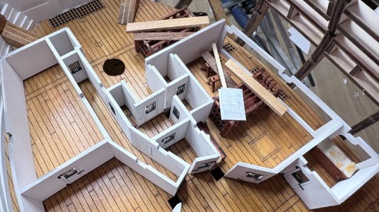

WS9; it should be WS4
WV3; it should be WS8

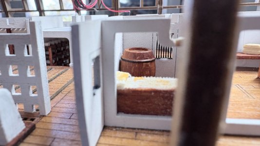

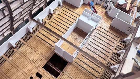

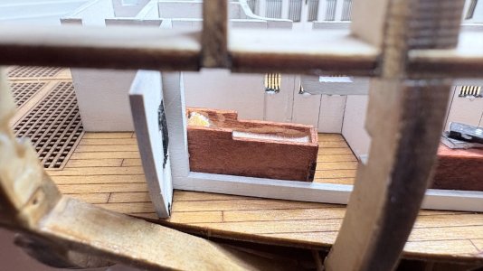

The staining on the beds is mostly done with cold coffee.

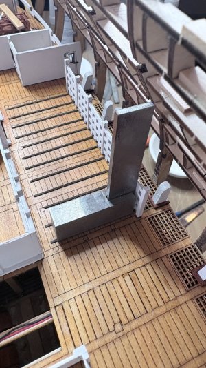

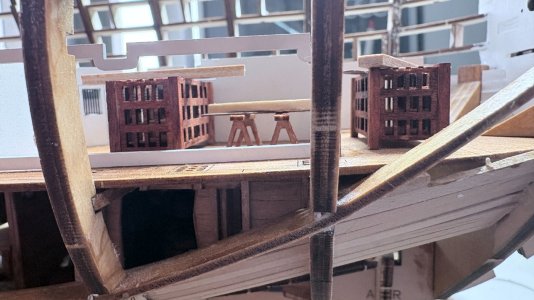

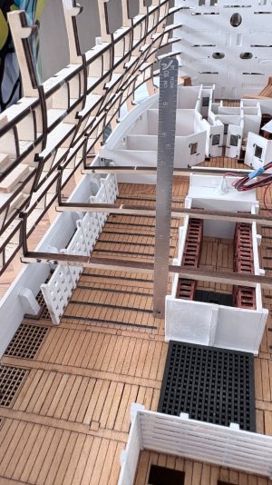

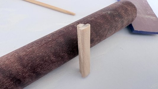

Here is one of the errors in the instructions which I did not pick up on. The 6 vertical spars should have been square in shape not flat.

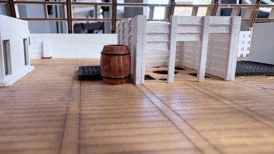

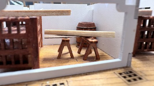

Cutting the powder cartridges with my little chopper!

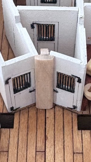

I painted the ends using an acrylic paint pen.

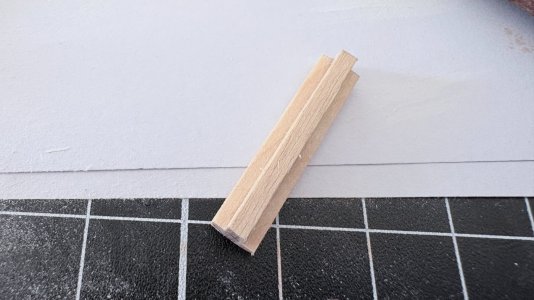

Gluing these parts in place was quite challenging.
