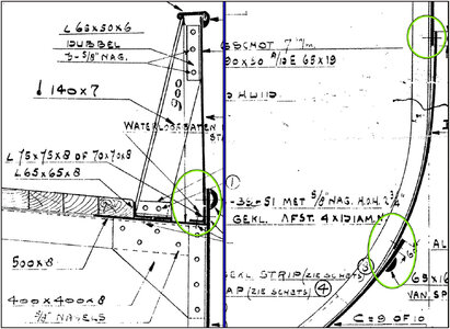

Some starting points based on the old drawings:
Oval left drawing: the top of the top plate protrudes a bit above the standing flange of the outer corner profile of the deck. The bulwark plate falls within the top edge of that plate and comes to rest on the standing flange.
Oval right drawing: the 2nd plate is placed over the bottom of the 1st plate and riveted. The same with the 3rd, which falls over the bottom of the 2nd plate. They worked with the plating from top till bottom.
