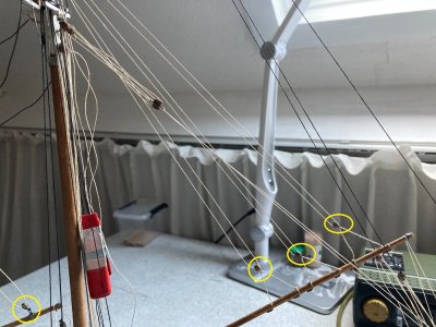

Hey Henk, I think we have/had a fellowmember who was mentioning internally stopped blocks. Since our Bluenoses have block sizes, ranging from approximately 2,5mm to 6mm, I didn't even bother. Way too small for my sausage resembling appendages, sometimes being referred to as fingers, plus I think one should be a watchmaker to accomplish selfmade internally stropped blocks.
Here is my 50 cent solution to post #270
The rigging is back on course

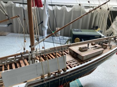

Masts are loose and standing rigging is definitely fastened and a lot of attention has been paid to making sure they are in the right position and can still be finally adjusted
Booms and gaffs are in place

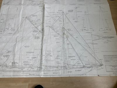

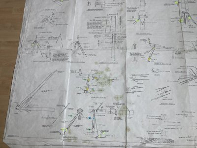

Because I let go of YuanQing's plans, I followed the Lankford plans (but without sails)
Because the drawings are based on sails, it took me quite some time to understand these plans, and which blocks apply there and which do not, to show them under sails
Other plans, other changes and other insights, I removed all 3 mm blocks that were used and replaced them with 4, 4.5 and 5 mm
For the tackles for the main mast among other things I kept 3 mm I thought about the order in which I am going to attach the rigging
, I left a littlebit to get the line tight

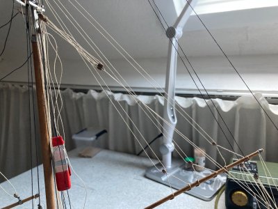

Today I had support from Peter Voogt
Thanks for this Peter
I have just applied the solution you suggested, and with comparison from the earlier photos I sent you, you can see that this is now a considerable improvement.
The lines are all still loose and not yet definitively attached.
This gives a good starting position to continue on this path.
For those who are not familiar with the Lankford plans, here is an impression.

I was pleased to help you with some advice, Henk. And it is clear that you are on the right track.
Think about the ‘sheer pole’ on top of the upper deadeyes. That rod helps your to keep those upper deadeyes in the right position:
Hey Henk,
Good to see you're working your way through the rigging. All those ropes and blocks are overwhelming, confusing ánd complicated. Very wise to take your time to understand what you're dealing with and to seek expert advice when needed.
Johan
Added the ''sheer line'' to my 'memory'.:)
I used the map in the picture as a second reference point.
Then I can tighten the lines between the blocks to determine the horizontal position of the ''sheer line''.
In line terms, so to speak.
We are on the same line.;)
