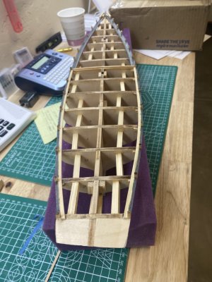

As you can see, after the bulkheads were glued into place and the glue dried, I reinforced the bulkheads with strips of wood to prevent flexure. I was afraid the bulkheads would snap off when I was fairing the hull. These strips provided a lot more structural rigidity and i recommend them. I measured the space between each bulkhead to cut the strips. The space seldom varied more than 1mm at most between one set and the other and were almost always the same port of starboard. This gave me a lot of confidence that the bulkheads were set correctly.
The bulkheads were then faired using long sanding strips I made by using pieces of foam board glued to sandpaper using rubber cement. I find these boat boards have some "give" and make sanding easier. When the sandpaper is used up it is an easy matter to take it off and replace it with a new piece.

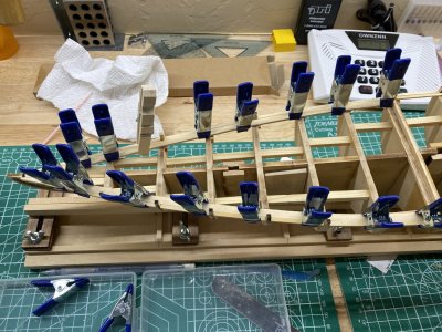

Now onto the waterways. The Bluenose waterways are really divided into two parts. On the foredeck it consists of three planks. The outer planks between the stanchions of the bulkheads, a plank next to that on the onside and a final inner plank that tapers to the level of the decking. The quarterdeck has a single plank that goes between the stanchions and interior to that is a plank that the deck will be nibbed (notched) on to.
The instructions would have you cut a series of planks between the stanchions and glue them from the "shelf" of the bulkhead that was created when you thinned the stanchion to 1/8th" on to the next stanchion. That's a bit difficult to do. What I did was to place the strips that go inside the stanchions and rest on the bulkheads. I then glued small pieces of scrap under those planks to act as shelves to support the outer strips.
Once these support pieces were placed it was easy to glue short pieces between the stanchions and to the inner strip.
Then third innermost strip was then tapered and attached.
Once that was done, the outer strip was lightly sanded to "curve" the outer strips and make them seem more like one continuous piece.

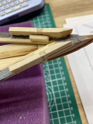

I then installed the knighthood hawse timbers and chafing blocks that go in the bow of the ship where the bowsprit enters. These are just 3 pieces of timber that i shaped and glued into place.
I then painted the waterways gray. When I paint I first use sanding sealer on the wood to prevent the acrylic paints from raising the grain of the wood. I then put a few coats of gray on the waterways. The frame of the ship is looking nice and straight and ready to be planked.
