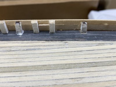

I next installed the foredeck bulwarks. While i could not find the width of the board stated anywhere, by looking at the plans it says it is twice the with of the hull planking boards or 3/16 x 1/16" I fitted pieces of the 3/16 x 1/16" stock from the "step" between the foredeck and quarterdeck and glued them along the bulkhead stanchions and the top of the uppermost hull strake, The fit is not perfect but it is close. A bit of filler and some sanding should blend these in nicely.
I used bits of left over planking to help prevent the clamps from leaving pressure marks on the wood.

I started to for the stanchions in place. They are made from1/8 x 1/8" strip. You should be aware that the stanchions of the foredeck are slightly taller than the stanchions of the quarterdeck so plan accordingly. (don't ask me how I found this out!) Doing some measurement I found there was a 7mm (note the metric) space between each stanchion. When fabricating them (at least the longer ones) I sanded the strip and painted other the white that will be on the bulwarks before I cut them to length. I made a 7 mm spacer and used it to space the stanchions as I glue them into place.
