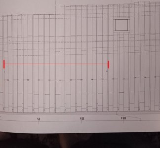

The first major decision was the room/spacing of the frames:
1. 10 frame/spaces were measured (red line below) at 4.56 inches OR .456 inches/1 frame
2. 3 frames were measured and averaged at .386 inches
3. 3 spaces were measured and averaged at .070 inches
4. 3.86 + .070 = .456 inches. This agrees with the 10-frame average!!!
5. This results in full scale frame thickness of 18.53" and space of 3.36"

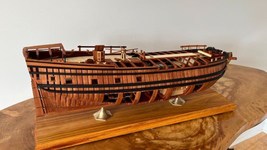

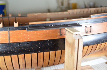

This seemed a very big "frame" to "space" ratio, but it agrees with the Boudriot plans, as well as two superb models that I will continue to reference as I work this scratch build:
1. Alexandru Gurau's model of Salamandre:
2. From the SOS forum, "Jimmy's" incredible build log of Salamandre:

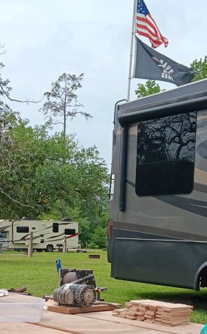

The 40-year-old "Preac" Thickness sander took sixty 0.25" thick planks to 0.193 inches (i.e.: a half frame thick). The Preac worked like a champ!

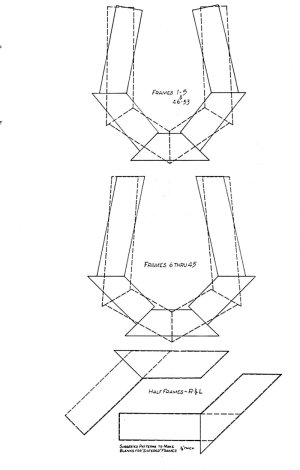

These will be glued together, to build frame blanks using the Hahn method (see photo below). Each frame will then be traced on the blanks, cut out with a jig saw and sanded using an oscillating drum sander.
The benefit is ***NO SANDING CHAR*** like kit builds, plus the joints are super tight:cool: :cool: :cool:!!!

Hi - as a matter of interest how do you measure 0.193 of an inch - presumably with a vernier calliper and if so how do you get the consistency of measurement across the stock?
Y T was spot on. Here is a picture of a "board" being fed into the Preac Thickness sander.
Note how flat/level the bottom plate is. Adjusting the knob on the bottom a 1/4 turn is about 1/1000 of an inch with a fine grain sanding drum.
There are locking screws on the outside of the plate so it does not vibrate and slowly turn the knob. A great tool for "making" dimensional scale lumber!!

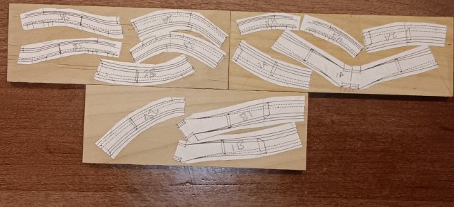

First test frame is complete...see photos below. I'm happy with the result...NO CHAR TO REMOVE and tight joints:cool:!
Mistake/Question: How do I remove the paper templates?? What should I use to adhere the paper templates??
I used wood glue to adhere them to my nicely sanded frame faces! Sick Any recommendations greatly appreciated. My first inclination is water and a razor blade??? I'm not sure it will ever accept oil/stain well though???
I use best-test paper cement. I tried the Elmer’s like Paul uses but couldn’t handle the smell.
Like Elmer’s, it just rubs right off. Sometimes i use an art eraser to rub the paper off if my fingers get sore.
I'll give it a try. Thanks, Oliver!
