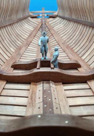

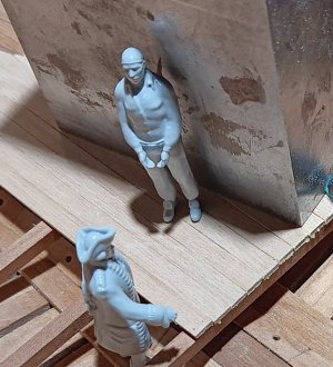

The figures give scale and perspective to the photos, so I bought 5 different poses. Future pictures should have some variety, if I can get the poses to work.

Stained the two thick stuff planks, as well as the Limber strakes. It's still damp and will "mellow" over the next few days.
The Superintendent and PO Brutis test fit the risers and are pleased with the fit.

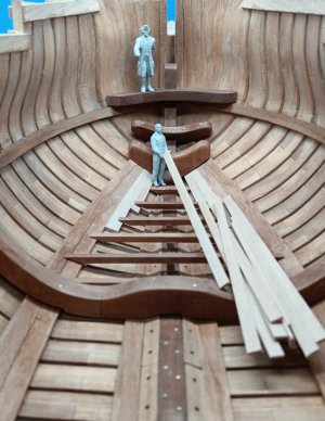

1. The final two bow hooks were stained, then each got four square bolts installed and finally they were permanently glued in place.
2. PO Brutis cut and staged several lengths of planking. He is pondering how to plank the deck, still show the structure below, and finally, where to place an access hatch to the area below this deck (no hatch isshown in Boudroits drawings, that I can find).

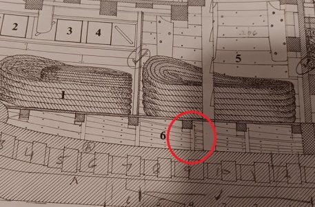

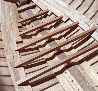

3. Midship supports for the longer deck beams were added. PO Brutis didn't like the small but eloquent supports in the drawing (photo 1 red circle). Instead, he opted for beefier supports (photo 2).
